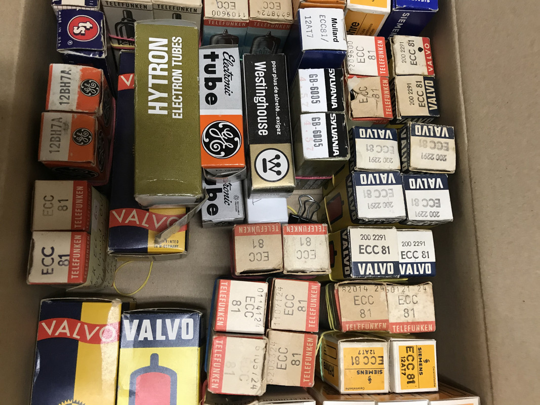

Inexpensive TUBE set for TU-8800
I have a lot of Volvo, Telefunken, Mulard, Siemens 12AT7 / ECC81 in stock..
if you are interested,please let me know
