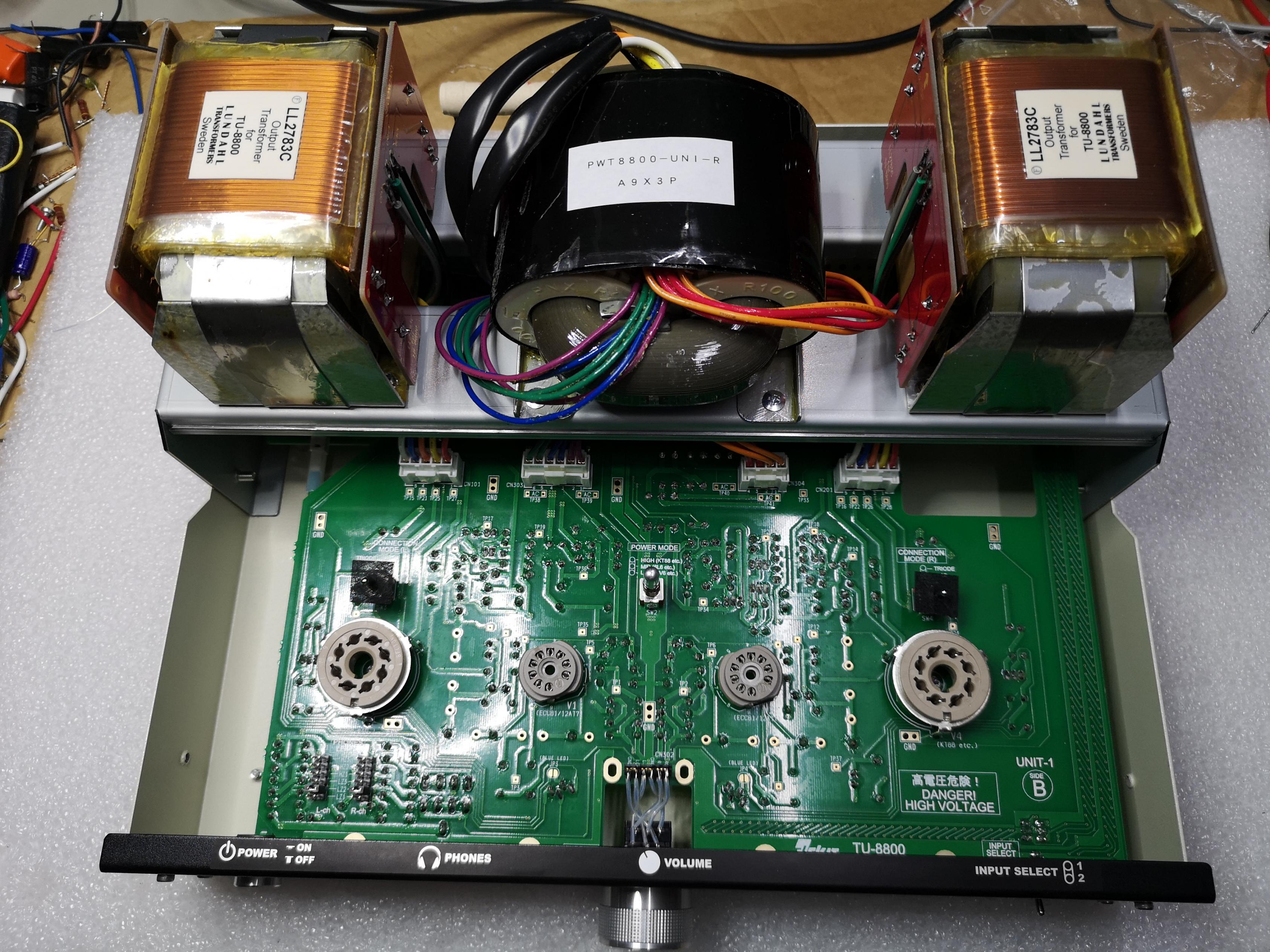

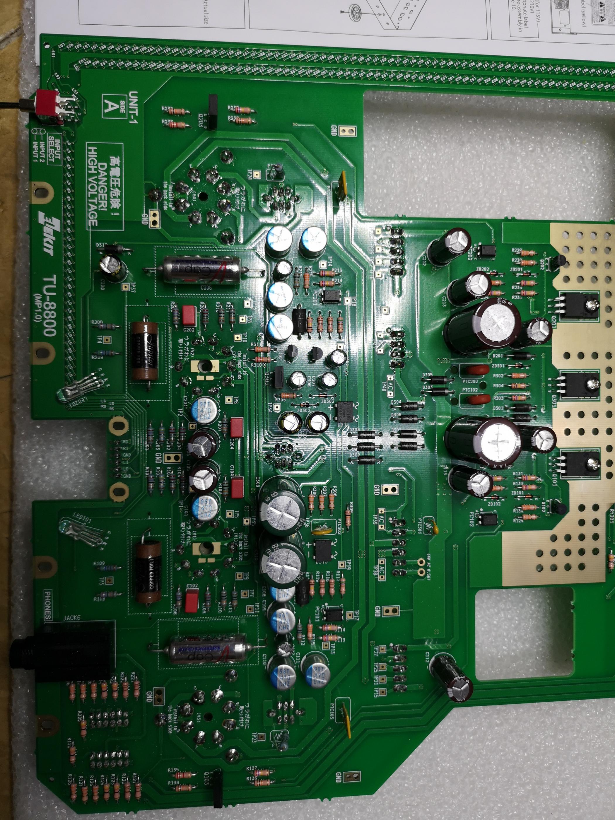

Victor, may I ask you to work with Elekit to address a couple of serviceability issues?
Looks like TU8800 shares similar structure and layout as TU8600, which is not good news IMO since it is PITA to change/service once it's built.
Just to change out coupling caps, I had to dissemble essentially the entire amp including the transformer mounts and whole circuit board since most parts (including coupling caps) are mounted on bottom of the board with no bottom panel on amp to access them.
In addition, if the amp develops problems, it is very difficult to troubleshoot since the transformers sit on top of board and get in the way of board access if one needs the amp to be turned on to troubleshoot.
I was hoping Elekit would rectify these issues with future kits:
1. Provide bottom panel access.
2. Perhaps lengthen the wires connecting transformers to the main board so that the amp can be turned on with transformers pushed out of the way for serviceability.
Thank you.

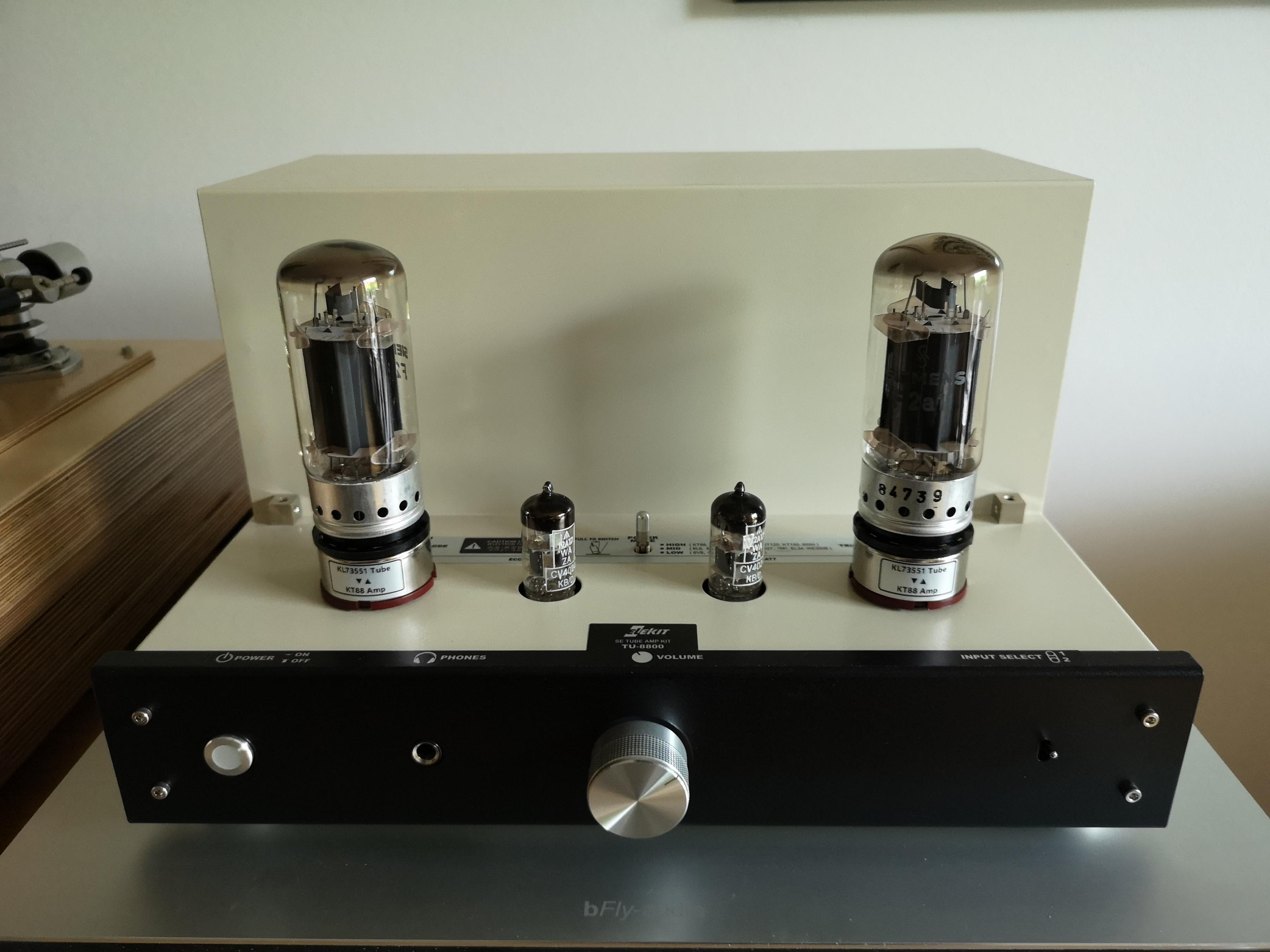

James 'S tu-8800
It was a delight to build. I really like the instruction manual. It reminded me of when I use to build Gundam models; everything was very organized and exact. Also how the amp was organized was impressive, like how the screws go into the tube socket. I really loved that part.
The sound is exceptional. Very clear and excellent soundstage. Great bass. I tried both modes but I prefer Triode mode more. I felt the UL was too bright for my taste. So far so good. I can't wait for Lundahl. This amp is amazing! Thank you again.

Upgrades
Yes, I bought the kit including the Lundahls from a dealer in the Netherlands.
Upgraded the coupling caps to Jupiter Jupiter Copper Foil Paper & Wax (0,01µ) and V-Cap ODAM (0,1uf).
Volume pot is a TKD 2CP-601 which I prefer to the 2CP-2500 series from the sonic point of view.
Resistors in position R101 .. 112 and R201 .. 212 have been replaced with Takman Metal Films.
Also PTC101 and 201 have been replaced with Takman Metal Films. I don't like non-linear resistors in that position!
As I don't need much power with my Lowther TP1s my standard set of output tubes is a pair of Mullard 6V6G from the 1940s.
The input and driver stages are using a pair of Mullard CV4024 with "goal" getter support.
I find my TU-8800 very resolving, tonally accurate and yet musically satisfactory.
