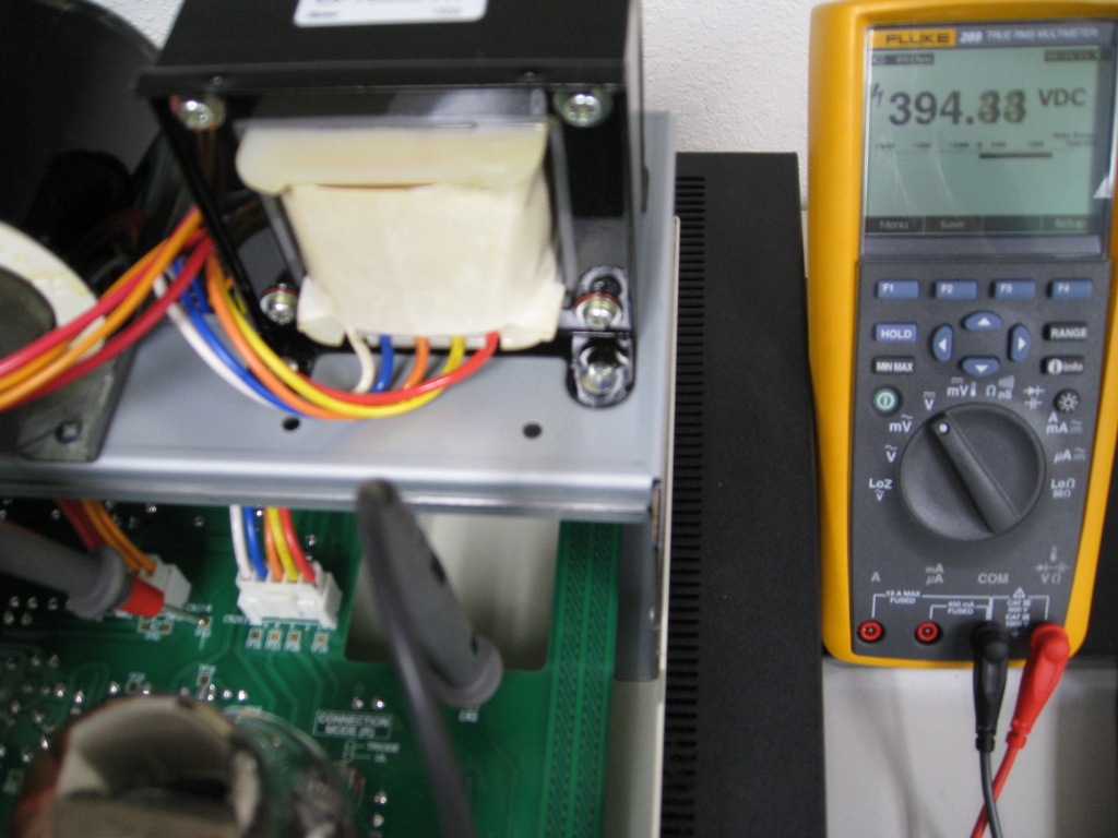

Per your request vkung, I have take all TP voltage measurements in both normal operation, and with the amp's ripple filter shut down. I also took an AC millivolt reading at the output tube plates which showed 37mv in normal operation. Any help you can provide would be greatly appreciated.
Normal operation (green LED) All readings taken with a calibrated Fluke 289 DVM.
TP1 2.75 TP11 -32.1 TP21 5.24 TP31 389 - 390
TP2 2.71 TP12 -31.2 TP22 5.25 TP32 391
TP3 1.47 TP13 -32.2 TP23 360.2 TP33 391
TP4 1.44 TP14 -31.2 TP24 360.1 TP34 -70.8
TP5 149 TP15 4.41 TP25 360.5 TP35 6.61
TP6 147 TP16 4.42 TP26 360.6 TP36 7.33
TP7 120 TP17 -54.9 TP27 377.0 TP37 7.05
TP8 121 TP18 -54.9 TP28 377.0 TP38 6.71
TP9 270 TP19 3.27 TP29 11.1 - 12.5 TP39 26.4
TP10 270 TP20 3.27 TP30 11.0 - 12.5 TP40 236.8
TP41 69.8

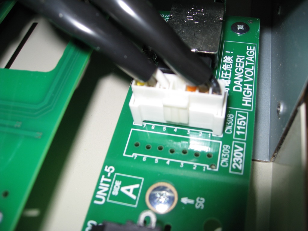

I have a feeling you are using the 100V power PCB board. There are 2 boards inside the BOX. You should use the 115V PCB Board

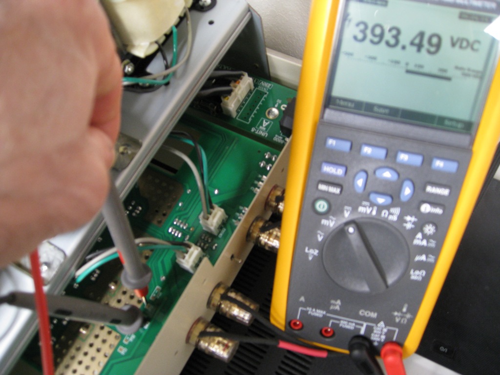

For PT 31 you have 389V.. It is impossible.

I am using the 115 volt power connector board. While waiting for a pair of Tekton Lore, I am using Spendor LS3/5A 11 ohm. They are only 82db efficient, which is why I am running the amp close to 10 watts.
Those voltages are indeed too high and likely the reason for hum through speakers and ripple filter shutdown. I included readings with the amp in ripple filter shutdown just to be thorough. Also attached are images showing TP 31, 32 & 33 being measured in normal operating condition.
