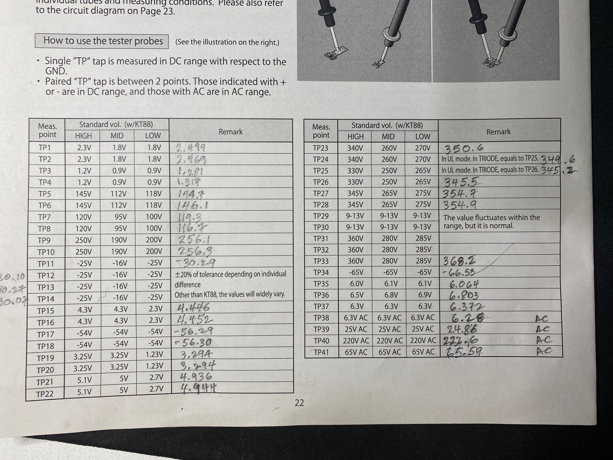

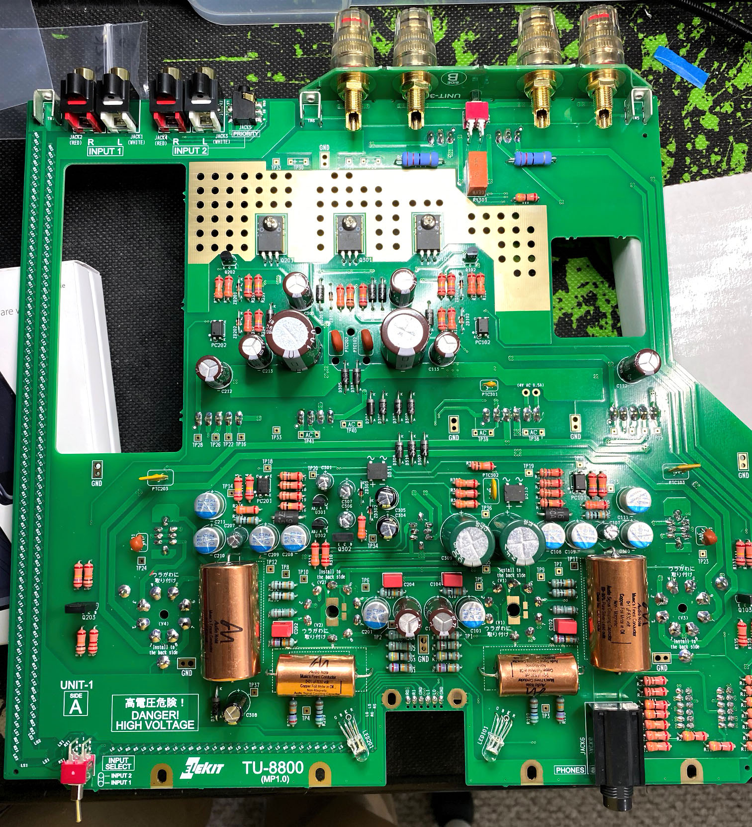

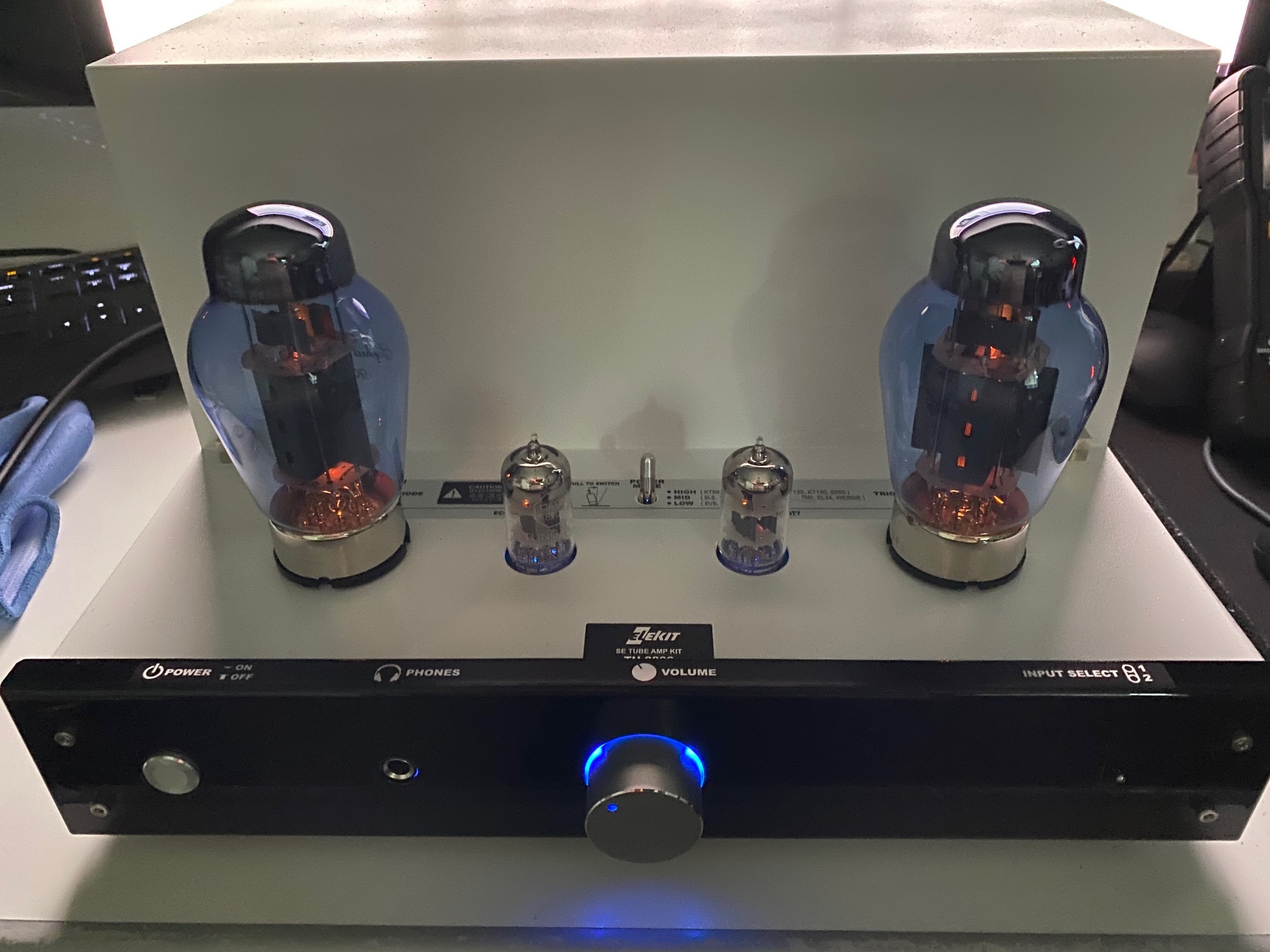

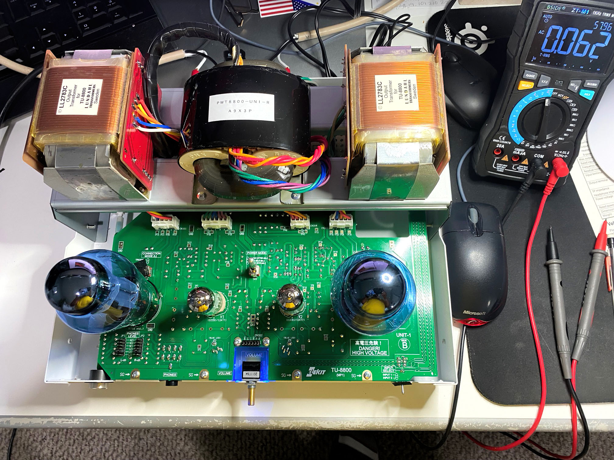

I completed my Elekit TU-8800 with match pair Sofia Electric KT88, Tung-Sol 12AT7 and Audio Note coupling caps. I measured voltages is a little bit higher as stated in the manual. So far I'm impressed with the sound compared to my old Elekit TU-8200R this is a keeper 🙂
