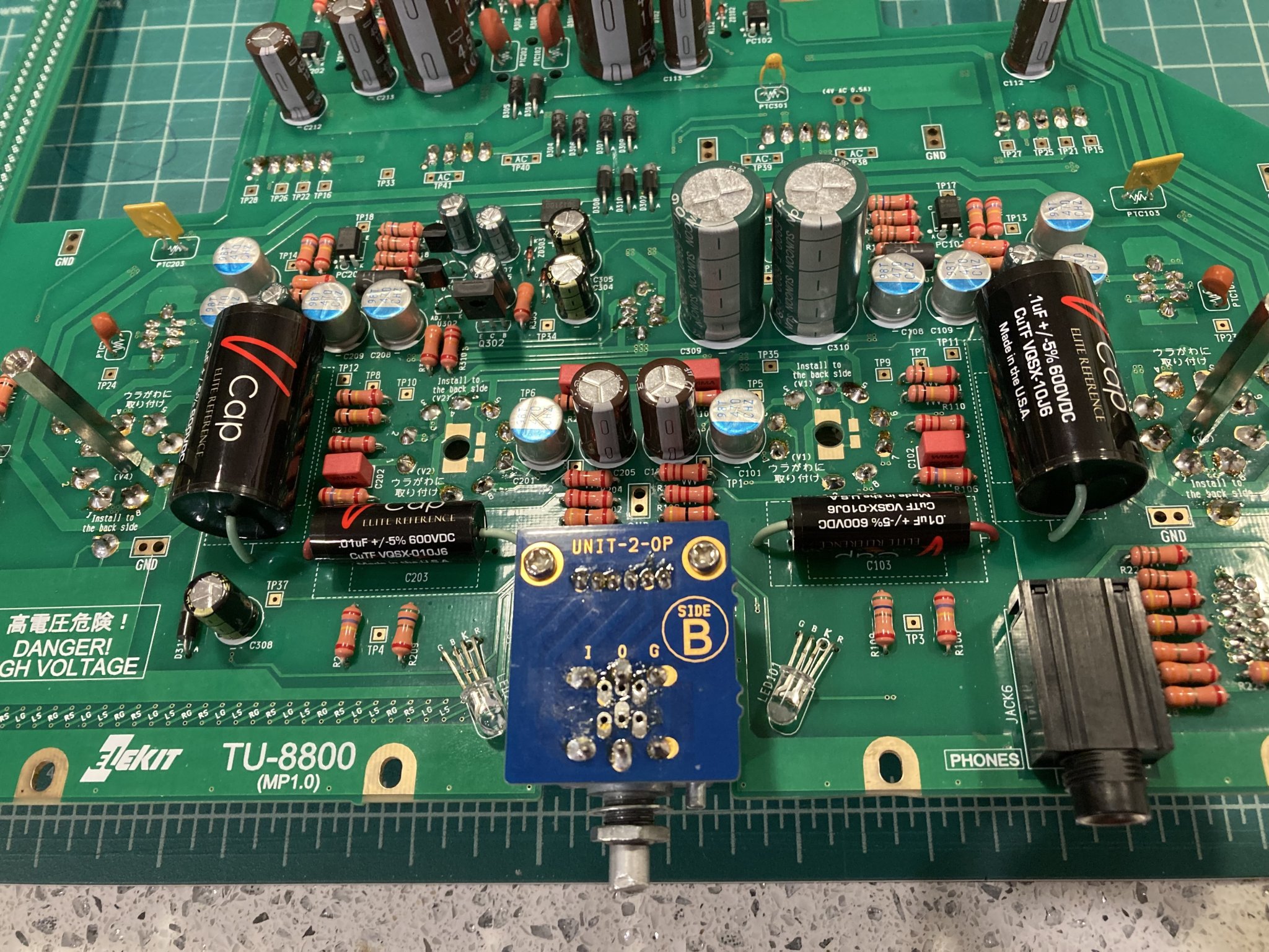

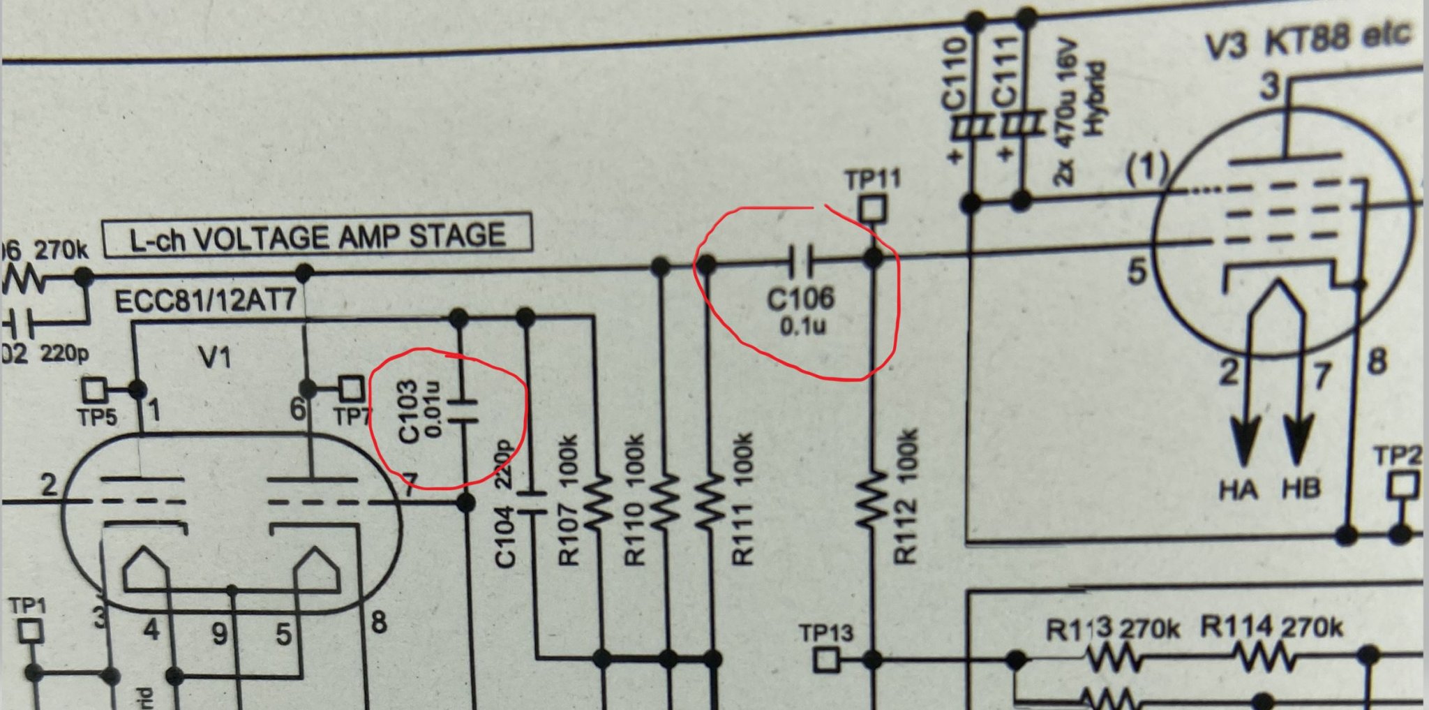

Can anyone help me with the orientation of coupling caps C103(.01mf) C106(.1mf) looking at the schematic of Elekit TU-8800 V1-12AT7 Pin 1 and 6 plate is the outer foil of the coupling caps is that correct? I just wanna confirm my orientation of this caps if I installed it correctly. Any help is greatly appreciated.

Hey I’m trying to figure this out as well. Did you ever find a definitive answer? Any pictures you can post would be greatly appreciated.Can anyone help me with the orientation of coupling caps C103(.01mf) C106(.1mf) looking at the schematic of Elekit TU-8800 V1-12AT7 Pin 1 and 6 plate is the outer foil of the coupling caps is that correct? I just wanna confirm my orientation of this caps if I installed it correctly. Any help is greatly appreciated.
