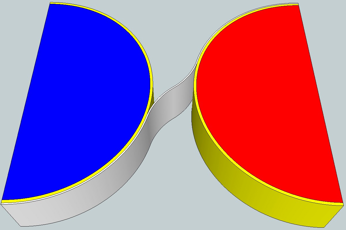

OK, I've had a bit of time to think on servoless centering
for the half baked wave motion version.... My suggestion
about tapering the electrical width of the stators maybe
varies the impedance and/or motor strength, but I don't
see how it looks or act much like a mechanical spring.
Got a new half baked idea: Supposin we were to curve both
stator surfaces slightly? So's gap in between is shortest near
the middle of the device. Now the length of a crossing peel
varies with the displacement, and subtracts from the overall
capacitance stuck to the stators, causing both physical and
electrical tensions to rise. Stator capacitance becoming our
spring we were needing?
Hmmm, yah, maybe.

I figure since stuck ribbon appears always equidistant from both stators,
Ribbon Voltage should be exactly half whatever you set up for the field???
Drive Coulombs in or out, ribbon moves to keep the Voltage from changing.
How then does a static charge transfer???
Voltage doesn't rise or fall in either capacitor till you hit either XMAX and/or
the the ribbon is heavily air loaded and can't move. Unless we do the curved
stator thing, then maybe a little arises from rising tension??? Not really sure.
That IS the whole reason the ribbon moves. Keep the voltage from changing.
Cause if Volts did change (one cap temporarily stronger than the other) that
would pull the ribbon to find a new center where Voltage is again in balance???
If the voltage in both caps are equal, the tension per surface area is equal,
the tension under each (identical shaped?) meniscus is equal??? The position
of the ribbon to maintain that balance is what slides back and forth!
Or so the theory...
I'm figuring one stator might be covered in dielectric, and then the far side
of the ribbon covered the same. I have Kapton tape and aluminum foil on
hand... There is no reason we can't cover both stators and let the foil be
just a bare foil, cept that doesn't seem mechanically too strong? Or is a
bare foil a lot stronger than I think?

Maybe a picture would help?
I dunno that both dielectrics would be stationary as drawn..
If it makes the ribbon stronger to face one side and leave
that side's stator bare instead??? Again, I got Kapton tape,
so my thinking is biased by materials on hand...
I also sort of doubt the needed curves would be quite so
pronounced. Was just easier for me to draw big circles...

This seems to lead naturally back to one of the central questions from the start in this thread, which has been, "What happens when the external load is increased by confining the air to a thin slot that has just one of its narrow edges communicating with the open air?"
Well, at a minimum, it should be clear that the membrane will be facing a higher load impedance. Compared to the open air case, the air mass and therefore the impedance will be multiplied by at least the ratio of depth to width of the slot, so it will take that many times more force to create the same amount of motion. There is only the same amount of force available, though, so the air will be moved by not more than the inverse of this ratio. The fact that each pair of slot walls are moving in opposition to one another will further increase the impedance, by at least a factor of two, cutting the movement by another factor of two.
Based on that, here is what I think is the best scenario situation for the case of pleats that have a 5:1 depth to width ratio:
The membrane area within each pleat is 10x what it would be if a planar membrane were just the width of the open edge of the slot.
As discussed above, the load is at least 10x what it would be if the pleats were unfolded.
At best, the amount of sound is thus equal to what it would be from a planar membrane that is just the width of the open edges of the slots. The cost of increasing the membrane area by 10x is to increase the capacitance and thereby the electrical load by 10x, with no increase in SPL.
In fact, I think this simplified analysis is optimistic by a considerable factor. It neglects air viscosity effects. These will necessarily occur, because the slots are too narrow to propagate waves at audio frequencies, so the air must be literally pumped in and out of the slots. The velocity of the air in a slot must thus increase by 10x relative to the open air case. The viscous resistance of gases increases as the cube of the velocity, so that while it may not start out as much in the open air case, whatever that is will be multiplied by 1000, and it is not inconceivable that this will then be something significant. There will also be surface drag and edge turbulence effects that further attenuate membrane motion.

Few: Your drawing was helpful. I'm sure I'm not the only one who'd be fascinated by the result if you fabricate a bare bones model. Strikes me that you could start with plastic wrap from the kitchen for the membrane, bare sheet metal or a couple of lengths of pipe for the stators, and DC from a multiplier to coax motion from the transverse bit. The scale is not really important at this point. You might have an exciting moment in store.
1) I am not Few. And I am sure he would be equally relieved to hear it...
2) How should this plastic wrap be made conductive??? It must bridge the halves of the cap.
Helpful suggestions on the merits of various conductive films here:
I would try it first with no conductive coating. It may be that simply increasing the voltage on one stator and decreasing it on the other will create motion. Worth a try, I think.
You could get sufficient conductivity for the purpose from dilute dish soap -- wipe a bit of it on and let it dry. (Some DIY ESL people use this as a membrane coating, but I would not recommend it for the long term.)

I think my brain was twisted before this all started.Few, Your idea is a real brain twister
Key (embarrassingly simple) point I was missing: The diaphragm must have mass in order to create sound if the diaphragm is moving only as a result of its own inertia. If it's constantly driven by some force, then my concern about a massless diaphragm having zero kinetic energy is baseless. Speaker diaphragms are always driven by a force. I was too distracted by images of those executive desk toys with the suspended ball bearings that smack into each other and demonstrate the importance of conservation of energy and momentum. Not pertinent.
