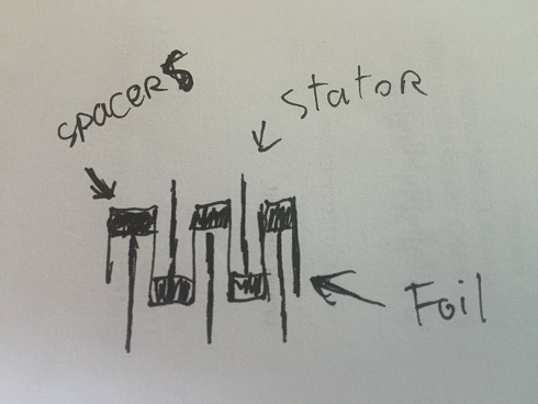

hmmm i was thinking about this setup, again for the 100000 time. and i see one flaw. correct me if im wrong but using normal esl panels wont get you what you want i believe.
in my opinion the stators need to be closed ? i mean the foil is already acoustical transparent. if the stators are as well, we get allot of out of phase issues ?
should be easy to make and test. i just slit 10 stators from pcb, add spacers to one side. cnc bottom and top plate with slits where the stators can sit in.
coat some mylar with licron, and zigzag the foil between the stator and clamp it at both ends.
, no need to reverse polarisation. since if you did all membrames would move in phase to eachother wich then does not result in the pump function the amt s have.
