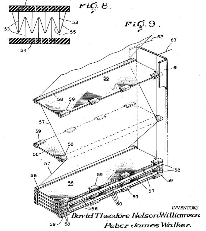

It seems I missed the discussion about this Russian built solid stator AMT. Figures 8 & 9 from the Williamson/Walker patent show the construction of diagonal pleat AMT with Solid stators. Perhaps their construction was similar?
Hello Nevod,
I have been hoping for more specifics on the Russian design, myself. Nevod -- can you steer us to the details?
For those to whom it is not evident, the pleat angles shown in Williamson's Fig. 8 and the upper part of Fig. 9 are to clarify what goes where, and the lower part of Fig. 9 is supposed to represent a workable embodiment. In an ES-driven AMT, as with any ES transducer, the membrane(s) must be substantially parallel to the stator(s).
bolserst
The diagonal design was deemed to be too hard to construct, either with one long piece of film, or with separate films for each pleat.
The design which seems to be relatively easy to make is modular and parallel.
