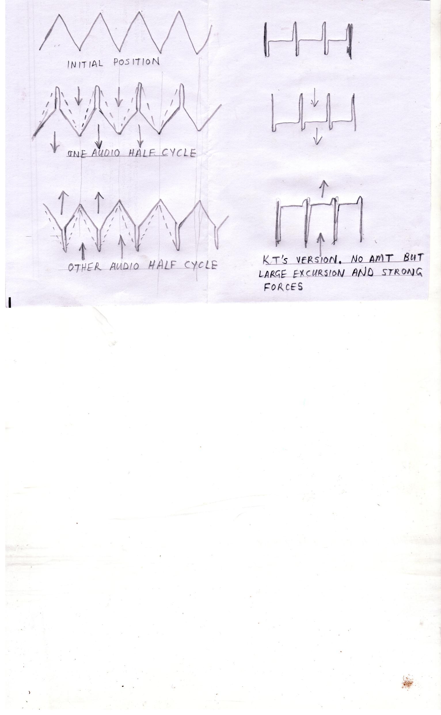

Very good thinking Kenpeter. If I understand you correctly you are alluding to something I had thought of in a half baked way. A drawing would be very usefull here. For purposes of explanation the "pleat" could look like a capital H. Maybe the vertical parts are rigid stators with a very floppy membrane running diagonally across the opening. When the horizontal element of the H is in the centre this position is created by the lower part of the membrane "sticking" to one stator and the upper part to the other. Thus we are exploiting something that Electrostatics is good at--generating force with small spacings. We also consign membrane tension to the rubbish bin.
This idea needs a lot of thinking about as the motion is quite unlike that encountered in 99% of transducers. David mentioned adverse effects of zig zag pleats in an EM AMT. I could be wrong, but tend to view the pleats as having a rigid part (The conductive foil) and a floppy part (The folds). Perhaps, under drive, the folds alternately "balloon" out and pull taught to preserve parallel pleat motion.
Keith PS Borat, I have to disagree with your aversion to pleats. Ignoring motor means, pleating confers advantages in getting an improved impedance match to the air and can result in an acoustically smaller transducer with directivity benefits. Your idea would work well in an AMT!
kenpeter's idea
In the drawing I am attempting to explain kenpeter's idea. All aspects of practical realisation have been neglected. When we consider the crackling noises associated with unwinding sticky tape from a spool we may have a serious problem. I think kenpeter was envisioning a hand over of the sticking area from the bottom of the pleats to the top. This would defeat AMT motion and leave you with something like depicted on the right.
Keith

Kenpeter's traveling meniscus motor
Wow, Keith, very astute. I did not understand, until I saw your sketch.
What an interesting idea, kenpeter. Surely not one that lends itself to easy realization, but puts forth a quite intriguing motor mechanism. On the plus side, in its ideal form, it would apply the absolute maximum possible electrostatic force. I won't begin to list the challenges.
About the AMT impedance match, I feel I am repeating myself ad nauseam, but the membrane in an AMT experiences a higher impedance air load than in a planar. I believe this is disadvantageous when driving electrostatically, where the extra loading is likely to more than offset the increase in driven area. ESL's are already as well matched as possible to the air load.
Don't know that it could actually kink over hard 90 that way?
Was thinkin something halfway between pic on the left and
right. Or perhaps an S shape rolling down the middle of this
crazy audio railgun...
Course, any slack (obviously some is necessary) is gonna
crack like a whip if this rolling wave hits XMAX either end.
Picture crew of the Argo shouting in unison "Prepare to fire
the wave motion tweeter!"
