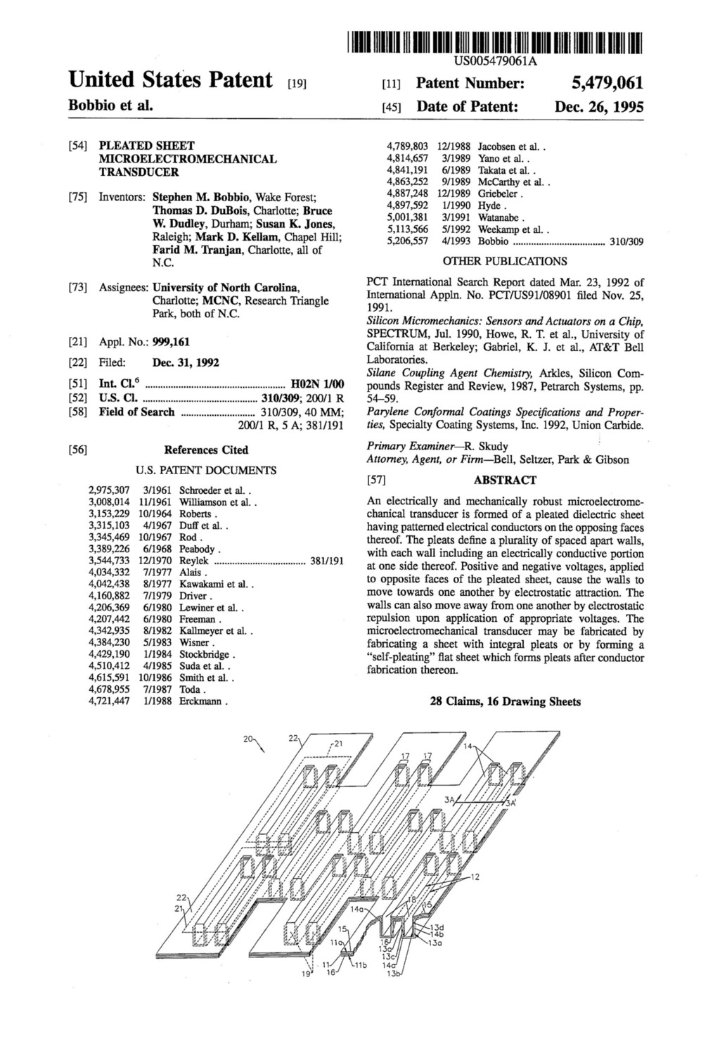

FWIW, here is an AMT patent from this decade, where the authors based their invention on 1) the benefits of using a horn to match an AMT's relatively high acoustical impedance to the open air, and 2) the benefits of finding ways of providing greater uniformity in the field and in the acoustic coupling. They cleverly designed a magnetic and support structure so that it integrates uniform and optimal load matching and simultaneously optimizes field uniformity.
They assigned it to Cerwin-Vega (may have been employees of the company), who obviously have a strong interest in efficient transducers. Have not seen a product, yet, although they had apparently a coaxial design on the market long before. Unfortunately, their figures do not include data from their research, but maybe they published a paper.
ES AMT US patent 5479061
Have you seen US5479061, Keith? Although this invention is meant for fabrication using microelectronics methods, and the scale must be pretty small, it does appear to teach a stator-less dielectric membrane ES AMT. Unfortunately, the pdf is much too big to upload, and it zips to an even bigger file for some reason.
Best route IMO is Patent US5479061
Attached the cover page extracted from the original pdf.

David,thanks for the patent links. Czerwinski has written a few AES papers but I did not realise they were into pleated diaphragms. There seems to have been a level of pent up interest at the time of the Heil patent expiry. Yes I had come across the micromachined transducer by searching US patents. Found it pretty hard to take in, but if you read between the lines the references to ES powering means and some kind of a similarity to a pleated structure becomes apparent. If patents are supposed to have a teaching function not certain what this one teaches. Maybe how to use a lot of words without giving too much away.
Keith
Keith
. . . what this one teaches. Maybe how to use a lot of words without giving too much away.

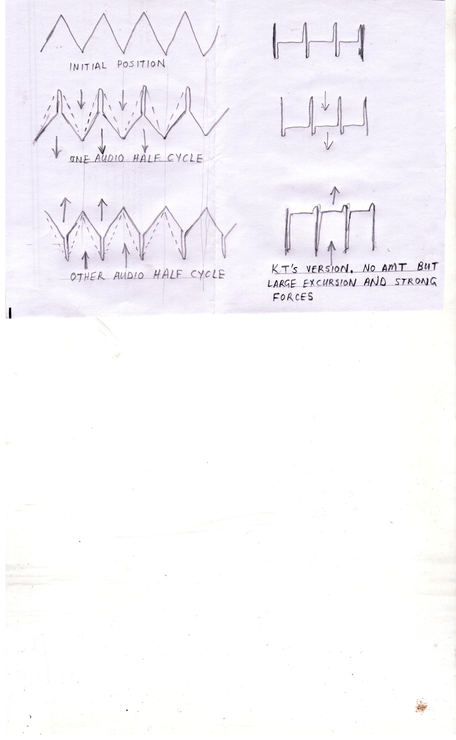

OK, I've had a bit of time to think on servoless centering
for the half baked wave motion version.... My suggestion
about tapering the electrical width of the stators maybe
varies the impedance and/or motor strength, but I don't
see how it looks or act much like a mechanical spring.
Got a new half baked idea: Supposin we were to curve both
stator surfaces slightly? So's gap inbetween is shortest near
the middle of the device. Now the length of a crossing peel
varies with the displacement, and subtracts from the overall
capacitance stuck to the stators, causing both physical and
electrical tensions to rise. Stator capacitance becoming our
spring we were needing?
- Planars & Exotics
- Electrostatic AMT?
