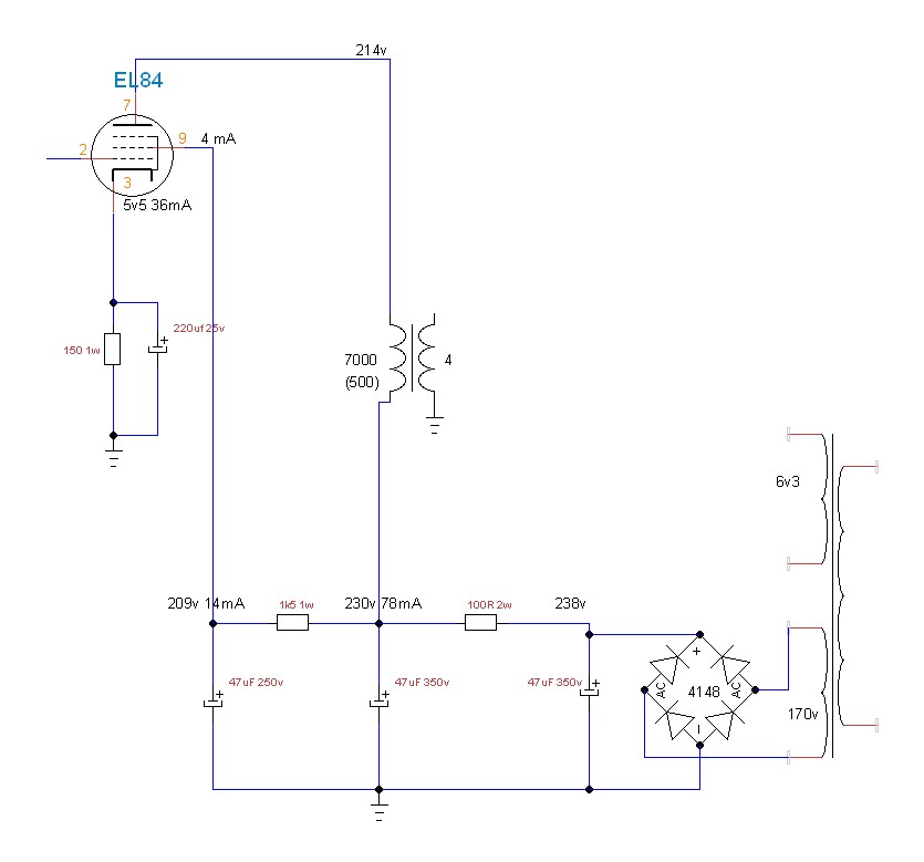

So i have 6.8v instead of 6v and 45 mA?

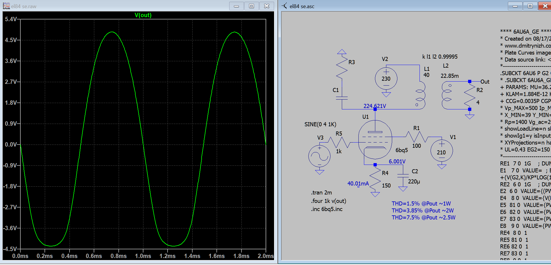

Your measurement of output stage is correct, but see the distortion level:
THD=1.5% @Pout ~1W
THD=3.85% @Pout ~2W
THD=7.5% @Pout ~2.5W
The bottom waveform is rounded quickly as you increase the input level hence distortion increased.

I believe the point Koonw is making is that the operating point generates a lot of distortion at low power. According to the tube sheets it is mostly 3rd harmonic which will not sound good.
The OP originally said the sound got bad at 1/4 turn on the volume pot. I showed how 1/4 turn could easily drive the amp to maximum output. Which would make it sound bad.
We do not have any information on the transformers so that could also be related.
Adding NFB will reduce the gain and improve the distortion.
Knowing the rms power output level when the amp sounds bad would help a lot in the analysis (maybe it is clipping). The small discrepancies on currents that you mention are not so important until we know if there really is a "problem".

According to the picture, the power transformer seems to be the small R-core 170V-130mA + 6.3V-5A 50VA low profile type from China. Hammond design guide suggest a 0.62 current derating when using a full wave bridge rectifier with capacitor input, this means that maximum DC recomended current draw is roughly 130 x 0.62 = 80 mA. The filament winding is not fully loaded, so maybe we can get away with 100 mA, but the transformer is right at the edge, and unable to supply at least 250V to bias the EL84 tube at the best working point. A voltage doubler with small capacitors and a big choke will give 300V at 40 mA on the PSUD simulation; that's enough for a single channel only, I believe.
I think it could be the clipping... from what pcan says, it would also be explainable ... I could reduce the current by following more closely the design of the Armstrong Stereo 55 which has 36 mA total and 5.5v on the cathode, with 150R resistor ... in this so I should be within the parameters that pcan gave me very kindly and have Less THD accordingly ...

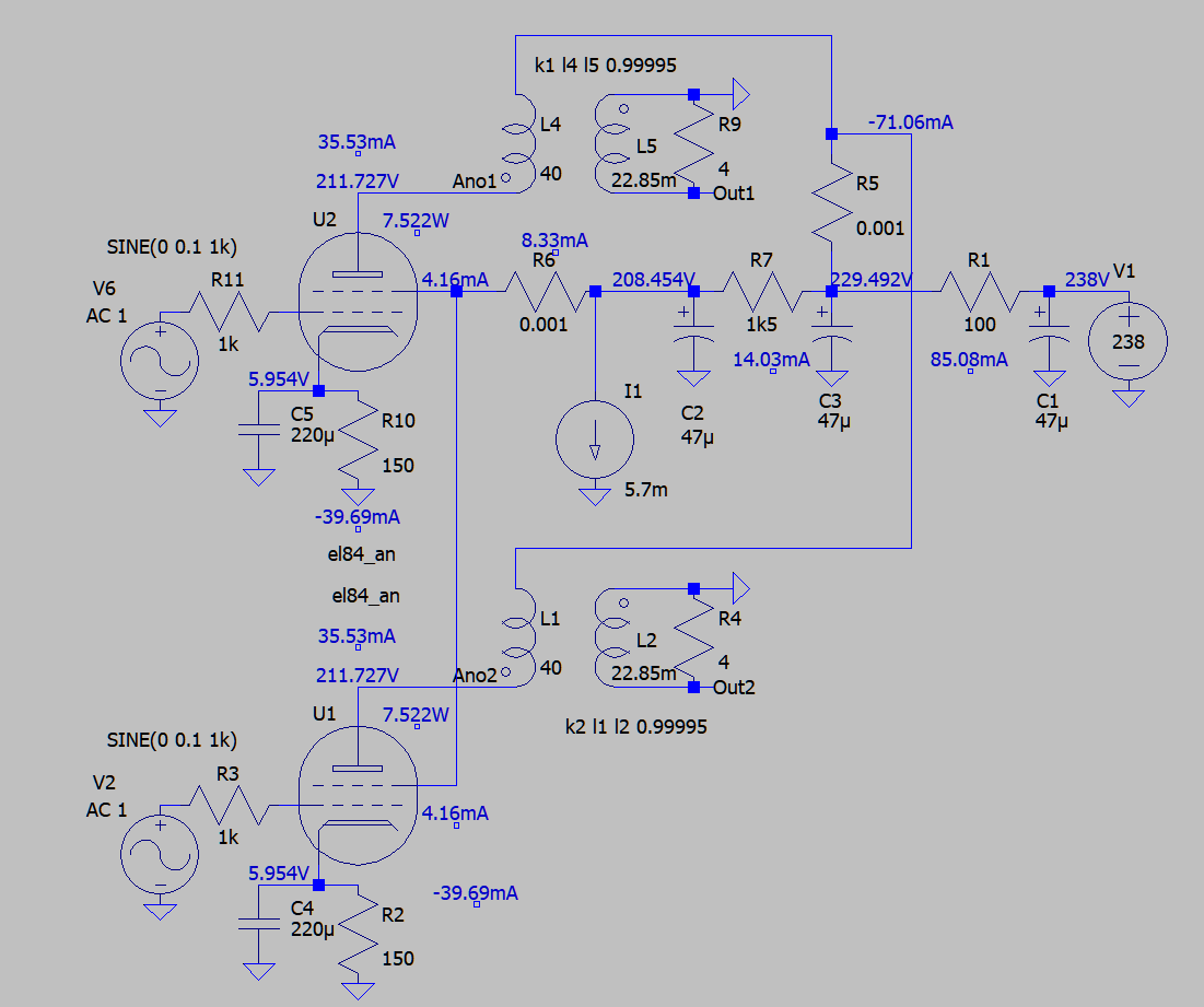

oh that is i used DCR 150 Ohms so less voltage drop, maybe it's 550 Ohms, can measure it? If you're interested in more sim just give a shout.
About the earlier sim, the rounding or clipping of bottom waveform is due HT is too low, need to increase (say 300V?) so moving it out of bottom clipping. Of course raising HT increased dissipation, but you can reduce the screen voltage to lower it. Together without cathode bypass you can get about 3W with < 2% distortion and reduced gain more with Gnfb. Read: The Valve Wizard -Single Ended feel free to raise any doubt.
For EL84, to be on safe side, total HT swing should not be greater than 550V

Well, I think the best thing to do now is to reduce the screen voltage so that the total dissipation is about 5W, doing this the reduce current (~25mA) that is less taxing on PSU, but 2W of cleaner output. It's 140V for screen voltage in my sim to achieve that.

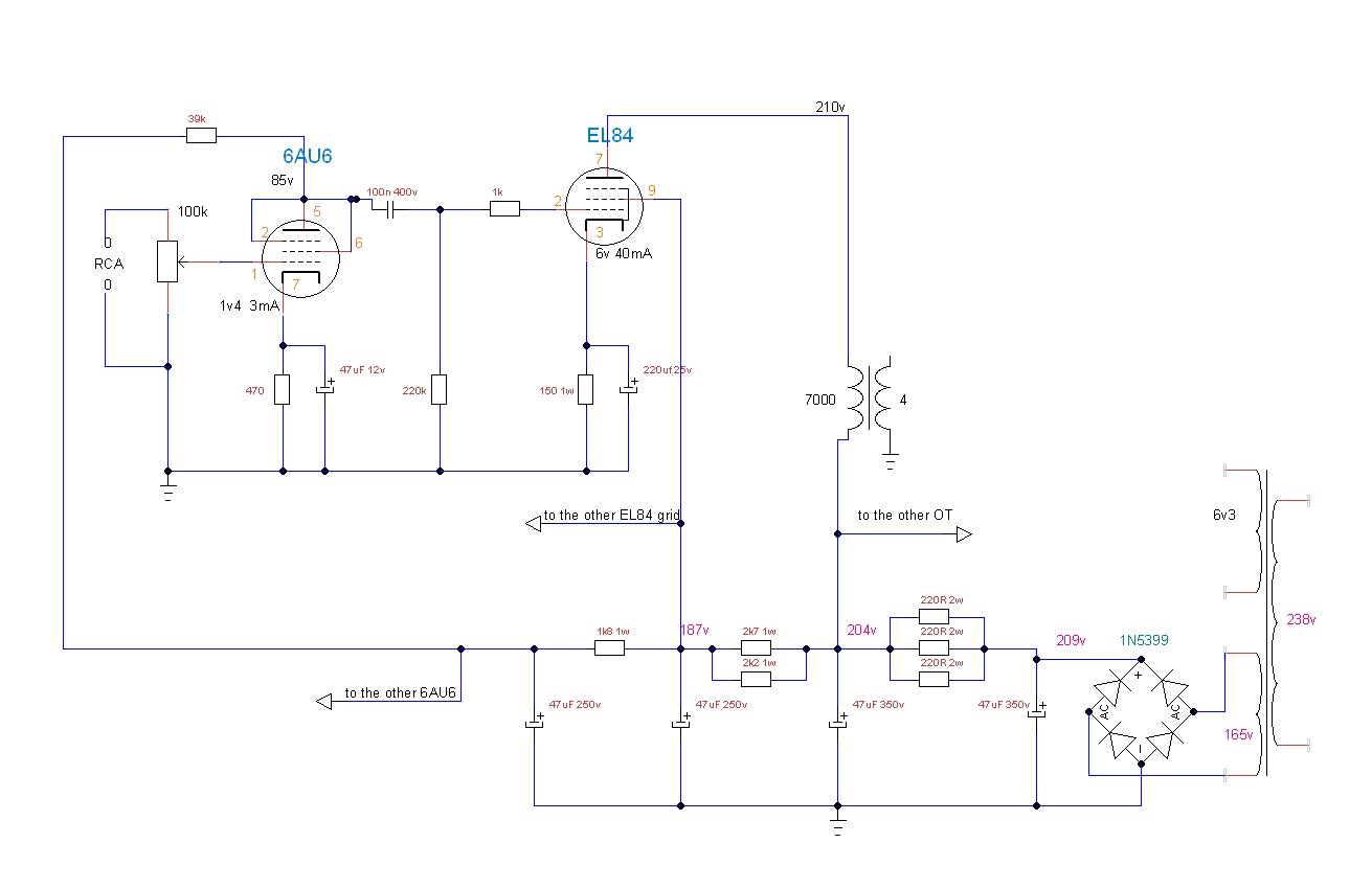

... these are the measurements I made this morning (the measured data are in pink)...
Looking only at the voltages in pink, this is the way I analyse it.
I see that you went back to using 3 x 220 Ohm after the rectifier.
With 3 x 220 Ohm: I = V/R = 5/73,3 = 68 mA
With 2 x 220 Ohm: , I = V/R = 5/110 = 45 mA (which would not make sense).
The screen grid current of 2 x EL84 and the current of 2 x 6AU6:
Rtot : 1/2200 + 1/2700 = 1/Rtot, so Rtot = 1212 Ohm
I = V/R = 17/1212 = 14 mA
So 2 x 6AU6 = 6 mA (3 mA per 6AU6)
So 2 x Ig2 = 8 mA (4 mA per EL84)
The current that is left for the anode currents of 2 x EL84 = 68 mA – 14 mA = 54 mA, so Ia = 27 mA per EL84.
Rdc primary OPT = about 400 Ohm (or?), so taking in account the voltage drop over the primary: Va = 204 – (0.027 x 400) = 204 – 11 = 193 V
Vg1 = Ik x Rk = (0.027 + 0.004) x 150 = - 4.6 V
So Vak = 193 – 4.6 = 188.4 V
Vg2k = 187 – 4.6 = 182.4 V
Looking at page 7 of this datasheet for the EL84 ( http://frank.yueksel.org/sheets/030/e/EL84.pdf ), I am having a hard time understanding how the EL84 could only be passing 27 mA at Vg2k = 182.4V and Vg1 = -4.6 V.
The curves on page 7 are given for Vg2 = 250 V (and Va = 250 V) and Vg2 = 210 V (and Va = 250 V). Note that between the two curves, and at Ia = 26 mA, there is about four blocks of the x-asis difference. To get the curve for Vg2k = 182.4 V you have to shift the curve for 210 V about three of these blocks to the right. If than you look at which Vg1 fits with 27 mA on that curve for Vg2k = 182.4, you end up at about -6 V.
At Vg1 = -4.6 V you would wind up with an Ia of some 40 mA.
The fact that in your amp Vak = 188.4 V instead of the 250 V in the curves, would explain part of the lower Ia, but unless I am mistaking, it could not explain the difference between 40 Ma and the 27 mA in your amp.
In your schematic the anode dissipation of the EL84 = Vak x Ia = 5.1 Watt. So with the losses in your OPT you will have a hard time getting 2 Watt out of it. But others already pointed that out to you.
