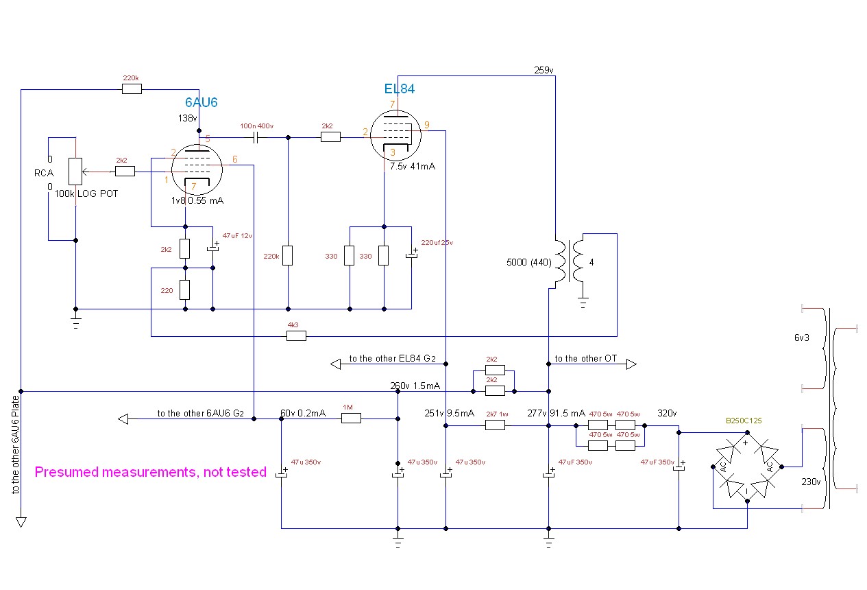

Your examination is as always precise and meticulous ... from the first chapter onwards everything is compliant and demonstrates the ineffectiveness of the project ... I do not explain, however, why a 230/170 transformer instead gives 238/165 and that there are only 209v after the bridge ... these data distort the rest of the project and do not even give the possibility to do something similar to the Armstrong ...
At this point I would check the EL84 emission, in a tube tester or by by comparing it with a known good specimen. To get the most out of the output transformers, best course of action would be to replace the power transformer or select another tube. EL84 requires at least 250V. ECL82 would be a better choice at 200V.
My guess is that the power transformer is overloaded. It is unable to supply the current spikes required to charge the filter capacitors due to core saturation and winding resistence.
Don't forget to take voltage regulation into according which is usually 10%, more for smaller VA transformer due to voltage drop caused by resistance of internal wire size. So 100*((238-209)/238)=12% or 29V from 0 to 76mA.
other measurements:
plate El84: 188v
cathode El84: 4v3
plate 6AU6: 73v

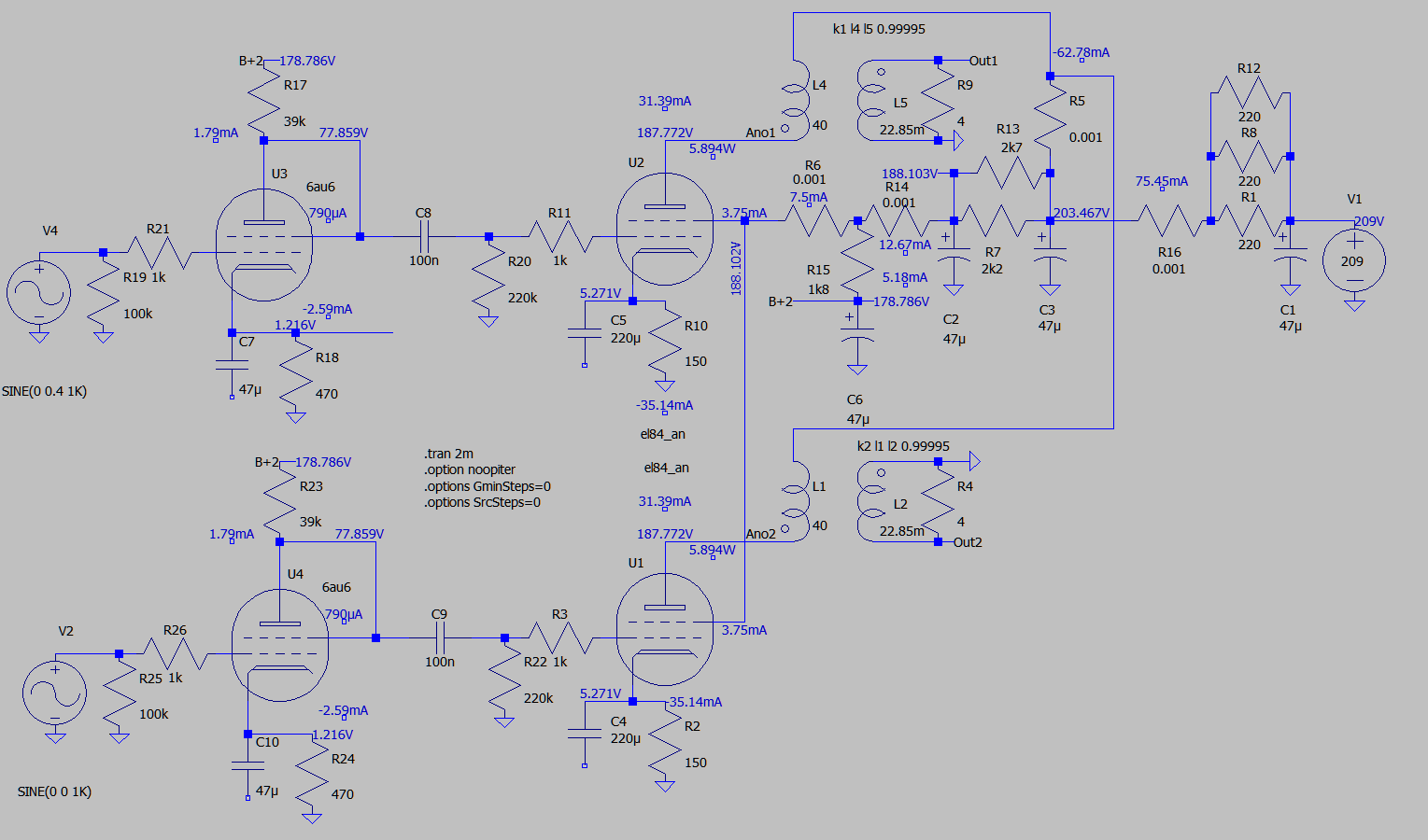

Cathode is 5.27V in my sim. Btw what brand 6au6 and el84 you're using? For completeness, I sim the entire circuit, you can verify against your measurement quite quickly and if you use LTspice and maybe a scope is necessary for making alignments.

....At Vg1 = -4.6 V you would wind up with an Ia of some 40 mA. .... The fact that in your amp Vak = 188.4 V instead of the 250 V in the curves, would explain part of the lower Ia, but unless I am mistaking, it could not explain the difference between 40 Ma and the 27 mA in your amp.....
We may be seeing different data? I see 204V plate-cathode, 40mA total cathode current, so probably 35mA plate current. 7 Watts dissipation (half of EL84's rating). "Happy Load" about 204V/0.035A or 5.8k. Likely output maybe 2.8 Watts sine RMS at 5%-10% THD.

The noted 165V AC should make 233V of DC, before sag. I don't think 209V raw DC is suspicious. But there may not be a lot more juice in this barrel.
I normally see ~1.25X the available HV at the DC OP of cap input filters. Some folks load up the first cap to high values, not the best of ideas. It is the RMS current that cooks PS transformers, not the average current. This is a Class A amp, PS regulation should not be a major problem. My 2 Centavos, anyway.🙂

My calculations were based on the voltages in pink in the schematic TS presented in post # 56.

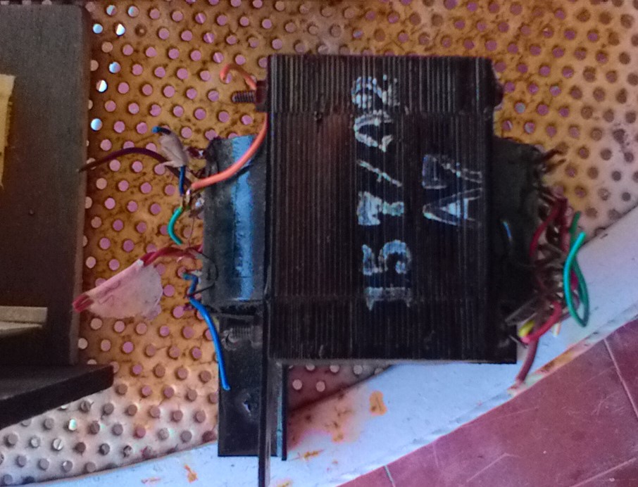

The data are those measured ... on the other hand, after 209v on first cap, the measurements follow quite faithfully what it should be, so the issue is upstream ... if the result is to be 2w and not even of good quality, it is better to abandon ship before it sinks and think of another solution. Yesterday I received the transformer in the photo ... from the size I think it may be enough to run 100 mA or so. In the meantime, I've to decide whether to leave the project similar, however, with HT 250v or change it by thinking of 2xECL86 which also have the advantage of working at 7k load and therefore closer to the 10k / 8ohm required ... the second option, however, would in practice mean starting over almost from zero...
