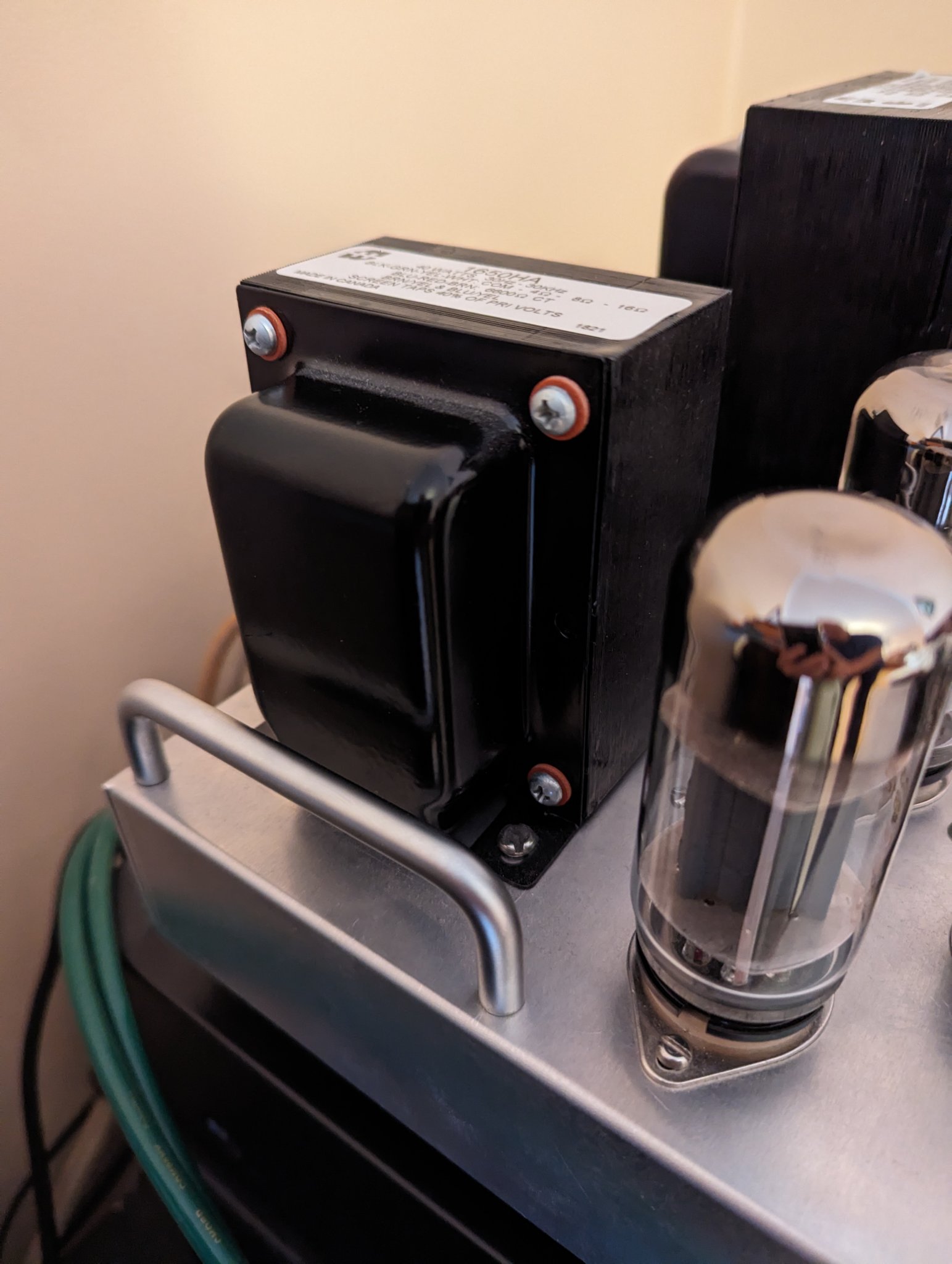

You may be kidding, but that's exactly what I did after carrying my amp several times around the house!Maybe add carrying handles to it. 🙂

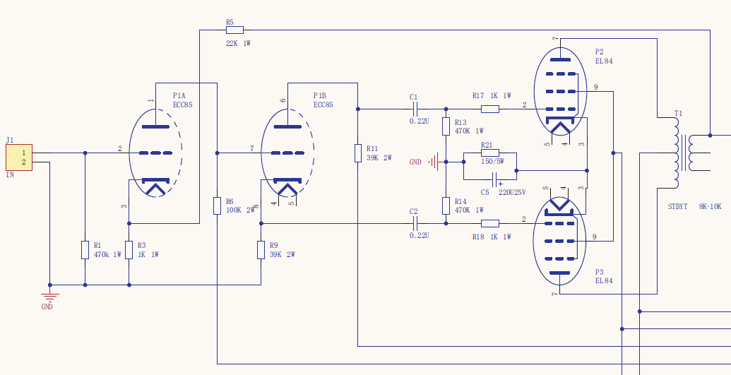

Yes, that one, assuming 8k is the ideal value. One schematic says 8k and one says 10k. I have been under the assumption that 8k is the best choice. I have no way to test the stock Chinese transformers. They are labeled 10k on the side, not 8k.

I always have liked amps with rack mount handles on the front. Some people don't like them. When I was hauling around a Threshold pure class A amp that I could barely lift, they came in handy. The Dynaco ST-35 is hard to move around because the circuit boards are exposed and are right on the outer edges, and hands pinch them when moving it if not careful.

10K is a little high for EL84s. Anything between about 6.5K and 8K should be fine.

Others have noted that 10k probably isn't ideal. With Chinese transformers we never know for sure without testing. I think XrayTonyB did test his transformers on YouTube and found them to be close to 8k.

It's class AB pentode. No ultra-linear. Global negative feedback. It will take me time to digest all of that info, but thanks! Maybe I can find a tutorial online.
Is there any legitimate benefit that might have caused the designer to have deliberately chosen the value of 10k instead of 8k? Voltage is 340. I really like the sound of the amplifier and I don't want to change the sound at all. If I didn't like it, a lot, I wouldn't be building a second one.
Note: the schematic in Post # 92 Does have global negative feedback.
That is a real good thing to do, because the EL84 is in pentode mode (40k plate impedance, rp).
1. The designer of that amplifier knew that loudspeaker manufacturers rated their speakers as "8 Ohm" But they actually have minimum impedances of 5 Ohms.
2. The designer knew that there was a glut of 10k output transformers, so they were less expensive than the otherwise similar 8k transformers.
3. The designer wanted a little more output power, so he abused the EL84 with more B+ voltage than the tube was rated for.
At that extra voltage, the 10k gave more output power than the 8k.

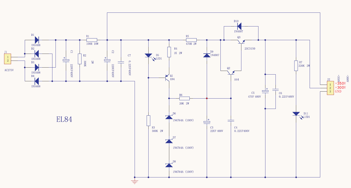

#3 had escaped my attention. I never looked at it. B+ is 340V. About 330V at the tube I think. I have it written down somewhere. Tube max rating is 400V. Does the voltage swing put it over 400V? I'm not going to change it. I have a few sets of 6P14P-ER (Russian 6N14N-EP) tubes that sound great, and they are rugged with 14W dissipation and 10,000 hr life ratings. Old Soviet-era military tubes.
Some EL84 variants are rated as high as 400 volts on the pate. But, most EL84, whether plain vanilla or fancy flavours, won't tolerate much more than 300 volts on their screen grids.

The amp has a regulated screen supply. I attributed this to the Chinese 6P14 that is reported to almost instantly self destruct if it goes over 300V. Mine is at 297V and I am not using the Chinese 6P14. I had to change one of the Zener diodes to get it below 300. One comes in the kit. I don't what makes the amp sound good, but it does. It gets the "timing" of the music right. Not sure how else to put it. I want to see what bigger better OPTs bring to the table. Thus, this thread looking for OPTs.

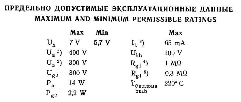

Soviet 6P14P-ER specs (service life >10,000 hours)
6P14P same but service life 3,000 hours
6P14P-EV same but service life 5,000 hours

I looked at some of the EL84 data sheets at Franks tube data site.
EL84 Maximum Plate Voltage:
Quiescent 300V
Cut off (no current) 550V
The screen voltages are the same as the plate:
Quiescent 300V
That means you can triode wire an EL84 and use 300V Quiescent.
Using an EL84 beyond its ratings is possible, but . . .
Your Mileage May Vary.
There is a tube that is similar that is rated for higher quiescent plate voltage.
I am sure someone will remember the tube type number (4 numbers, in the thousands).
Sometimes I think I would like to try a pair of SV83 tubes. The maximum screen voltage is only200V.
Might be nice in Pentode mode, with an OD3 150V gas regulator tube for the screen.
