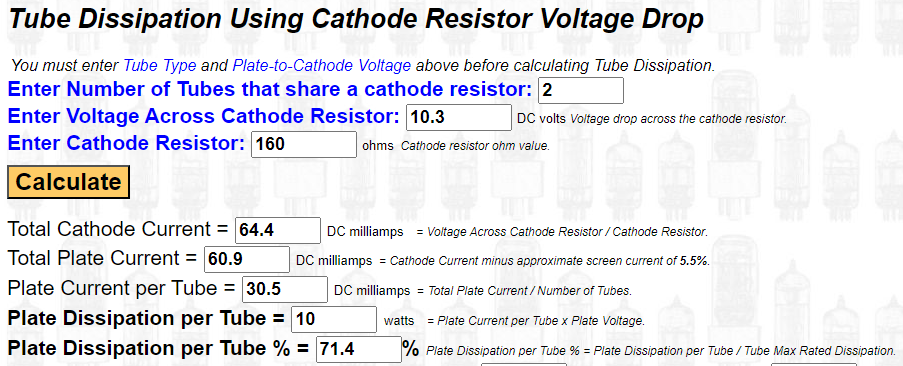

I "cheat" and use a calculator online. (When we started calculating circuits in physics in college I almost failed!) It calculates 10 watts for EL84 12W tubes at ~336 volts at the #7 pin, assuming I filled out the form correctly with my measured values. The higher the dissipation, the lower the maximum voltage? I assume one of the curves shows that? I didn't notice the note specifying <=8W on the spec sheet. I see it now.
https://robrobinette.com/Tube_Bias_Calculator.htm
Is this helpful? I had hoped to put items like this in a build thread, but I'm not there yet. I'll just have to refer to here later. If the chassis would move from the Hong Kong airport where it has been stuck I could move forward with OPTs.
I typed that wrong. I actually put in 14 watts for 6P14P tubes, not 12 watts, to get those numbers from the calculator. Advice back when I built it was to increase the bias resistor, which was 150 Ohm on the schematic. I used 160 Ohm.
