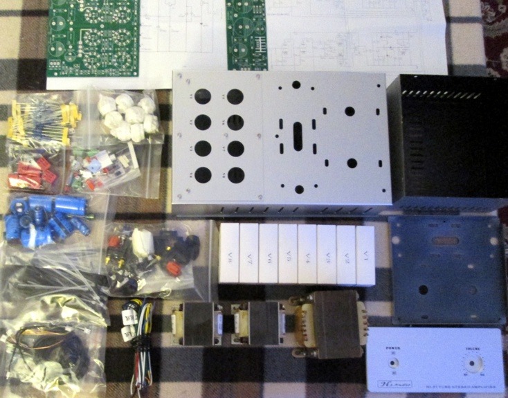

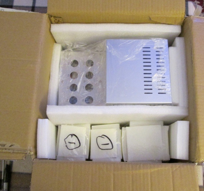

Well, Christmas came early this year!
I should be able to measure for and order OPTs on Monday when the new power transformer arrives.
It was supposed to be in Hong Kong as of this morning. Apparently US Customs opened my package, which doesn't usually happen.
And this is why I like kits. No shopping and no fabrication, just paint work because I hate silver. I don't have to replace anything if I don't want to. I'm sure the WIMA coupling and bypass caps are not genuine. I'll get genuine this time. I don't trust the power supply caps so I'll order some good ones this time. The carbon volume pot is being replaced with a $15 SMD stepped attenuator that people like. No great expense there. Cathode bypass caps will be Nichicon Muse I guess. Any suggestions for PCB-mount tube sockets? The Micalex ones (or whatever they are) in the ST-35 kit are awful. Their death grip on the tubes is going to break the PCBs one day. It's ridiculous. PCBs shouldn't go through that kind of stress. Cheap porcelain ones come in the kit and one is starting to loosen a bit in the other amp.

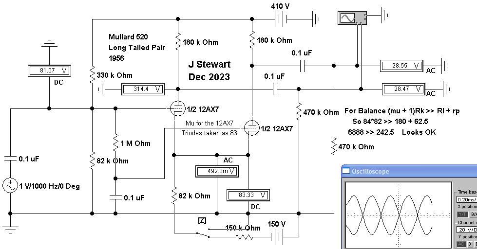

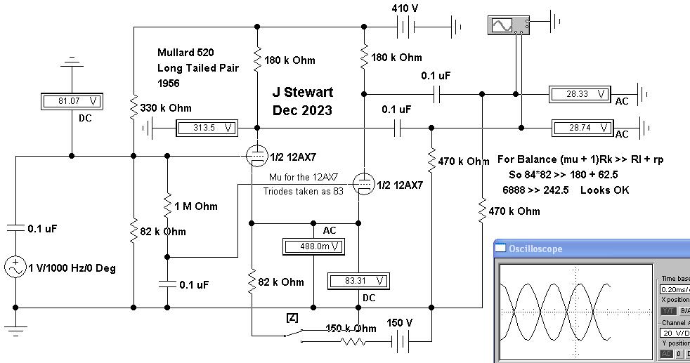

During the long development of NGO’s amplifier, I vaguely recall some discussion of the Mullard Long Tailed phase splitter. Here is an item I don’t recall ever getting properly analyzed.
For good balance of the output signals to the following stage, it is required that the circuit satisfy the relation (mu + 1)*Rk >> rp + Rl. Taking Mu to be 83 as a worst case, the LHS of the relation calcs out to 6888. The RHS is 242. And the simulation tells us tells us the signals differ by 1.45 %. That would be sufficient for most applications.
But that difference can be reduced quite a bit by installing a longer tail. For those who don’t want a SS device in the audio path, a simple resistance to -150V is an alternative. And the difference reduces to 0.28 %. 150V sets a safe limit to avoid H-K insulation damage.

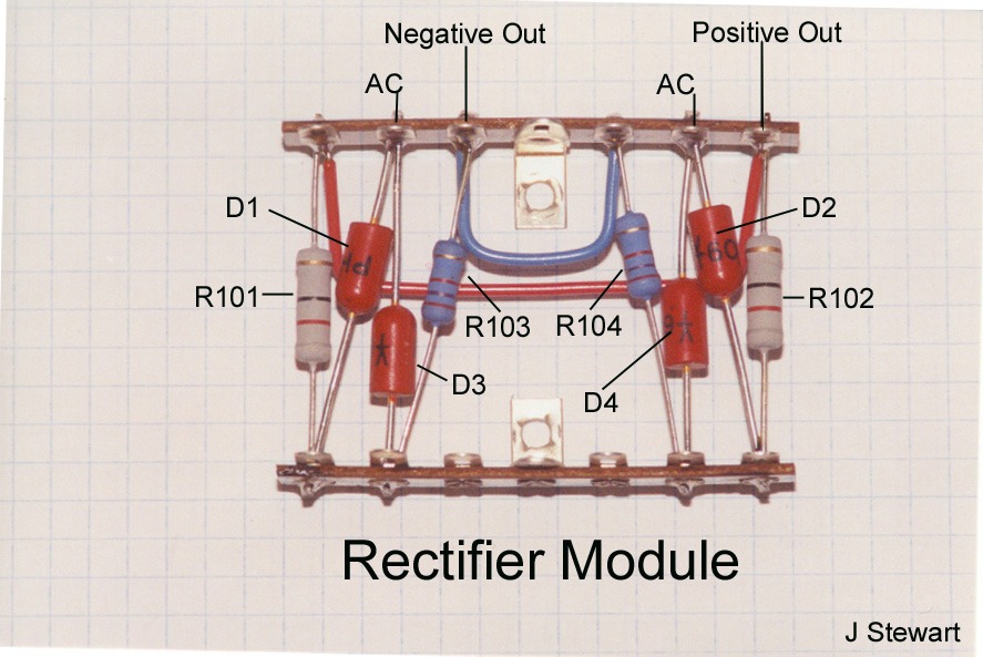

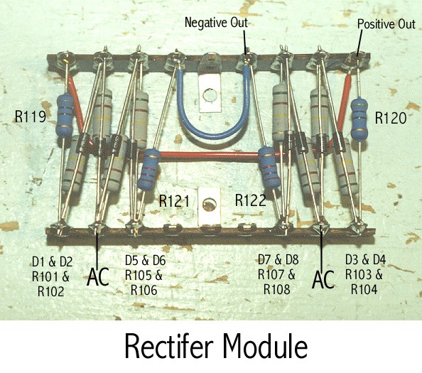

The negative voltage can be easily derived from the same HV winding on the PT as the B+. And can be used to provide biasing for a fixed bias stage as well. An 0D3 or 0A2 will set the -150V. Or Zeners if desired. Some people like to see the gas tubes glow. I’ve found they are more stable than Zeners. Zeners are very much affected by temperature.
I’ve done this on some builds. Both positive & negative voltages are rectified from the same HV CT winding of the PT. No odd taps are required. And the rectified result is full wave for both polarities. The rectifier modules are constructed on simple terminal strips. All screwed to a supporting scrap of wood during assembly & soldering. When finished the entire module is installed in the chassis as a single unit with connecting wires already in place.
There is more to this equation, maybe later. 😀
@jhstewart
Please repost this valuable analysis in the new build thread: https://www.diyaudio.com/community/threads/huaji-audio-6p14p-el84-6n1p-pp-amp-kit-build-2.406195/
At the risk of aggravating some others here, maybe it's time for me to start a thread for the amplifier instead of the OPTs. If we put all this stuff in this now very long thread, then people looking for EL84 OPT info will get lost, and people looking for this kit will get lost. I encounter that so much when I look for info. If another thread annoys people here, so be it.
Done.
