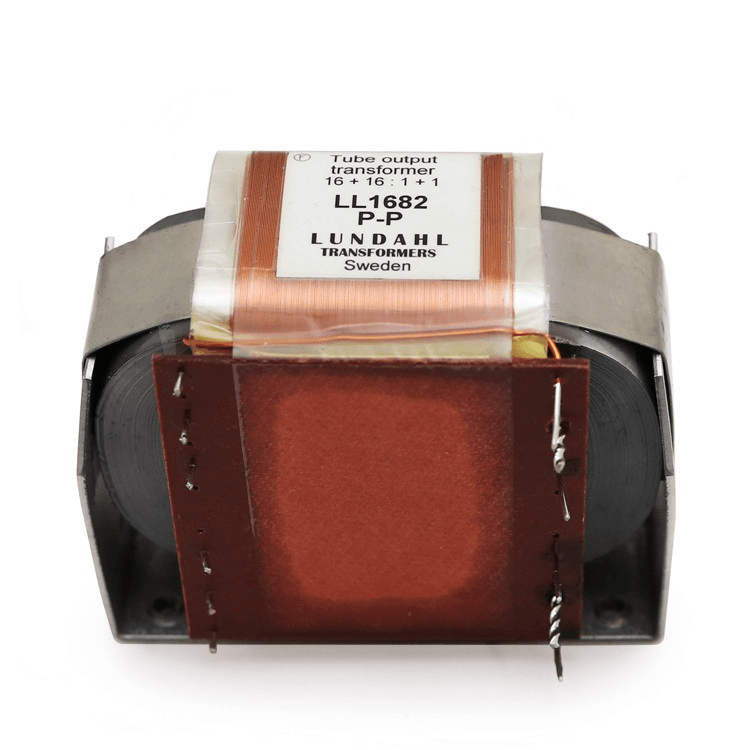

Lundahl LL1682.
They need to be a traditional transformer with end bells and wire leads.
Not this:
As I said you can always make a cover that screws in like an OPT with EI core and end bells. Can you? Not a difficult task really.

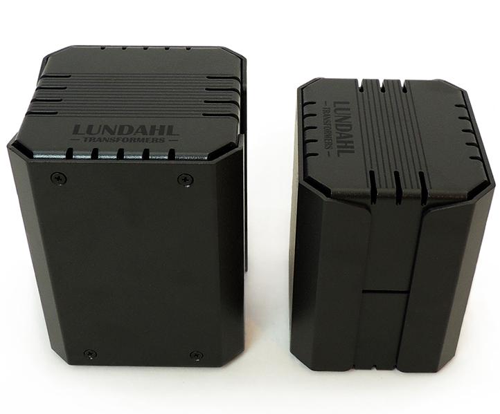

That LL1682 can be placed in this housing:
The specific housing type is the “1638” type. Both the transformer and housing is available from the US distributor, Erhard Audio.

... with end bells and wire leads.
I don't see that it meets the requirement.

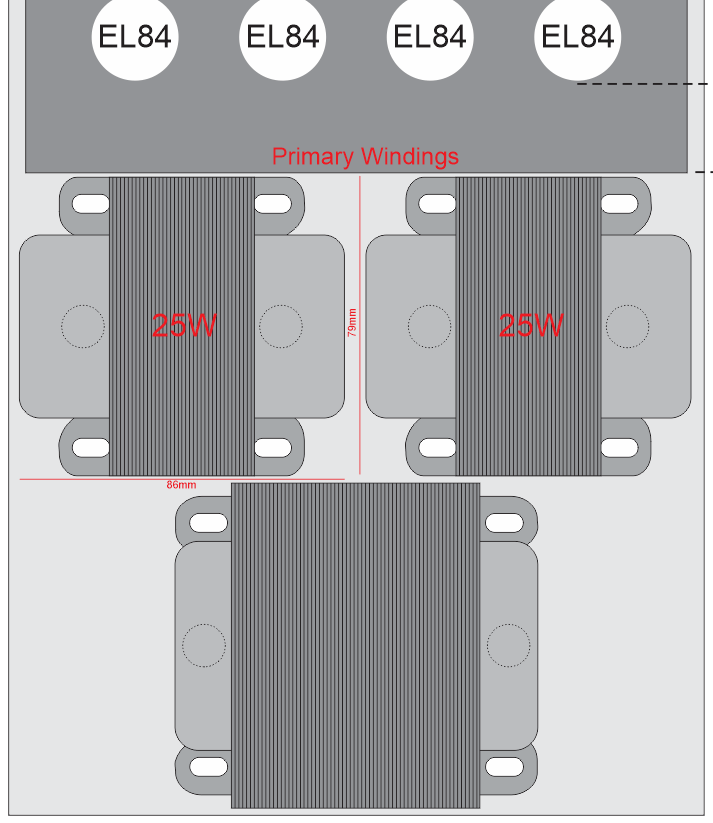

I think after doing a scale drawing that Primary Windings 25 watt 8k will fit with 2 mm to spare. Is 8k ideal given this scenario or is another value more appropriate?

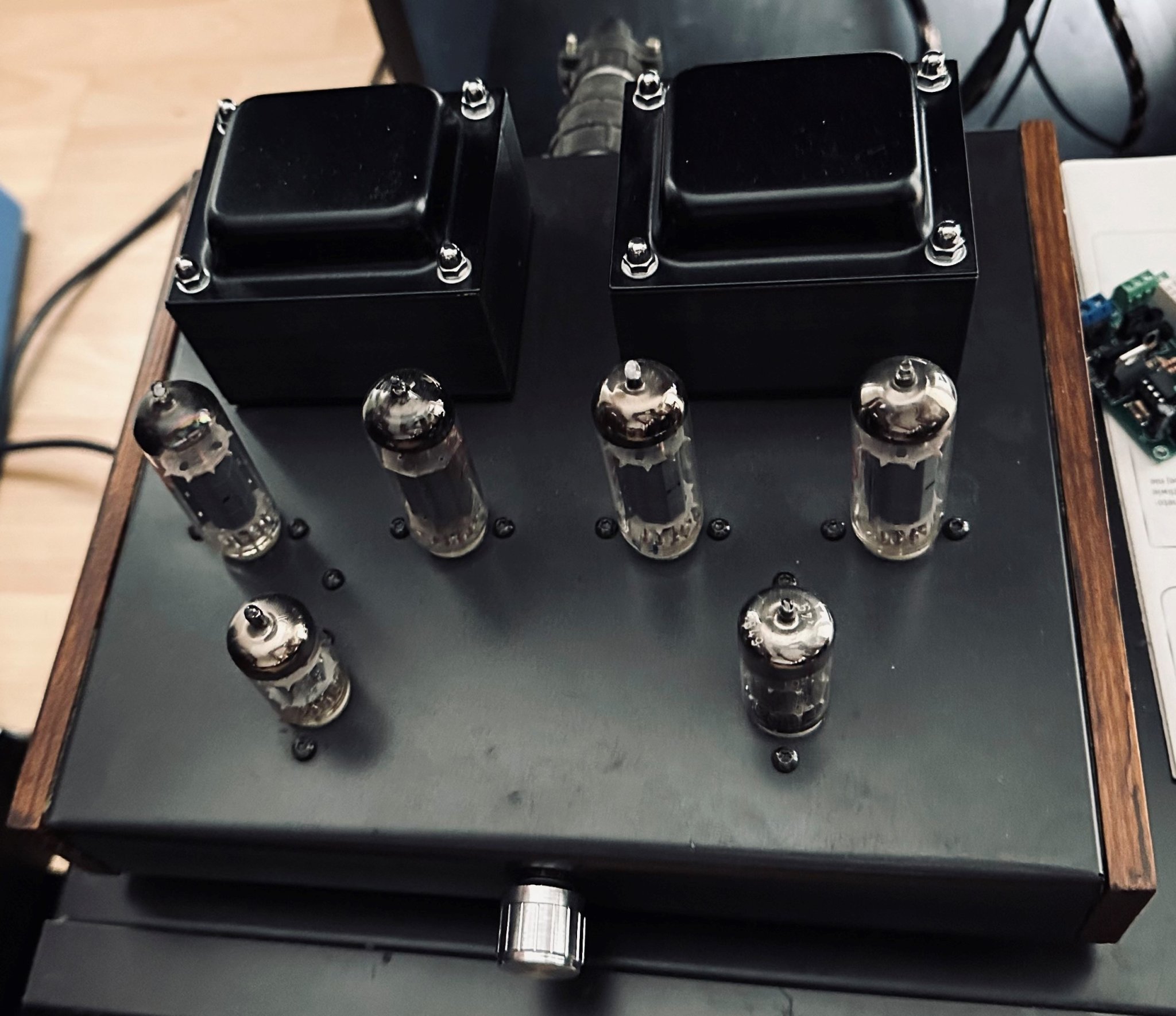

A beautiful sight if I got all measurements correct. The power transfomer winding is horizontal (parallel to the amp) while OPT windings are vertical (up and down in relation to the amp). This is the way they are oriented now, and packed almost as tightly, with no problems. The extra space needed for the Primary Windings transformers is gained by leaving off the metal housing that goes over the stock transformers, which are half the size.

It's usually considered good practice to have the PT laminations at right angles to the OPT lams.
Primary windings will likely be costly to ship as they are in the UK. Just sayin'.
By the way, the Hammond 1650F (7.6K, 25 watts) is 90mm wide versus the one shown in your drawing's 86mm. Might just fit in a pinch.

Windings are still at right angles from the OPTs to the power transformer whether the OPT laminations are rotated 90 degrees from the power transformer or not. OPT's are wound vertically, power transformer is wound horizontally. Winding orientation controls magnetic field not the laminations if I understand correctly. That issue was raised several times. Correct me if this info is wrong. I'm always learning. They come configured like that and seem to work fine. I found these illustrations in some reference book somewhere as I was looking into this issue. Spacing the left and right OPTs farther apart might be ideal, but the narrow chassis is something that I really, really want.

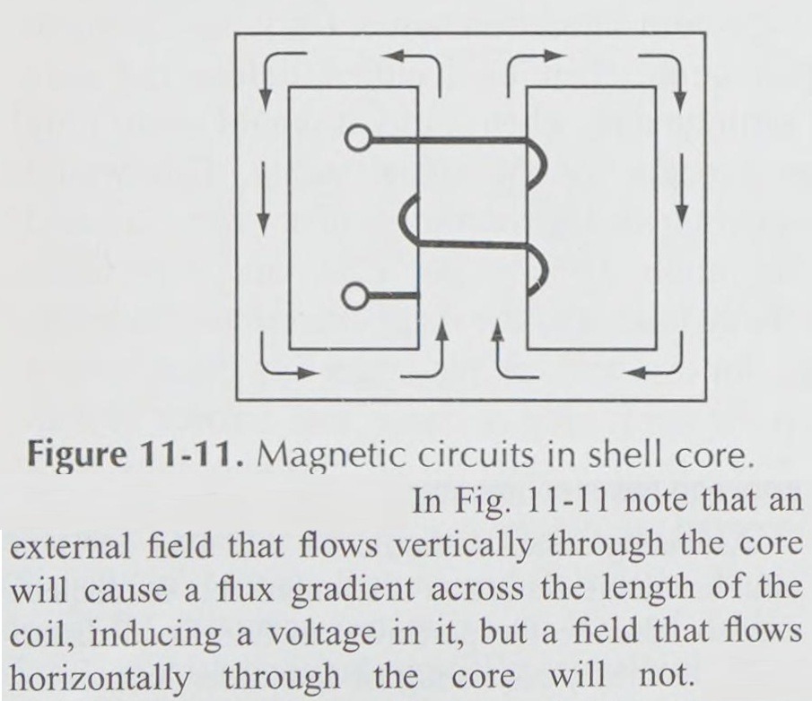

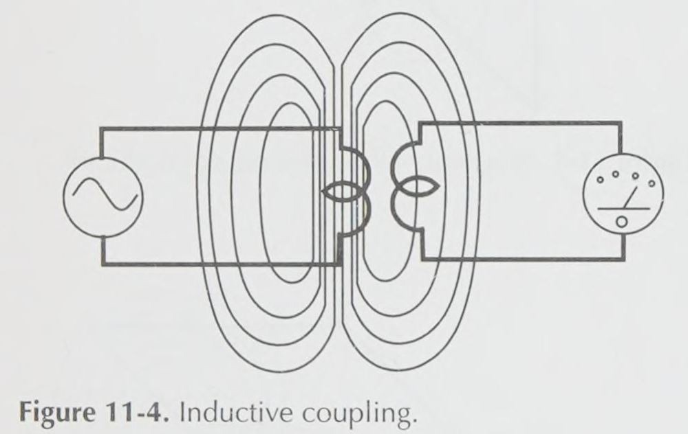

The lams also indicate winding direction. Either rotate the OPTs or the PT in your drawing. I've seen amps where the OPTs bookended the PT and all were very close (EG. Leak Stereo 20) and the PT was 90 degrees to the OPTs. No magnetic interaction as far as I could hear. If you are using a choke in the power supply these can sometimes radiate or pick up AC. If you are very, very careful and temporarily wrap the choke in electrical tape, it's possible to "tune" the choke live for the position of minimum interference. This has worked for me on a couple of occasions.
S.
S.
How so? The windings are 90 degrees regardless of the lamination direction. This has been discussed many times, but no guarantee that those who discussed it were correct. So much to learn. We all start somewhere.

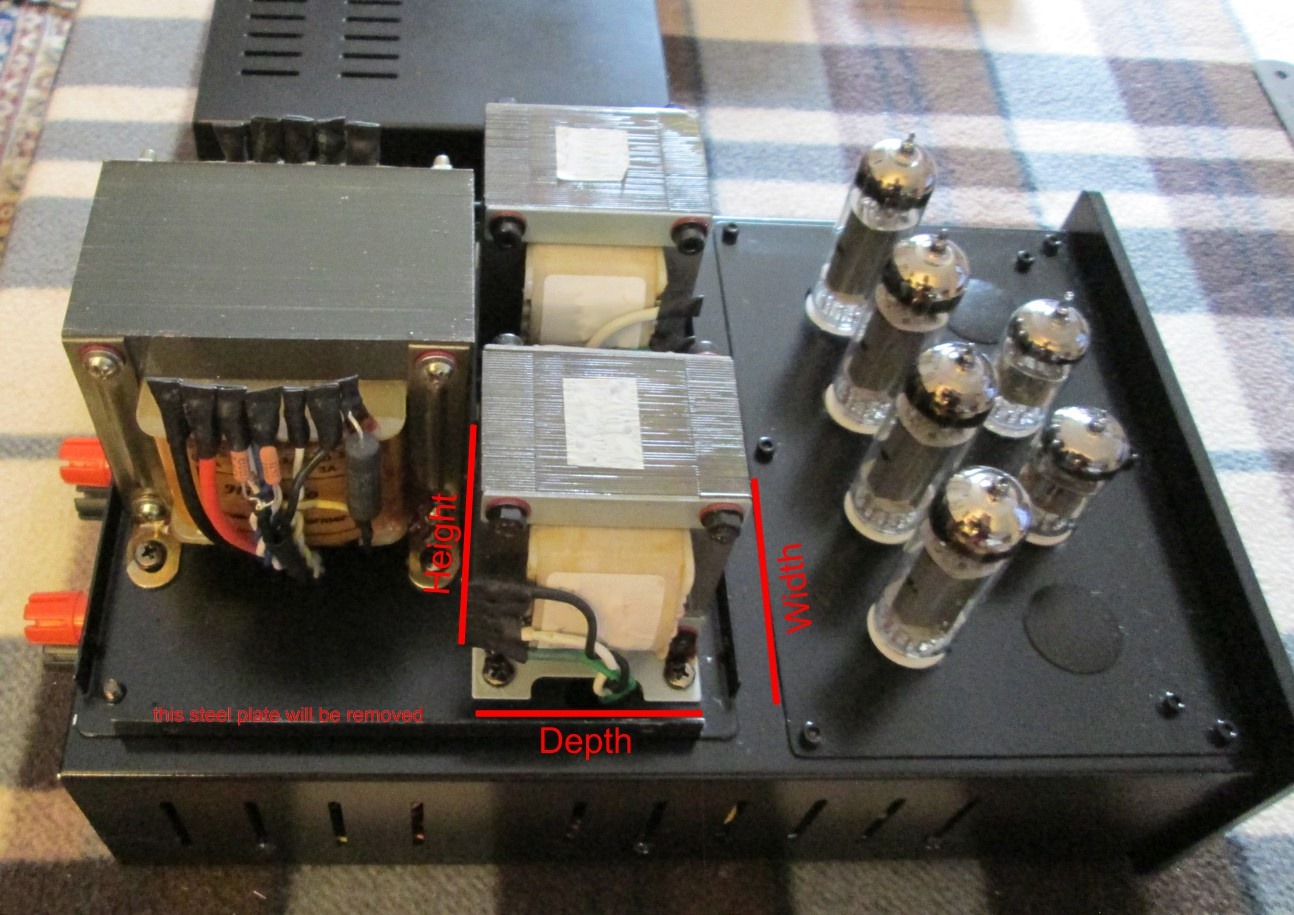

Here are the winding orientations in my current amplifier, which I love dearly even with the small Chinese OPTs, horizontal vs. vertical windings:
