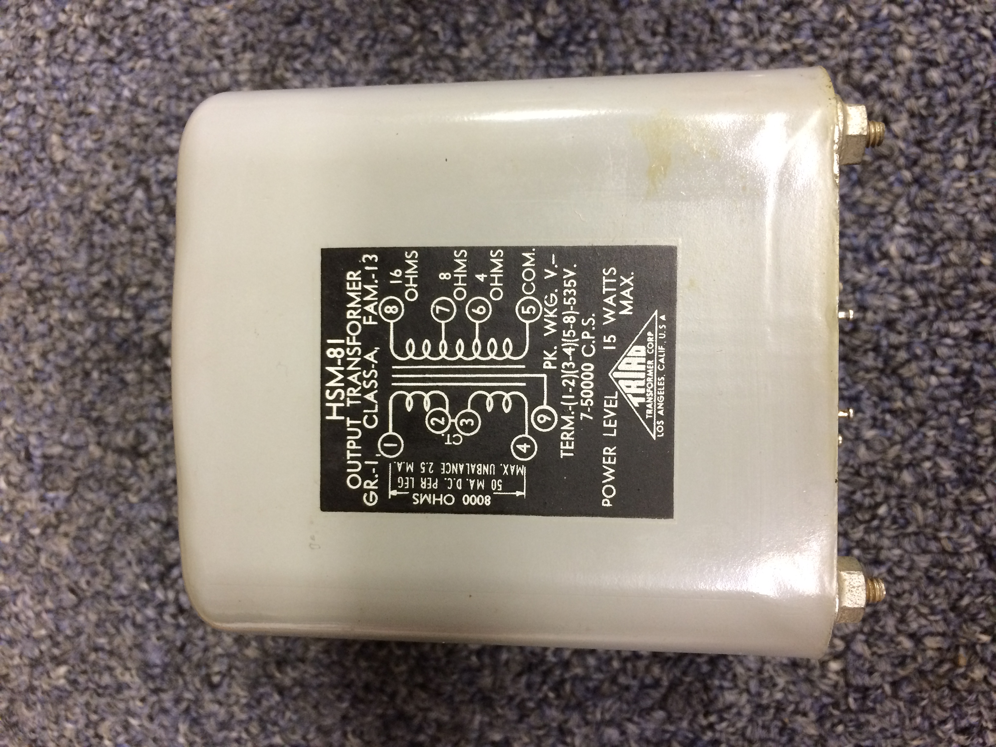

I have had good success just keeping an eye on auctions. Found Lundahl, Sowter and these Partridge OPTs that way.
