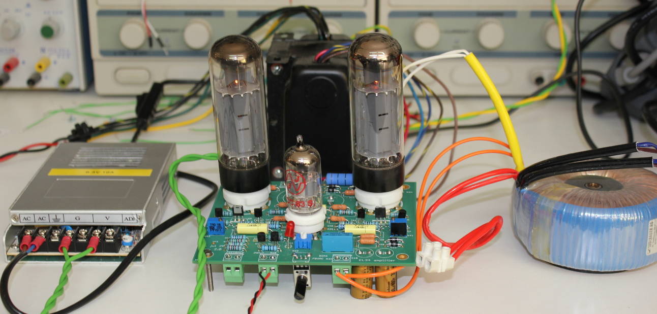

I have worked on a quad EL84 before to decide to use the EL34, I have abandoned the quad output tube project because for a stereo amplifier it needed 8 source followers with 8 trimmers to adjust the bias of each tubes 😡 At a certain point I was thinking to use Norman Koren auto bias, but finally I found much more easy to replace the EL84 noval socket with an octal one to accommodate a wide choice of output tube from the 6V6 to the KT88...
Thanks again for your support, it worked very well and had a lot of success on this forum.
As you wrote, I have effectively said that I preferred the 6CA7 compared the KT88, I also tested the 6V6 with a Hammond 1609 10 k output transformer and the result was good but with the same power than the EL84 version, about 10 W. I didn't have KT77 in stock therefor I could not test them, but I hear some good criticism from others user's about this tube, it is interesting to see that the Baby Huey schematic is flexible enough to support different tubes without stability problems ! I have never user the global feedback input and the amplifier was always very stable 🙂 I have added two lists of possible tubes with their main characteristics.

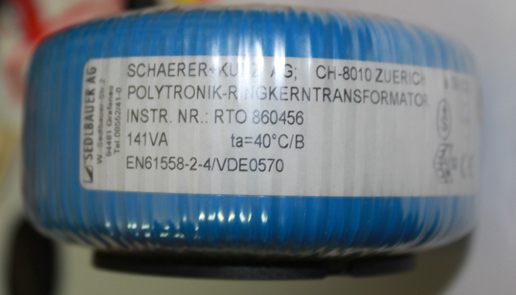

Back to the power transformer, the TOROIDY TSTA 250/001 will be perfect for a stereo amplifier, I have used a custom 141 VA transformer without problem in my setup (see photo), but for those who prefer a separate 6.3 V DC power supply I recommend to use a switching one which is availble for very reasonable cost and will not require a transformer.

A follow-up to the TOROIDY TSTA 250/001, this company, TSTA 250/001 TOROIDY - Transformer: toroidal audio | TME - Electronic components shipping to the US is approximately $10, which isn't too bad considering it is shipping from Poland or an EU warehouse.
I just spoke to Antek and they are reviewing the specs of this PT to determine doing a special run and should know something by weeks end.
With the Antek PT, what will be your output tube? 141 VA transformer will be ok for stereo but for smaller output tube

Marc's board is very well designed and flexible; however, flexibility is also your enemy because you will have to fine tune the configuration if you are going down the path that no one has done. My 35wpc Eico HF87 (converted to fixed bias) sounds excellent with EL34's. You really can't go wrong with the EL34/6CA7.
