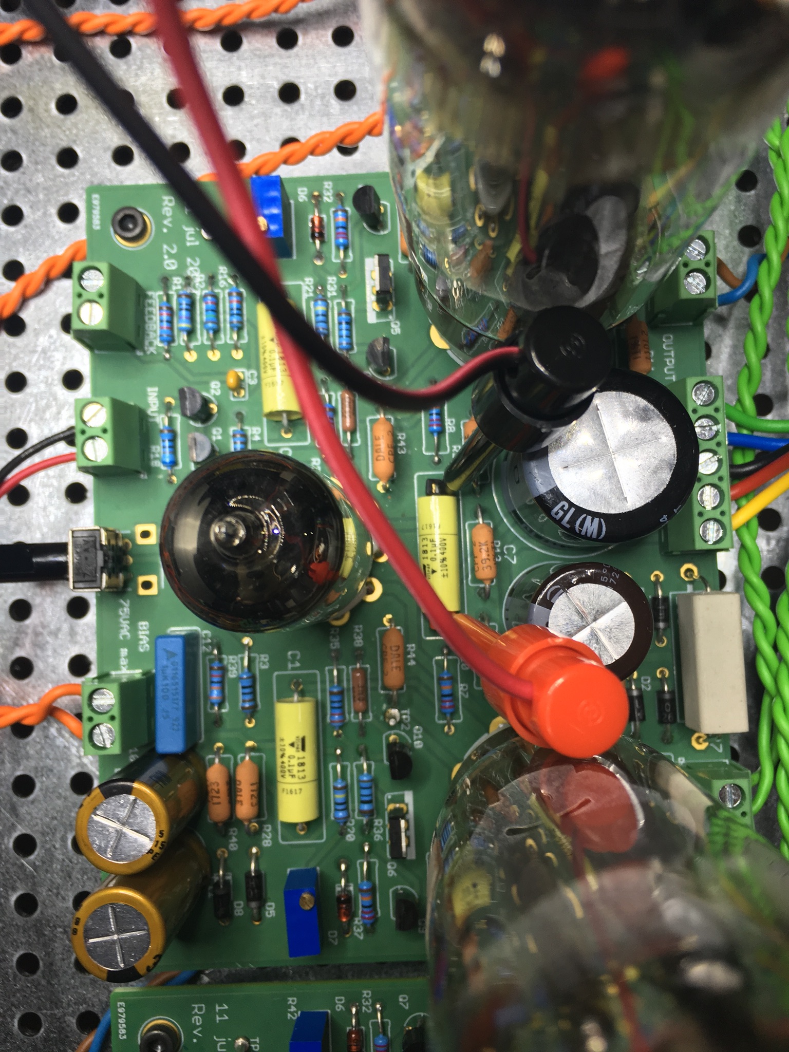

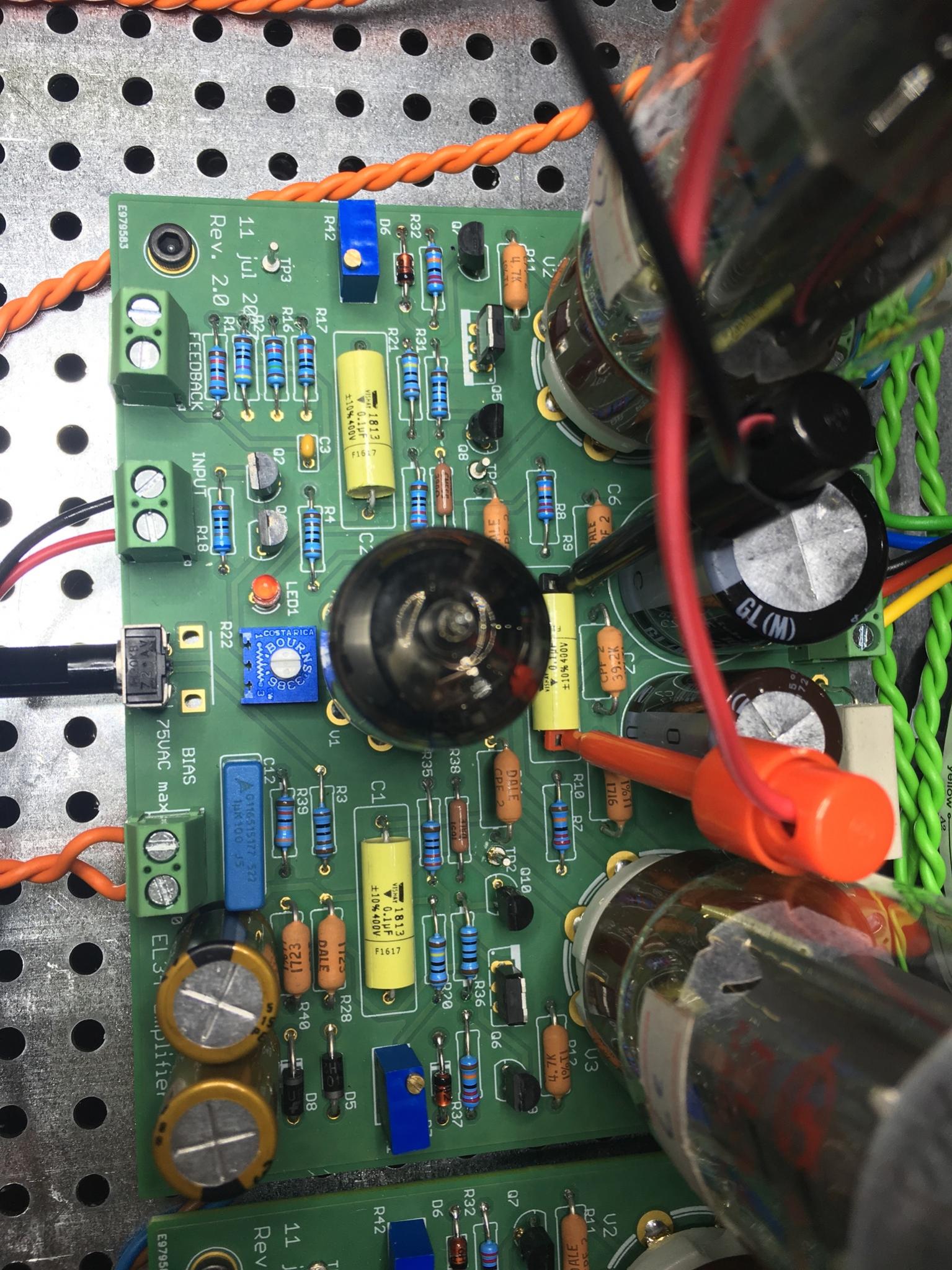

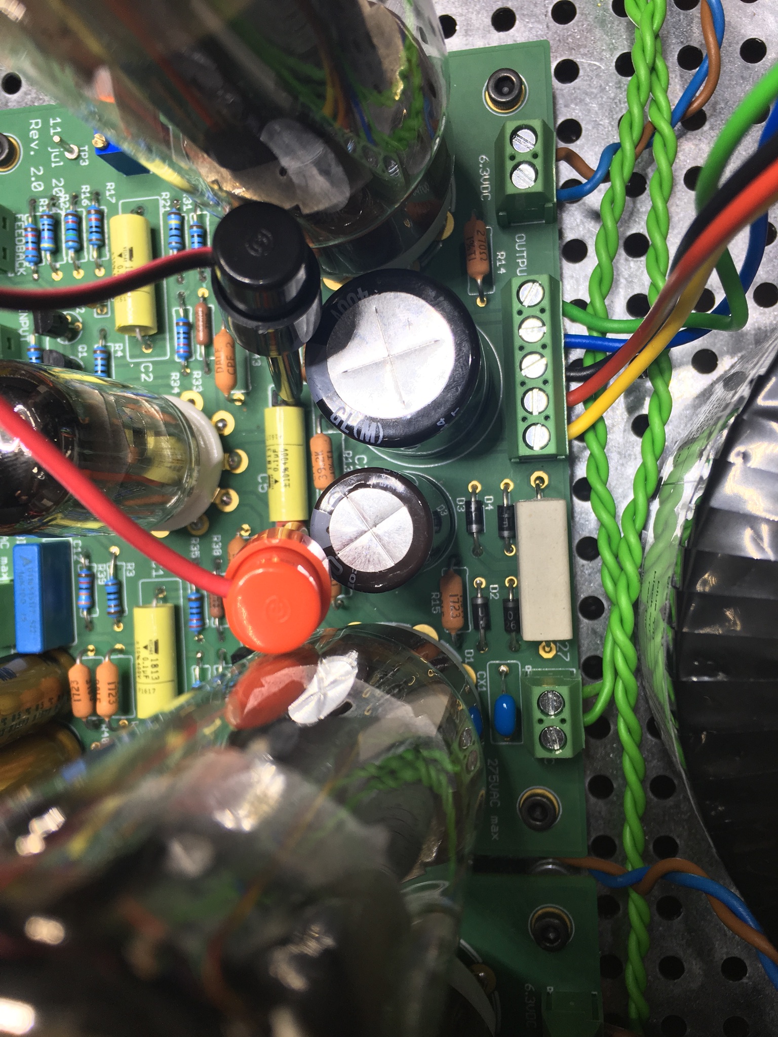

Need help...
I’ve just finished building the amp and after power on and before proceeding to adjust the amp, the led start flashing. Is this normal behavior?
The voltage across C5 start at 420 volts and then drops progressively to below 385v but with a varying value. It does not ends at a fixed value. Any clue?
The transformer is stated to be at 275v but I’ve measured it to be around 300v more or less. How can I drop the B+ to a suitable value? Change R27 to a higher ohm rating? Max voltage rating for caps is 400v. I’m worried about safety with the voltages being so close to max tolerance of the caps.😱
I have checked part list and I feel confident that all parts are in the correct place and in the intended orientation...🙄
Please help...:sorry
Jorge
Jorge
Hi
First thing to do before powering up a tube amp; if your OPT are connected make sure you connect a load, ex 4-8 ohm.
With your transformer I would make sure C5-C7 are rated above 450Vdc.
R27 might be used to mesure total bias or something, not sure if you should change the value but you are correct therefore increasing the value will drop your B+
You could also replace R27 by a choke, this will drop your B+ and normally makes an amp even quieter.

Hi Jorge,
You can also use a power resistor between the first large filter capacitor where it will drop a lot of voltage with little heat. It works by limiting the peak currents on start-up and the hot switching currents as well. This immediately reduces rectifier noise.
Adding a choke is a double edged sword. Do it wrong and it picks up noise or can couple to the power transformer and make your ripple worse. It also will radiate like a transformer. So therefore you have to treat the choke as you would a transformer. The calculations are more important too. You have to make sure the current never drops to zero with a choke.

NO - the LED flashing is not normal behaviour. It should be on steady.I’ve just finished building the amp and after power on and before proceeding to adjust the amp, the led start flashing. Is this normal behavior?
Are you sure you dod'nt get a flashing led supplied by mistake? I can't see any real way for the LED to flash otherwise.

Hi Jorge,
Don't forget that you must read the bias voltage on the opposite side of the trimmer, see last page of the "Building recommendations..." !
It is normal that the high voltage decrease from 415 V to 385 V after power up because when the heater are cold there is no current in the tubes but when they are warm the load consumption reduce the voltage...
LED flashing is not normal, are you using 50 V AC on the bias power input ?
Good night,
Marc
Good night,
Marc
Hi Marc,
I know that the bias voltage is measured in the opposite side but as I stated before, the pots do nothing.
The bias voltage is 50v.
Jorge
Jorge

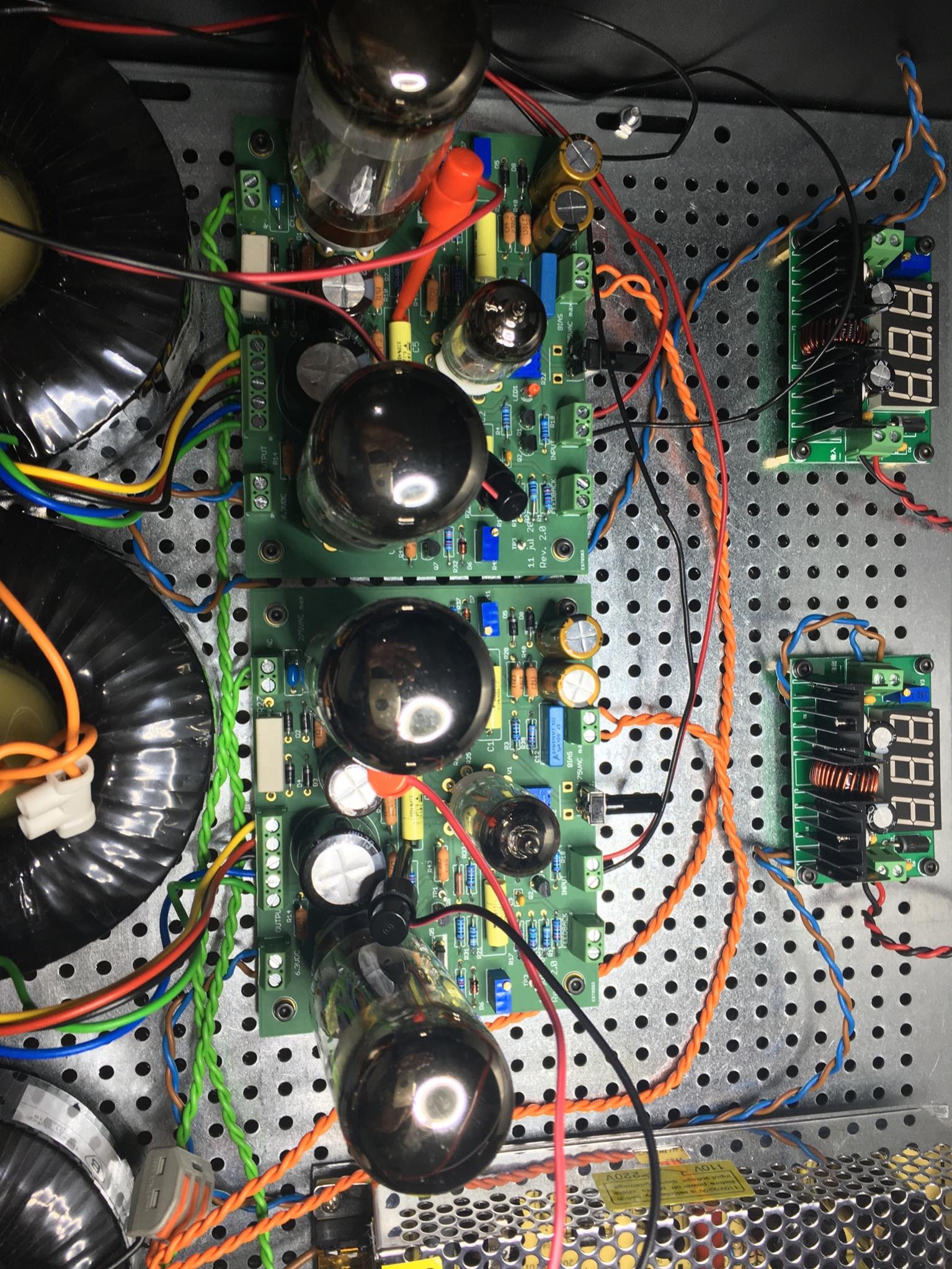

Still stuck
Hi all...
I’m afraid to confirm that I’m still stuck with the flashing leds, pulsating sound at speakers and no way to bias the amplifier.😕
I checked the cables for bias and I’m sure they are connected as told by Marc. The voltage is around 48volts, the resistance at the bias input is around 10 ohms. The ac input is around 275.
The voltages are dancing, non steady. 😱
I’m desperate....
Regards
Jorge
