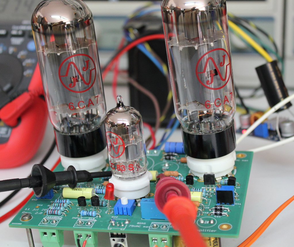

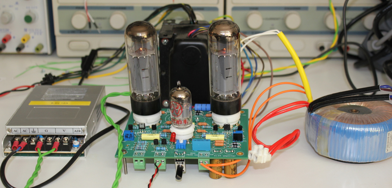

In the mean time I have finally en enclosed amplifier based on the EL84 version of the Baby Huey 🙂

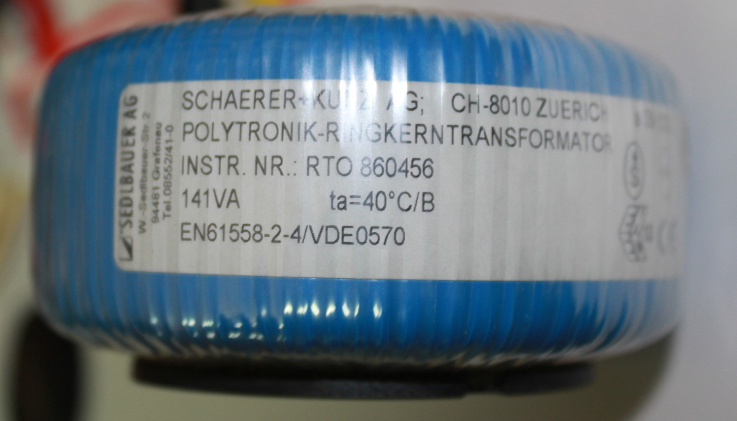

What are the voltage and ampere ratings of the toroidal transformer you are using in this version?
Hi zman,
The transformer it a custom version made long time ago (October 2002) with 250 V AC@300 mA, 50 V AC@50 mA and 9 V AC@8 A output voltages with a total power of 141 VA. It is enough to power the EL84 version as well as the 6V6, 6L6 or even my 6CA7 version...
However for new project with EL34, 6CA7 or KT88 I recommend the following Toroidy TSTA 0250/001 standard transformer : TSTA 0250/001 - Mains transformer for tubes - Shop Toroidy.pl The supreme version is more expensive but is very nice 🙂

It seem also that you are using this TOROIDY transformer https://www.tme.eu/en/Document/77cb69431827fb306b0301de1db87389/ENG_KT88_PP.pdf and the connection is OK 🙂
If your power transformer give you 49 V it is OK because in case of short circuit if there is too much current " l'enroulement" (I don't know the english word !) will burn and will be cut !

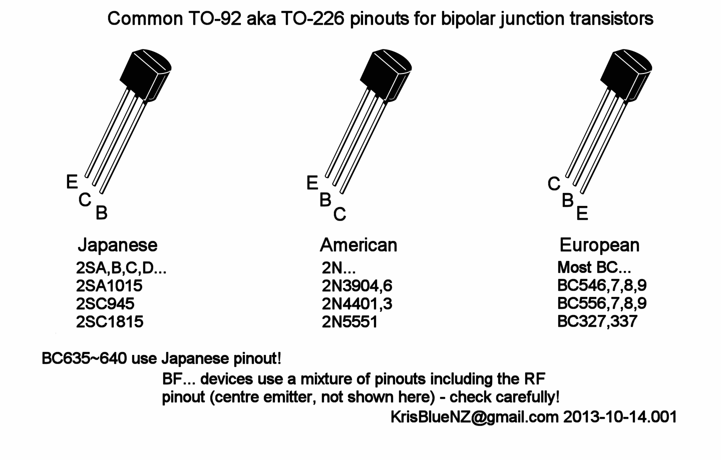

Hi Jorge
Looking at the pictures of your build I am wondering if the transistor emiters and collectors are reversed.
The Fairchild BC547B's I purchased from Mouser have a different pin-out from the 2N5551 noted as obsolete by many manufactures. The fairchild units I purchased, if mounted on the silk screen side of the board, must be soldered in place backwards. Check the data sheet for the transistors you are dealing with and compare it to the 2N5551 data sheet.

Check pin-out of your transistors. The Silk-Screen on pcb's is for 2N5551 which are noted as "obsolete" on Mouser . The Fairchild BC547B's I purchase from Mouser, as recommended on the BOM, have their emiter and collector reversed. I therefore mounted my transistors backwards compared to the Silk-Screen. LED's do not blink on my boards.
I guess another option would have been to mount my transistors on the bottom of the board per top Silk-Screen orientation.

Papavienneau is right 🙂 thanks for the remark !
The pinout of transistors is different if they come from Europe, USA or Japan ! This is really stupid for a component with three pins they found a way to make three different pinout, may be for protectionism reason ?
Anyway, this could be the reason of your problem if you are using BCxxx transistors, see the attached chart...

I used the BC547B
Hi Marc and Papavienneau...!!!!
I feel that this is the problem. I used BC547B from Mouser and mounted as per silkscreen, as Marc says, it´s stupid to change the pinout being practically the same part, I also do not understand.😡

Warning : do not use BC547B
Hi Jorge,
There is no need to match transistors for current source, but there is an other more critical point, the 2N5551 was specified because of its high Vce of 160 V and the BC547B is only 45 V which is not enough for this application, I don't know why I put this in the BOM Manufacturer code since I indicated the 2N5551 in the value, I was a little bit tired when I sent the 120 PCB's 😡
I would recommend to stay with the 2N5551, it is still available in volume at Farnell : http://fr.farnell.com/on-semiconduc...MIkfmRw-Sx2gIVEd0bCh3OvwDxEAMYAyAAEgJp7vD_BwE
I would even suggest to buy a certain quantity since it is a very convenient transistor for tubes amplifier (I have bought 250 of them...).
