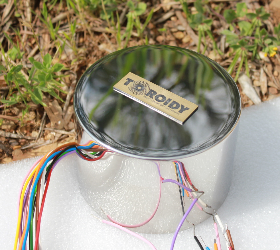

It seem that I have some problems to load the photo of the transformer, therefor I will send it next time, sorry for that 😡

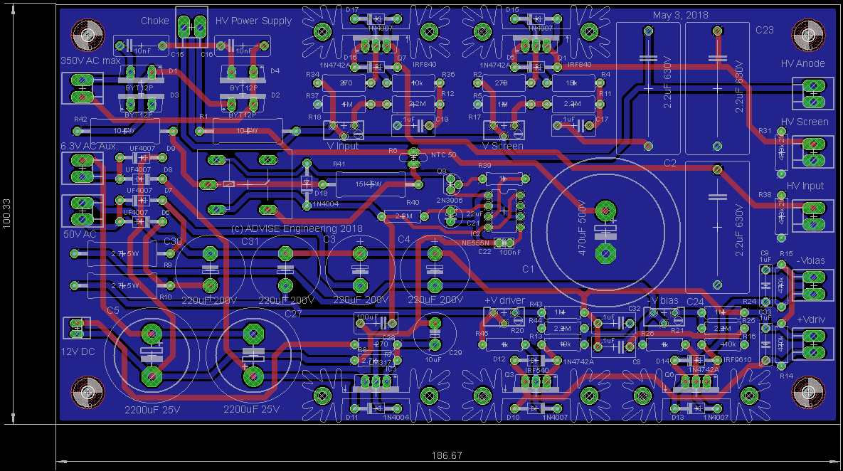

Quad EL34 Baby Huey / TENA Power Supply
Hello everybody,
Sebastien, your English is very good, at least for me 🙂
After the amplifier, I will add now the Power Supply part of the project, as you will see it is mainly based on the nice TENA description... I will use a 250 VA transformer also from TOROIDY which incule all needed voltages : https://sklep.toroidy.pl/en_US/p/TSTA-0250001-Mains-transformer-for-tubes/648
1) 275 V AC or 330 V AC @ 400 mA for the high voltage of 385 V DC or 462 V DC after rectifier (I will use the higher voltage of 460 V, with 60 mA bias x 4 = 240 mA plus the input tubes it should be OK)...
2) 50 V AC @ 100 mA for MOSFET drivers and bias voltage will give about plus & minus140 V DC after the doubler
3) two 6.3 V AC 7 A for heaters which will be connected to a bridge rectifier, a capacitor and a DC/DC switching power supply (may be I will put two connections on the amplifier PCB ?)
4) another 6.3 V AC 2A for the 12 V DC fot the timer (LM555) and for the op amp (LM323)
Of course this power supply will be for only one mono amplifier, anyway the weight of a stereo amplifier should have been excessive 😀 This is also probably why Norman Koren has build two mono blocs !
This Power Supply is not limited to the Quad EL34 Baby Huey / TENA amplifier, in fact it can be used with most tubes amplifier.
All your remarks, suggestions or comments will be appreciated, I hope to build this amplifier during the summer 😎
Marc

So, I am having some issues as well..... My build was coming along well. Everything is assembled and I have tested the heaters which are working fine. As soon as I apply HV the led's start flashing and the power transformer tries to fry itself! I am at a loss as to what to do next....😡
Any ideas as to what could be the issue? It is almost as if there is a short somewhere on the board.....
Help!!!
Help!!!
I have built over 70 tube amps so this is not my first rodeo...... I remember another member having issues with blinking leds.... Was that resolved?
The blinking LED problem was the pin-out of the transistors, see post 2018 😡
See also post 2010 about the wiring of the 50 V AC, even if it is AC it must be connected in the same direction on both boards because one of the input is tied to the ground...
Hope this will help you,
Marc

Flashing leds
1.- Be careful with the 50 V bias AC supply. Although AC, one of the legs at the amp boards are tied to ground so you have to send the same lines from the transformer to the bias connector of each channel. The same cable from the transformer to both right screw and the other cable to both left screw of each amp board. If you wire it wrong, you are shorting to ground the power transformer. Hope you understand.....
2.- Do not use BC547 transistors. They are pin reversed and although being both PNP, the 547 C-E voltage is 45 V and the 2N5551 is 160 V. Another builder built the amp using BC547B with the correct pin order and worked but I imagine that those transistors would not last too much. I think he was going to change to the correct ones 2N5551.
3.- For the heaters is best to use a linear dc PSU, but, if you are going to use a smps, there is one in eflay that is rated 6.3 V and 10 amps for around 41$. I am using it. Take note that when you start the amp, as the filaments are cold, thus PSU does not start full steam, flashes it led until the heaters are warmed and start red. I first thought that there were a problem with mine....
4.- The electrolytic PSU caps of 400 V are IMHO very near their max value. If you are able, change those caps for 500 V changing the capacitance value so they can fit in the boards. I do not remember now correct values for 500 V, maybe Marc can chime in. In my case I could not change it because I ordered the same capacitance but 500 V and those caps do not fit, so I stayed with the 400 V ones.
5.- I also changed the polypropylene caps (3 per board) for 630v ones....
6.- Bias the output tubes correctly, around 50mA. In my case I can not go that low, mine are around 58mA. Less life tube. I can not tell why. This is beyond my electronics knowledge....Also remember that the bias pots are reversed, the left controls the right tube and the other way round.
7.- I have installed two chokes Hammond 159v instead of resistor. I am dealing now with some hum. For me, that resistor is low in ohms and in Watts ( but this is only an opinion based in experience not in knowledge)
YMMV...
Jorge

So it looks like I was also unlucky and had the bc547 installed...... The bias transformer was installed correctly.
I have ordered the 2n5551 and am waiting for them to arrive. Should I replace the Mosfets as well?? What are the chances they are damaged? I also wanted to ask about the ppinout of the mosfets?
Thanks guys!
Thanks guys!
The BC547 is specified at Vceo = 45V max therefor it is not safe to use them in the driver stage even if some people have used them, beside that they must be soldered on the opposite direction of the serigraph ( see post 2018)...
I would recommend to use 2N5551 which have a Vceo = 160V max and have the US 2Nxxx pinout, not the European BCxxx one 🙂
Normally the MOSFET should be OK and the pinout is good, however if you mount them on the bottom side you have to turn them of course...
Rgds,
Marc
Rgds,
Marc
