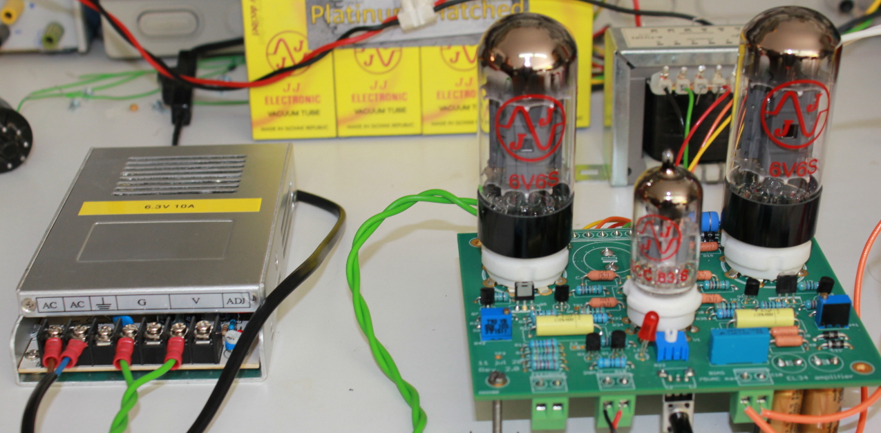

hello group:
I am having trouble with my SMPS. I bought it from China, and was told it would work fine on 120VAC. When testing with no load it works fine. When connected to the heater hook up on the board, it flashes and only produces ~3v. When connected directly to the heater pins on the tube it flashes as well. I have been waiting for a response from the seller, but I suspect it has a compatibility issue. I am wondering if anyone can help me out.
Thanks for the help
Thanks for the help
SMPS for heaters
In case it’s the 6.3 v dc power supply, I had the same issue, led in the PSU flashing and no heaters at all. In my case it’s a matter of waiting until the PSU stabilize because it starts in protection mode due to excess in consumption I was told.
Each time I turn on the amp, the led from the PSU flashes and no heaters lit, but after 30 seconds more or less everything starts correctly and the amp sings beautifully.

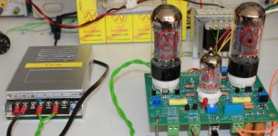

hello group:
Thanks for the help
I’m going to post some pictures later on, hopefully....

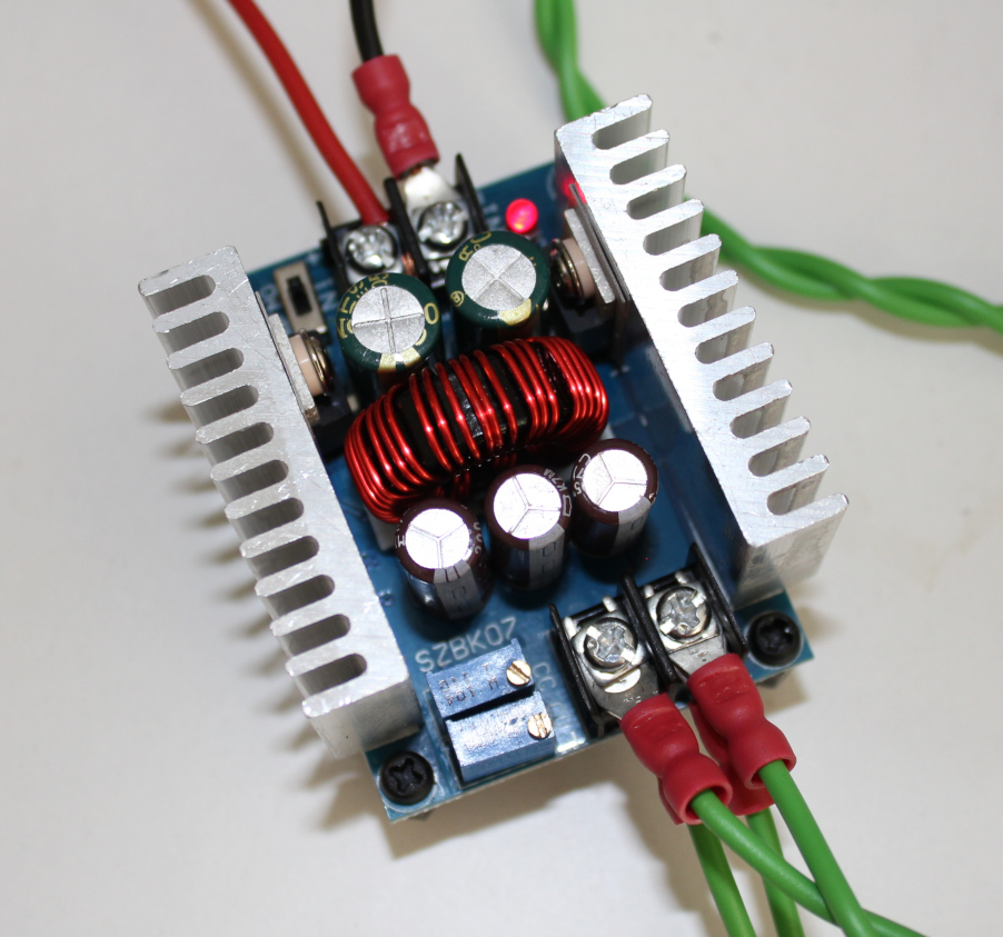

Hello SCD,
Can you give more information about the SMPS that you are using ? The last one that I am using now is a 20 A DC/DC and must be powered from a DC voltage between 10 to 30 V.
The previous one was working without any problem from 230 V AC : Bloc de Chauffage 6,3 V / 10 A Regule pour Ampli a Tubes AL0007 : RADIOELEC : Composants et Modules Electroniques, specialiste Audiophiles et Radioamateurs (sorry it is in french, but it came also from China). You can see it in a picture below with 6V6 tubes...
Today I am using the small 20 A DC/DC converter powered by the two 6.3 V output in serial (12.6 V AC rectified and filtered by a 10'000 uF capacitor) of the power transformer TSTA 250-001 ( TSTA 250/001 TOROIDY - Transformateur: toroidal audio | TME - Composants electroniques ) from Toroidy which give all the voltages needed by the EL34 Baby Huey (see picture) 🙂

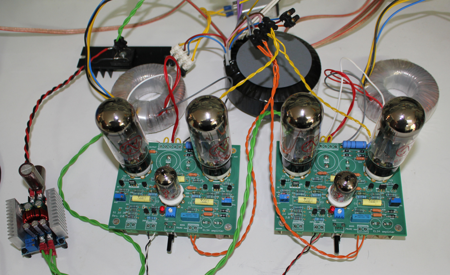

Thanks Marc and all others whom has contributed to this project, my amp fire up for the first time today, no hum at all. Its playing Carpenters now !
Will let it run for couple of days and crank up the bias...
Both channels are up and running, configured as Ultralinear mode using Toroidy's EL34 output and main transformers. Heaters line are using 6.3Vac direct, hum is very very soft when i place my ear at the speakers. Max output @14V rms = about 25 Watts , just before 1 kHz signal clips.
Musically clear and sweet, but a bit lacking on bass, will the bass response better if i increase C1,C2 to higher values like 0.47 uF ?

Hello Ivan,
Glad to hear that you like the EL34 Baby Huey 🙂
If you are using the Toroidy TSTA 259-001 like me, you can connect the two 6.3 V AC output in serial, add a 25 A bridge and a 10'000 uF capacitor to get about 16 V DC and use a 20 A (for enough margin...) Chinese DC/DC converter adjusted for 6.3 V DC and you will have no hum (see pictures) 😀
Yes you can increase C1 & C2, but I don't think you will need 047 uF, I have used 0.1 and 0.22 uF with very good result... For the output transformer, the Toroidy KT88 has a lower 4k ohms impedance closer to the 4.3k Hammond 1650N that I am using, may be that make a difference on bass ?

This is the reference of the converter : SZBK07, you cand find it here : DC 6-40V To 1.2-36V 300W 20A Constant Current Adjustable Buck Converter Step Down Module Board With Short Circuit Protection Function Sale - Banggood.com
For the bridge you can use GBPC 3504 (2504 will also do the job...) https://www.mouser.fr/ProductDetail...rchild/GBPC3504?qs=j%2bucPx4PkG58AqaSQMi2kg==
And a 10'000 uF 25 V will improve the DC signal for the converter https://www.mouser.fr/ProductDetail...=sGAEpiMZZMtZ1n0r9vR22QGha91sM8wWNZkhl3x0Ljw=
Bias @ 45 mA is good for EL34, you can go up to 60 mA if you have less than 400 V ( about 24 W, close to the 25 W specification !) JJ Electronic - EL34
