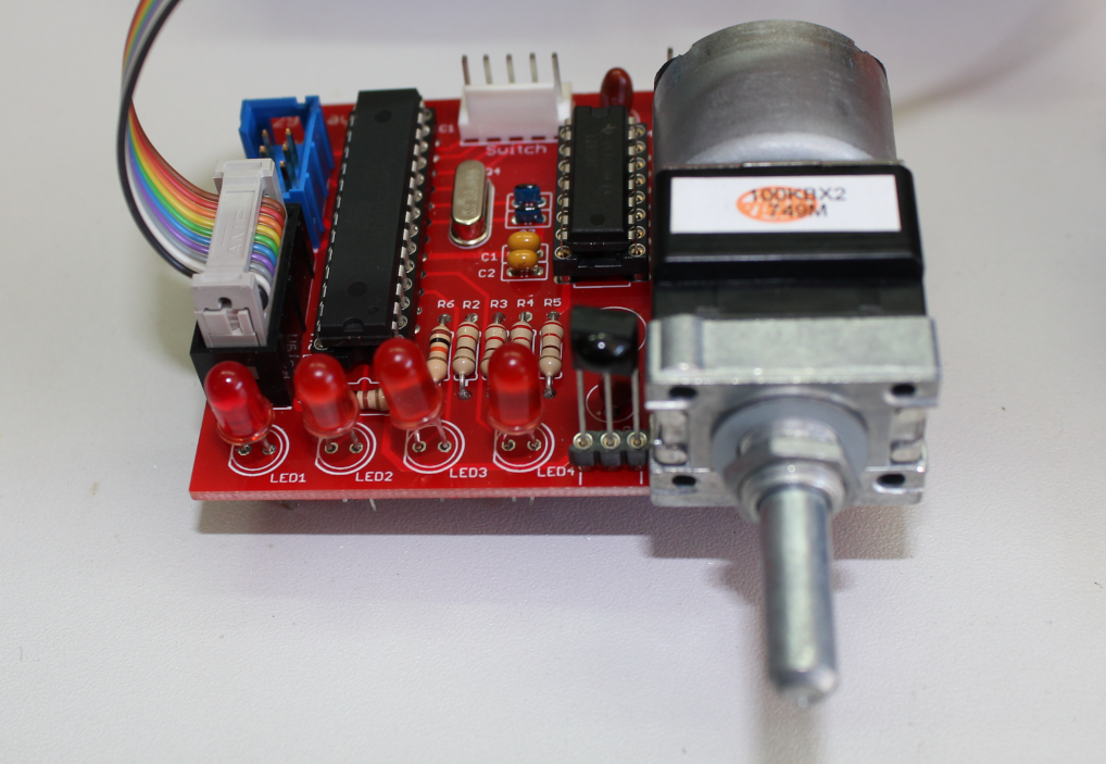

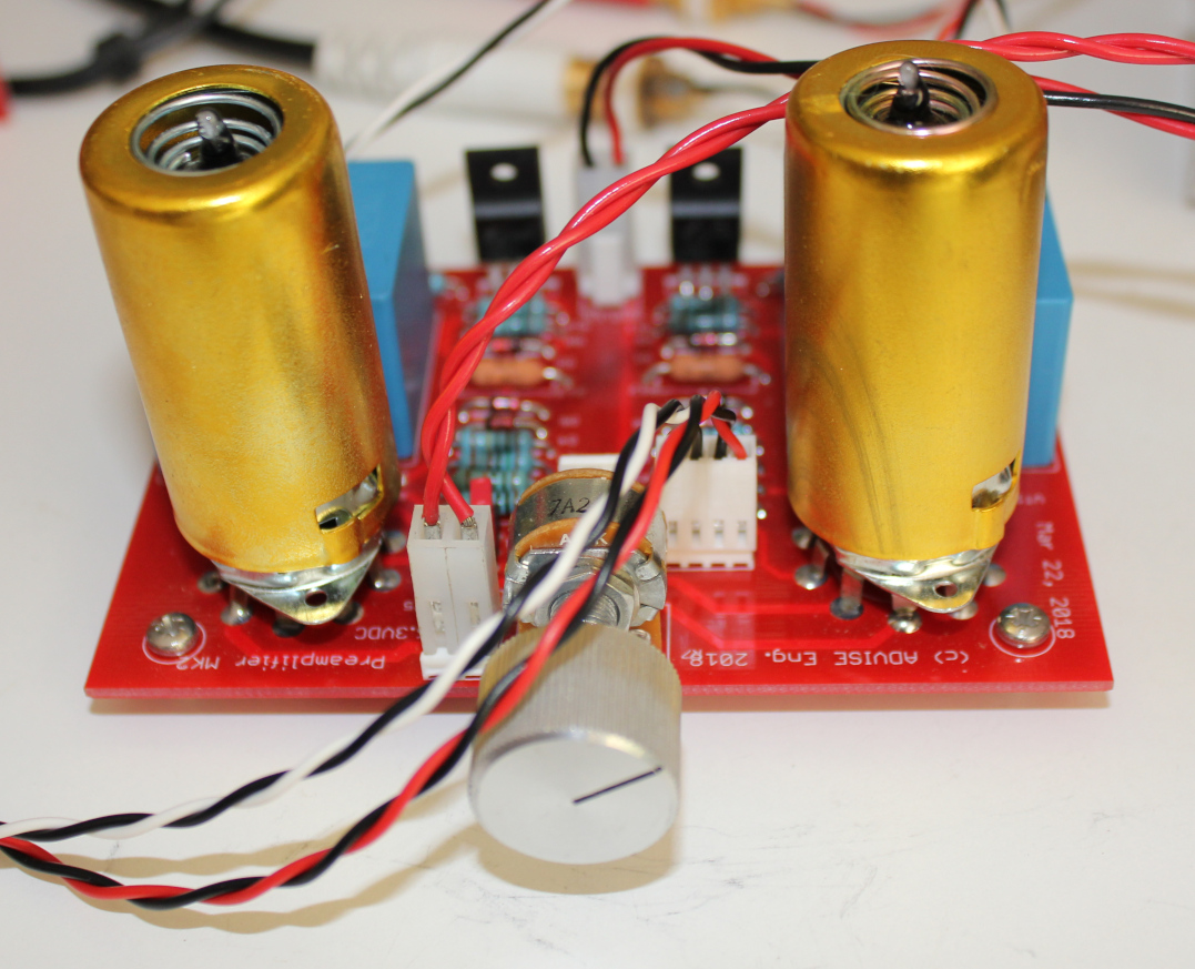

R7/1 and R7/2 are not trimmer but volume pot, any value between 20 k to 50 k log will be OK. Please note that there is two possibilities : on board pot or external motorized pot (see pictures)...

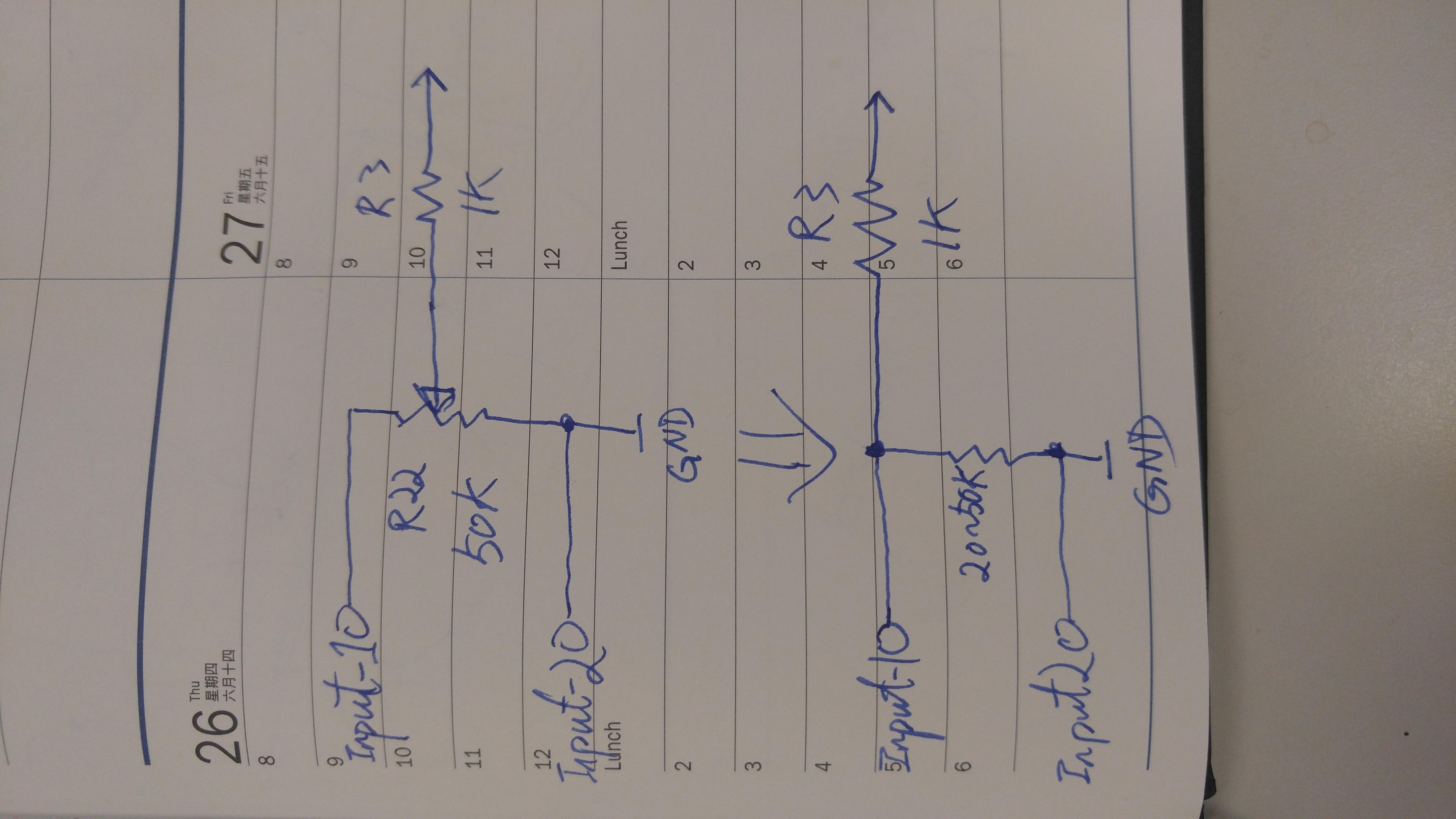

If i have standalone preamp as the 10 times voltage with vol control. Then how can i modify this pot so i only use it as power amp purpose ? Shoul i bypass it or replace with the fixed value resistor ?

Hi ckwong99,
You can leave the pot and use it like a level trimmer to adjust both channel at the maximum value or close to that if you need to correct the balance between the channels.
Of course, you can also replace it with a 20 to 50 k resistor between the GND and the cursor pad, you will also need to connect the cursor pad to the input pad with a wire to use the input connector.
NOTA : for the third GB the input pot has already been replaced by a resistor 🙂

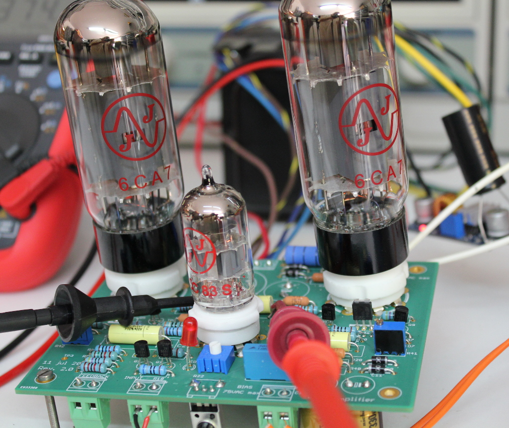

Hello again:
I have been slowly working on my BH project and seem to be at a place where I do not know what to do.
I have stuffed the boards and got the power supplies sorted out. The heaters power up properly.
I am trying to adjust the bias and that is the problem. I installed a set of older 6v6 tubes to do the testing.
My bias reads 450ma on one output tube and 860ma on the other. The trim pot does not change anything.
Could some one familiar with the board check my work and provide me with some guidance.

Hi Scott,
May be your problem of bias is caused by the value of R39, as explained in my post 2078, this value is too high for 50 V AC or less, I suggested to use 18 k or even 15 k instead of 33 k as you have on your picture 😱
To avoid this problem for future builders, I have added an updated BOM in this post 🙂

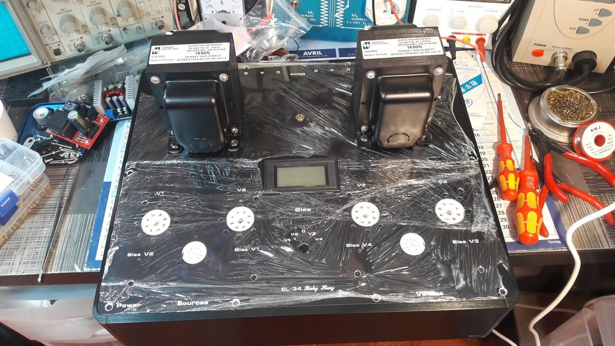

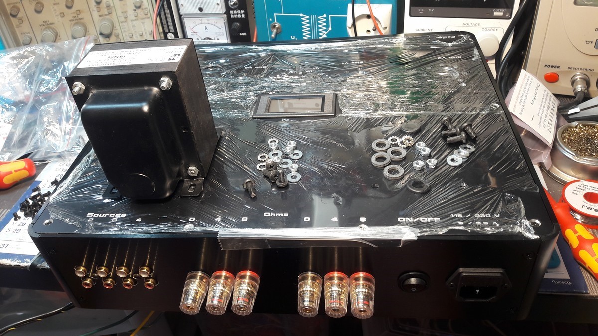

My EL34 Baby Huey will have its home soon, thanks to my friend Philippe that is doing the hard mechanical work that I am not able to do myself 😉 The top cover has been made by Front Panel Express, expensive but very good quality, the front and rear panels are made by Philippe, here are two pictures of the work, next step the front panel with two vu-meters !
