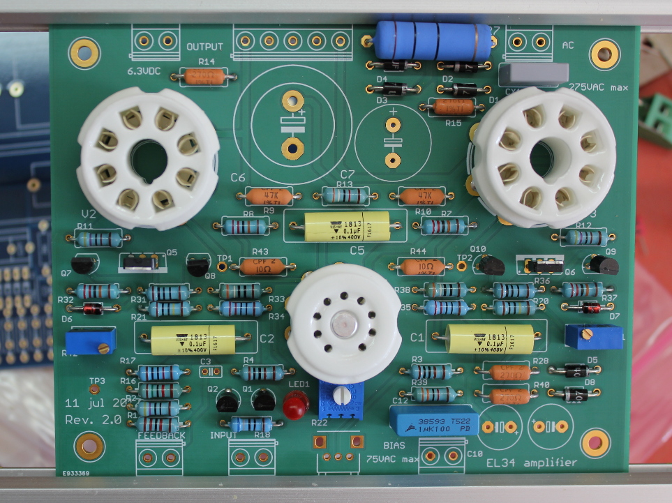

My EL34 Baby Huey will have its home soon, thanks to my friend Philippe that is doing the hard mechanical work that I am not able to do myself 😉 The top cover has been made by Front Panel Express, expensive but very good quality, the front and rear panels are made by Philippe, here are two pictures of the work, next step the front panel with two vu-meters !

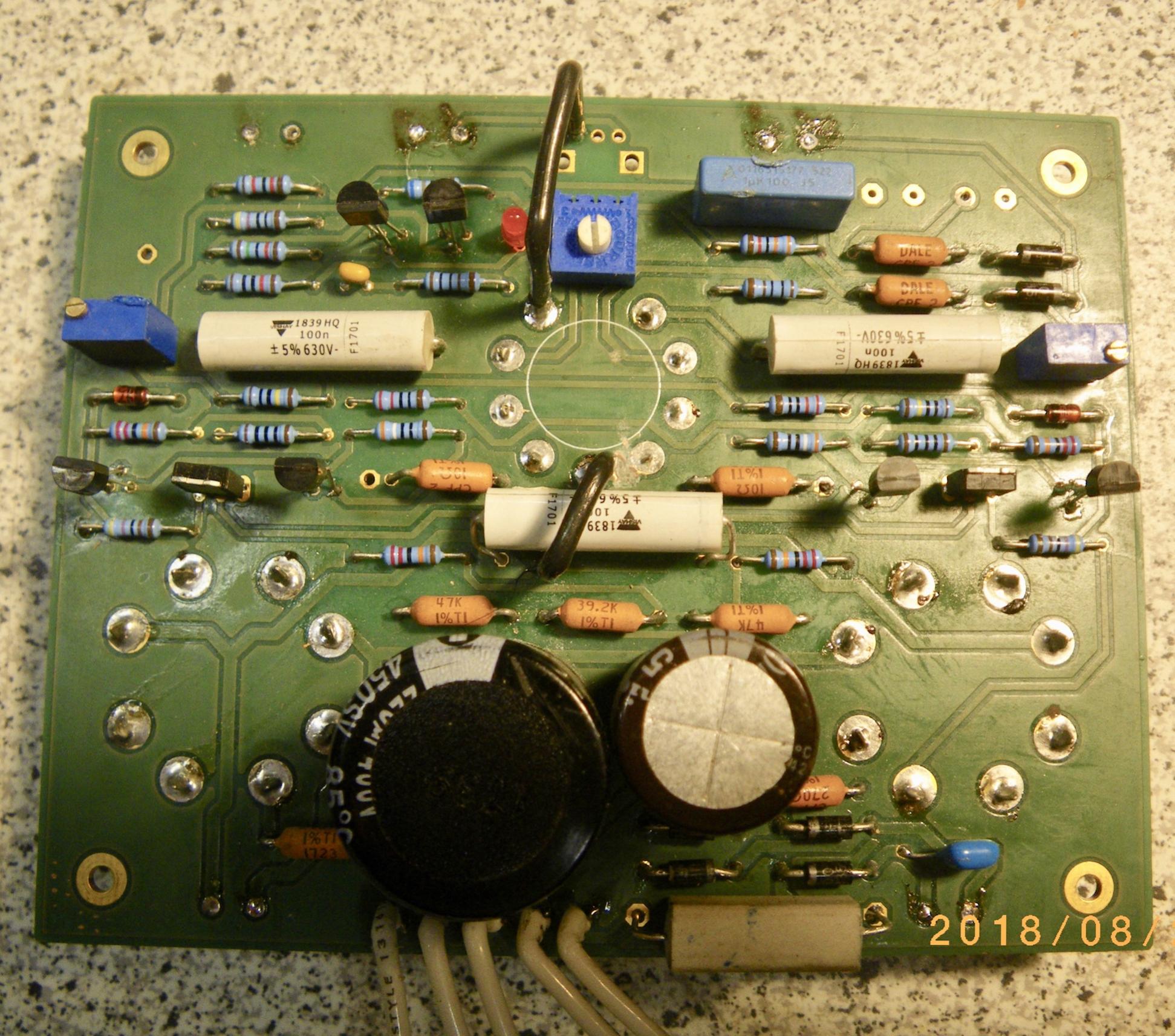

I added a second 33k resistor to R39.
my meter readings are 880mv and 450mv for the test points. My bias input voltage is 60vac.
I do not think this is the solution to the problem.
I am wondering if I have the mosfets (Q5, Q6) in backwards?
Could you look at the photo of my board again to double check things.

A silk screen would have been useful to show which way around the transistors go.
I usually use a straight line to indicate the front of the transistor.
Yes Nigel:
In order to mount the board to the chassis top panel and have access to the components I decided to load the board from the back. This has caused me a great deal of confusion, with a little help I should be able to get it sorted out.

Sorry that this does not help, in fact the negative voltage is more critical with EL34, 6CA7 or KT88... For 6V6 a bias of -15 V is enough ( JJ Electronic - 6V6S ), therefor if you have 60 V AC, this mean that you should have about 80 V DC after the capacitor and it is more than enough.

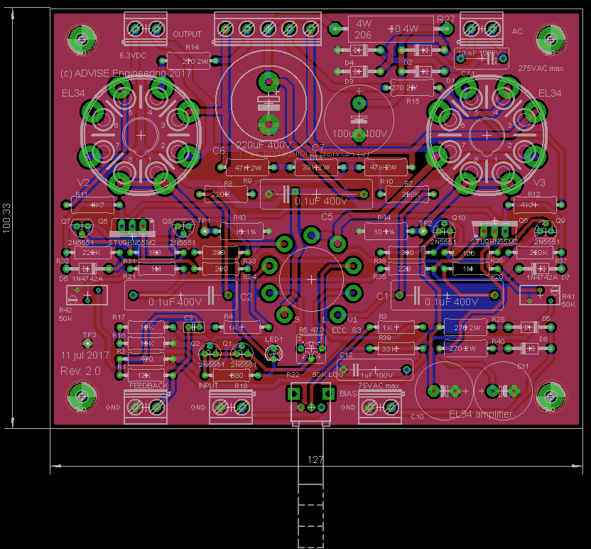

Now you will have to use your multi-meter and check the voltage on the output of R39, on the cursor of the two trimmers and finally on R11 and R12 where you should read between - 12 V and - 15 V... Try to adjust the trimmers to see the effect and don't forget that trimmer are on opposite side than test points (see attachement) 😕

nigelwright7557,
The silk screen exist of course, it is on the top side, see picture 😀

Thanks Marc:
the voltage between r39 and tp3 is -17.6 in and -7.6out
the voltage between r11 and tp3 is -23.5
the voltage between r12 and tp3 is -5.6
wiper on r41 is 0.0, turning does not change value
wiper on r42 is -7.0,turning changes value
when measuring across the pins of the trimmers I get 25k rather than 50k as indicated on the packaging of the trimmer. Could this be the problem. I am thinking I got faulty trimmers??

As a note I also had the BC547B transistors. I did not catch it till after i was testing .I replaced these perhaps the trimmers were damaged during that testing?
I decided to order the trim pots, the zener diodes, and the mosfets.
My initial testing with the BC547B transistors is likely the source of the trouble.

The voltage between R28 and R39 (Vbias on the schematic) should be about -80 V !
There is something wrong on your board, may be a cold solder ?
Beside that the BC547B will not survive at 80 V and the pinout is not compatible with the 2N5551, see post 2018 which explain the problem already found by papavienneau... 🙁
