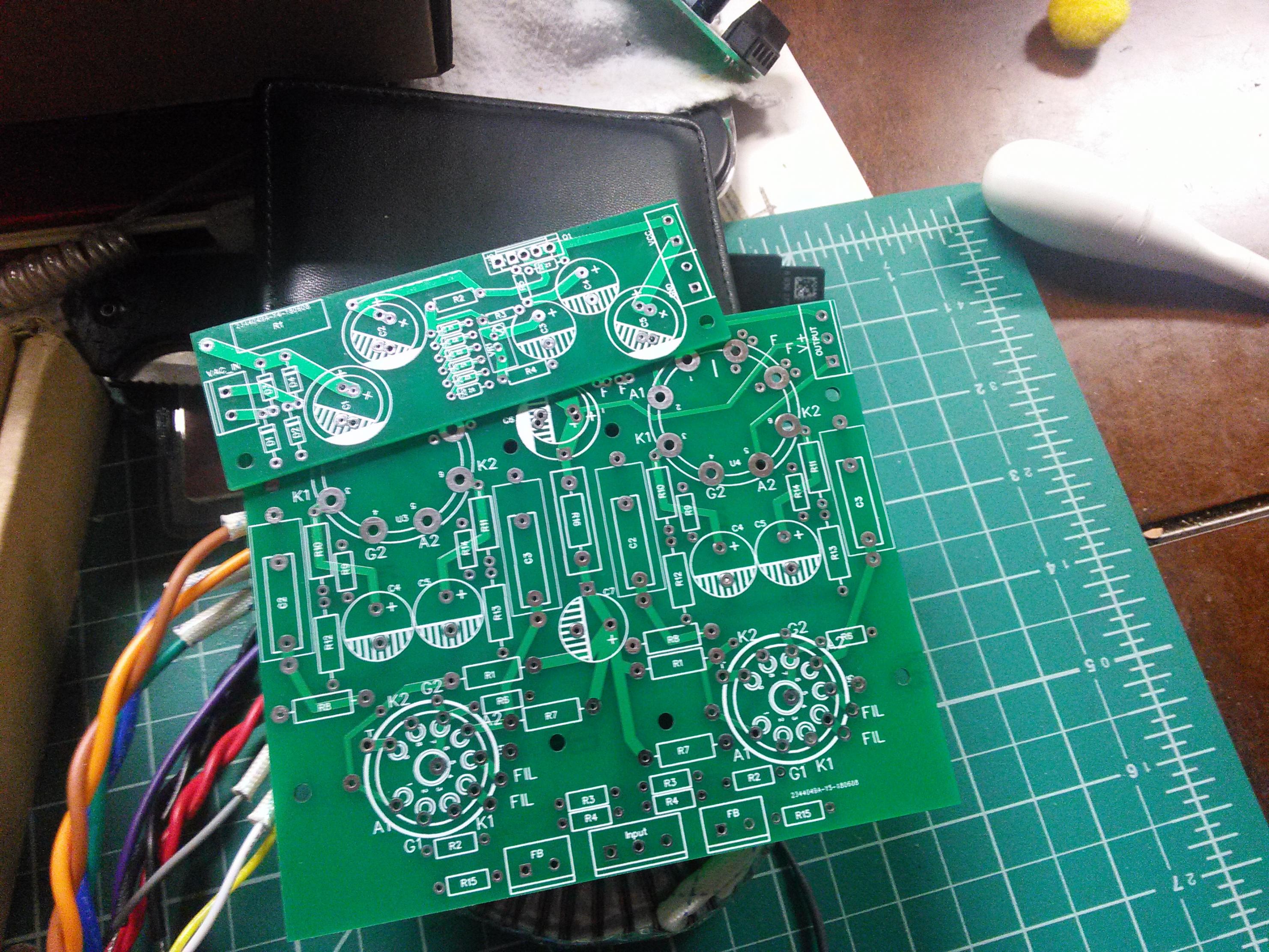

My flea amplifier prototype PCBs from them are very nice!

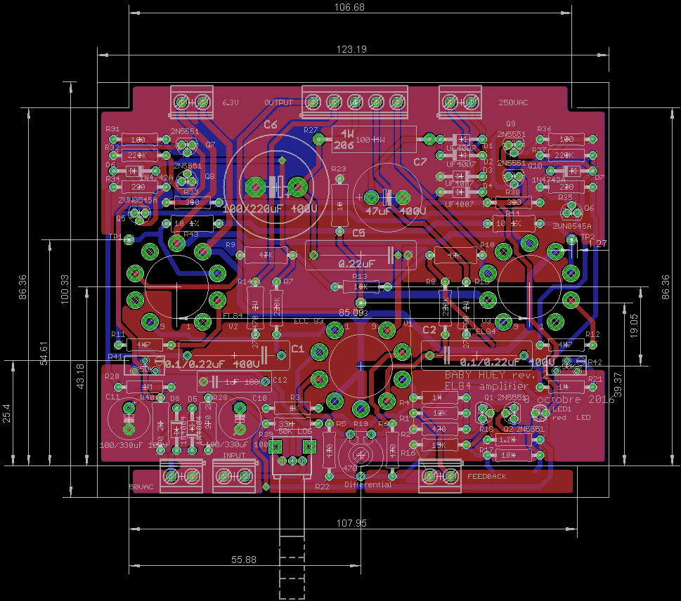

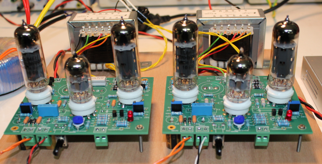

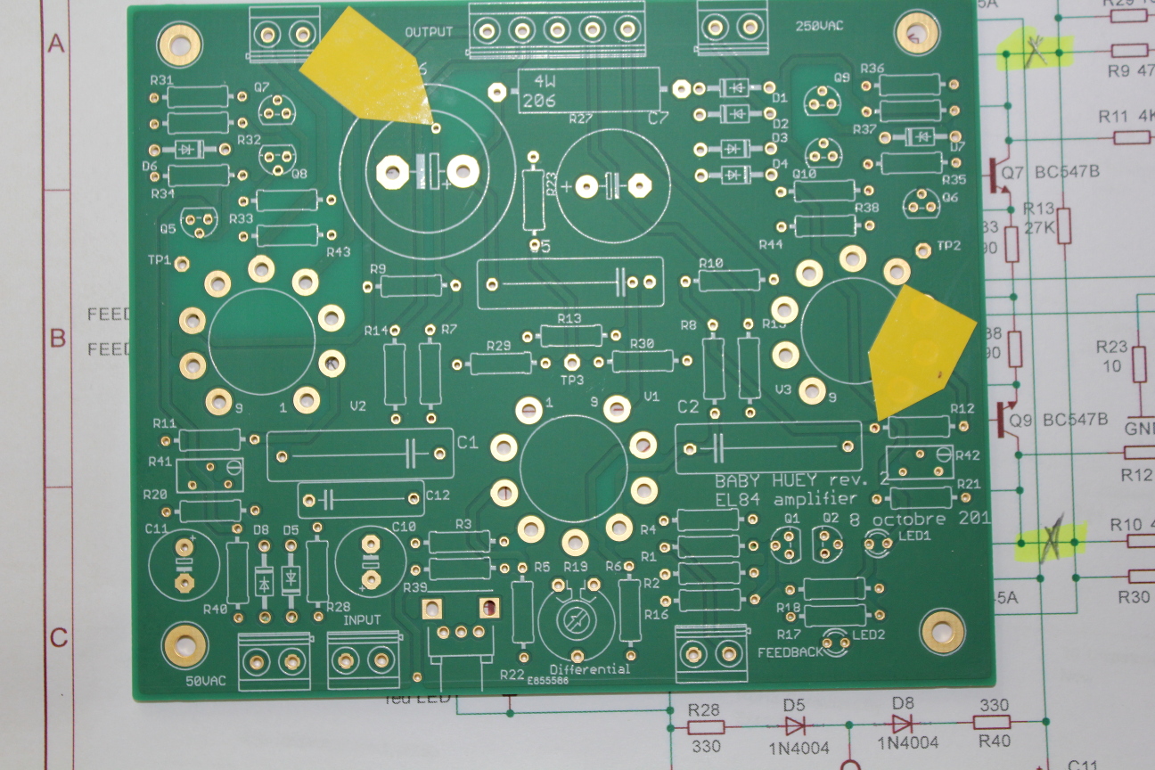

I have made a standard EL84 Baby Huey, but it was not my best PCB :mad: I made two mistakes in the design, even if they were easily corrected, I didn't produce more than 10 boards before moving to the EL34 Baby Huey :) I have added the schema and some pictures to give an idea of the board therefor you can compare with the EL34 version. Today if I had to redesign this PCB I would use the EL34 PCB and replace the octal socket by a 9-pin socket :cool:
In fact it is exactly the same schema as described by gingertube, but I made a much better layout for the octal socket version and it is always possible to use an octal to 9-pin adapter if you want to test some EL84, of course there will be some resistor value to change. I add the schema if you want to try, you can use two of the latest EL34 Baby Huey PCB available from Prasi :D
