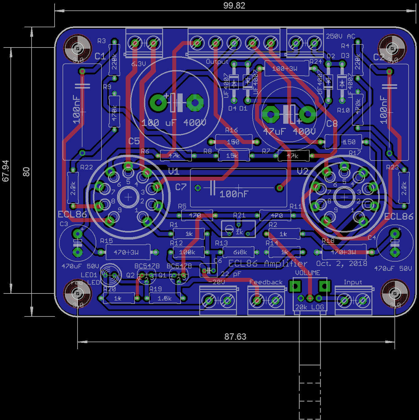

Marc,
Quick question? On the ECL/PCL86 version of the amp, where are the measurements points when adjusting the 1kOhm variable resistor?
Regards
Polycell
Regards
Polycell
Hi Polycell,
Sorry for the late answer, I have missed your question 😱
The 1k trimmer will adjust the bias of the two input triodes and to be fully balanced the voltage of both triodes plates (pin 9) must be the same therefor you need to adjust the trimmer to have 0 VDC between the two anodes !
Some time it is easier to connect the probes to the input of C1 and C2 🙂
For your convenience I have added the last schema and PCB of the ECL86 / PCL86 Baby Huey.
Best regards,
Marc

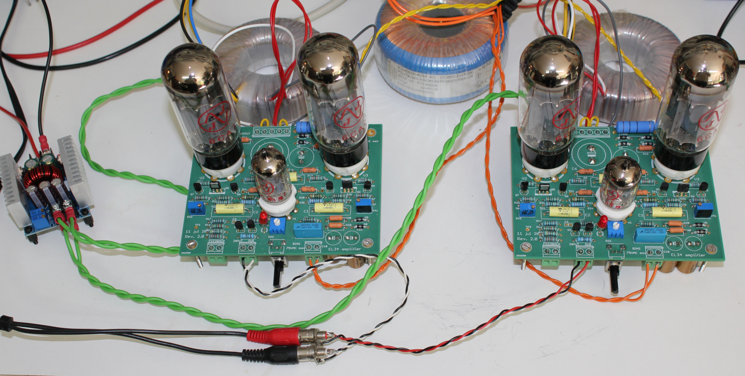

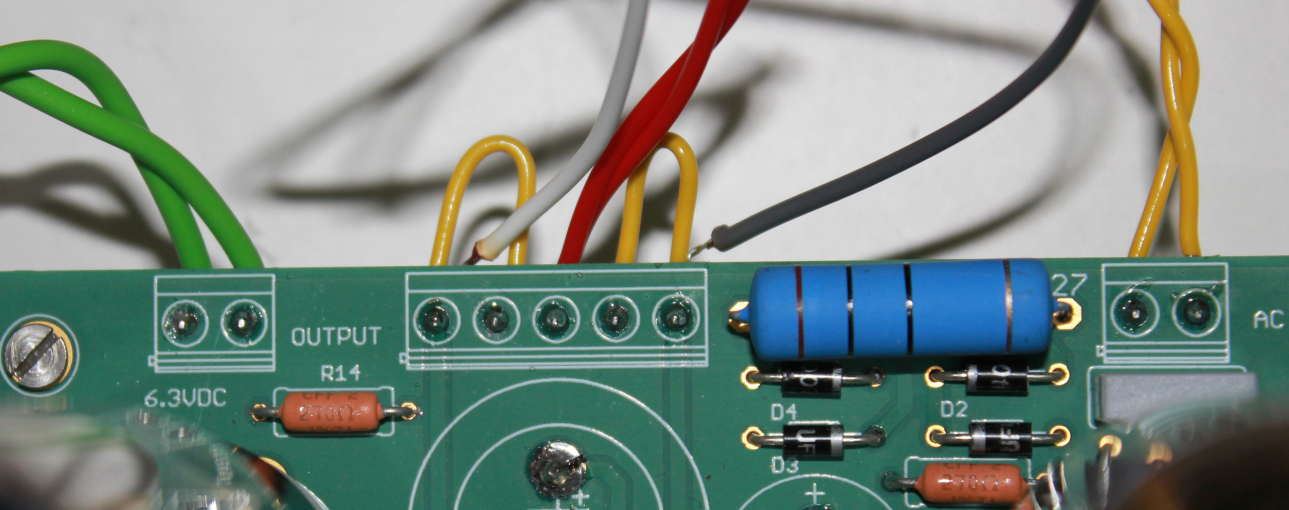

where can i buy pcb? I need just mono, one pcb and driver should be 2x 6sn7. ecc 83 is not great driver for push pull el34.
Loaded question aside, what you are asking for is sufficiently different enough that you may wish to start a separate thread, as that's a different enough design that it doesn't really belong here. This is a pretty well laid out design that becomes something else entirely when doing what you propose.
The PCBs were purchased through Group buys - unfortunately one just concluded. The kind organizer (Prasi) of the GB has some EL34 boards left, but the EL84 boards are all spoken for. Perhaps folks who bought multiple boards would be willing to sell you a pair. The GB price per pair was around US$30.
See post #792:
GB for Baby Huey PCB
Regarding your transformers - hopefully the experts could advise you better, but if it were me I would sell those and get a pair of UL transformers. (Why change a proven design into something else by using different transformers?)
See post #792:

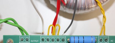

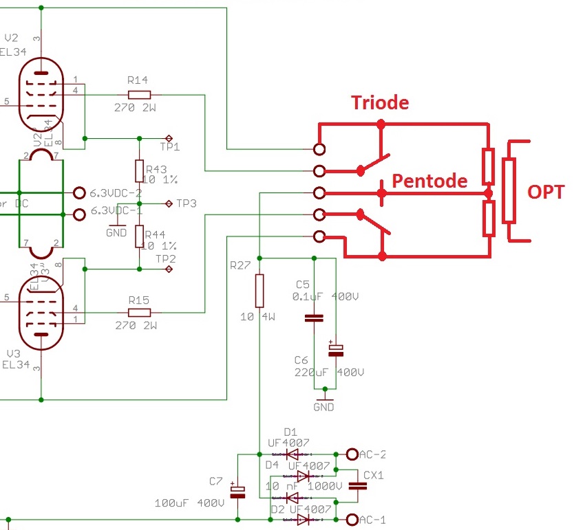

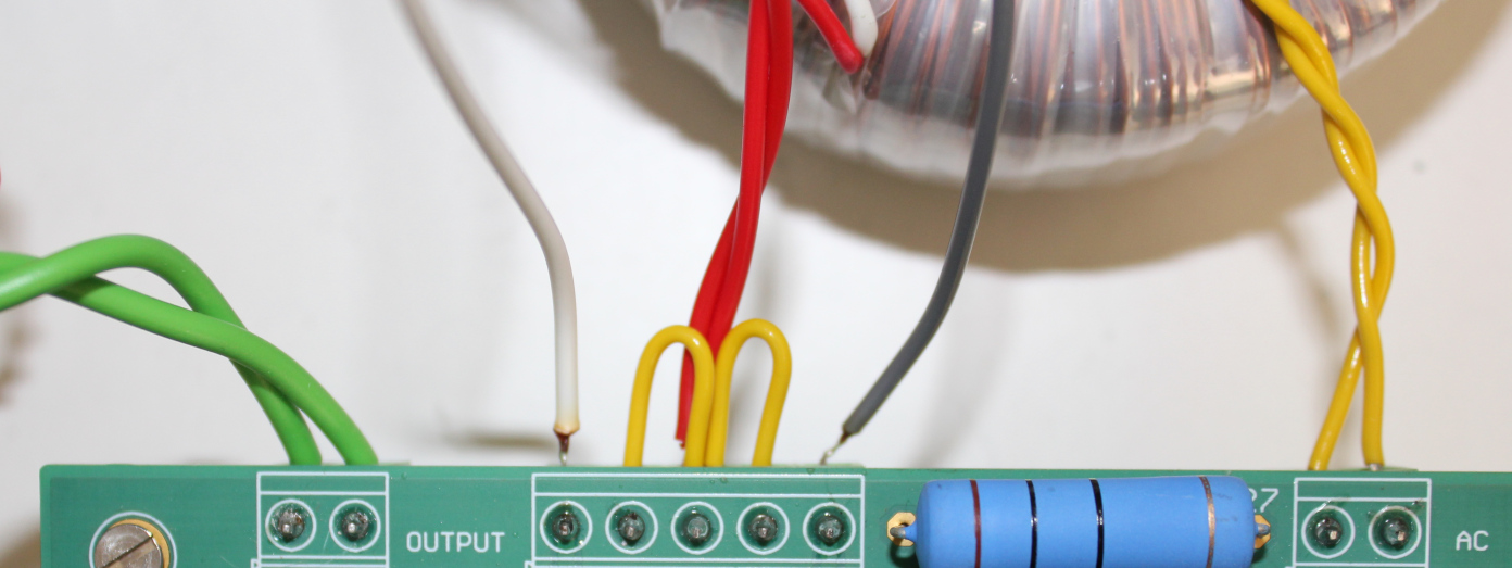

Hi snapper,
You don't need an EL84 board because the 4k primary transformer will be perfect for the EL34 Baby Huey PCB and you are lucky, there are still some available in the GB 🙂
Second good news : you don't need to change anythings on the PCB, you just need to connect the screen to the plate (triode mode) or to the high voltage (pentode mode), it work perfectly, I have done it, see photos
You can also read posts 2071, 73, 74 and 75 about this subject EL84 Amp - Baby Huey 😀
There is also a lot of informations here : EL34 Baby Huey Amplifier
Rgds,
Marc
Rgds,
Marc
