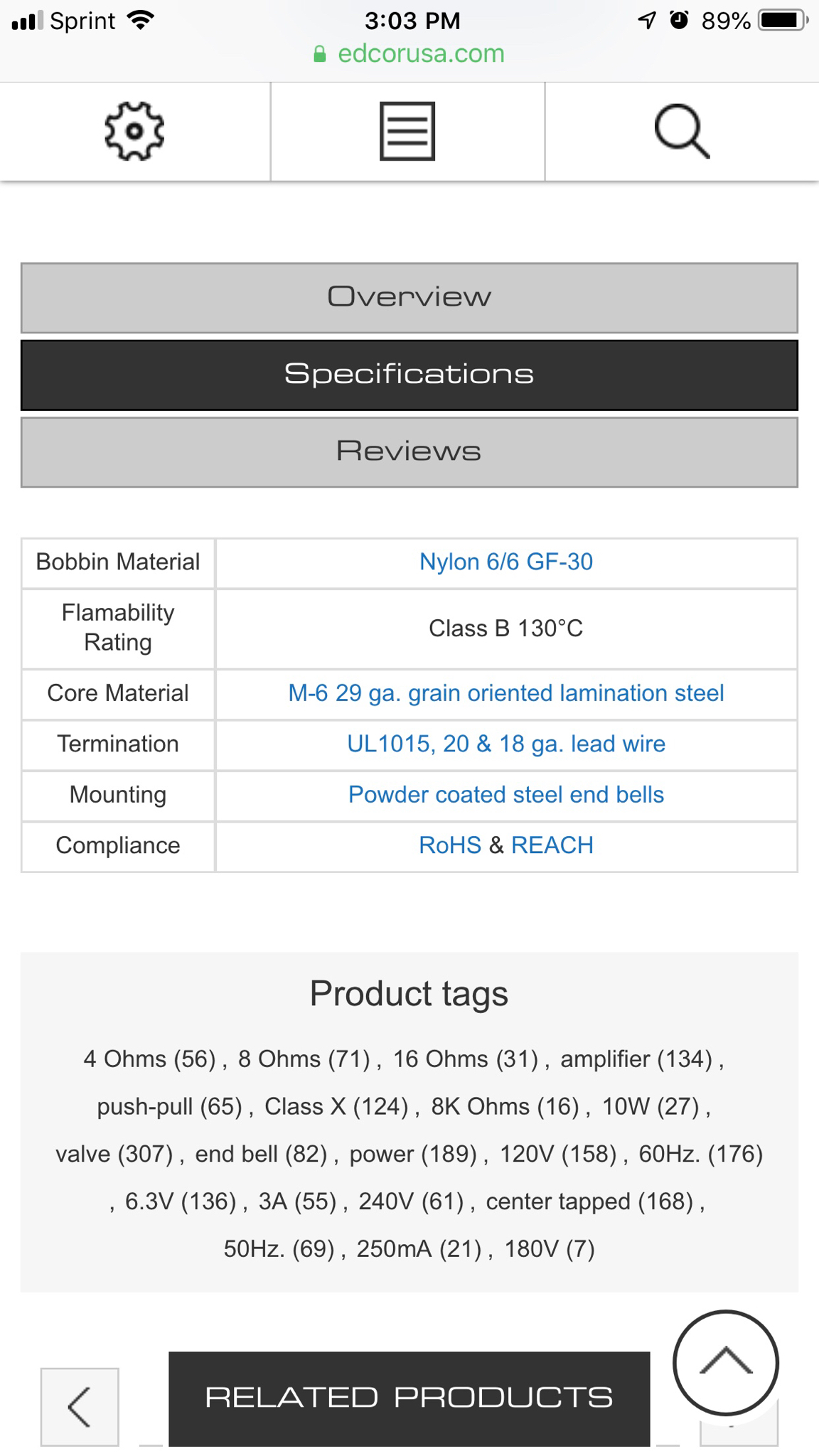

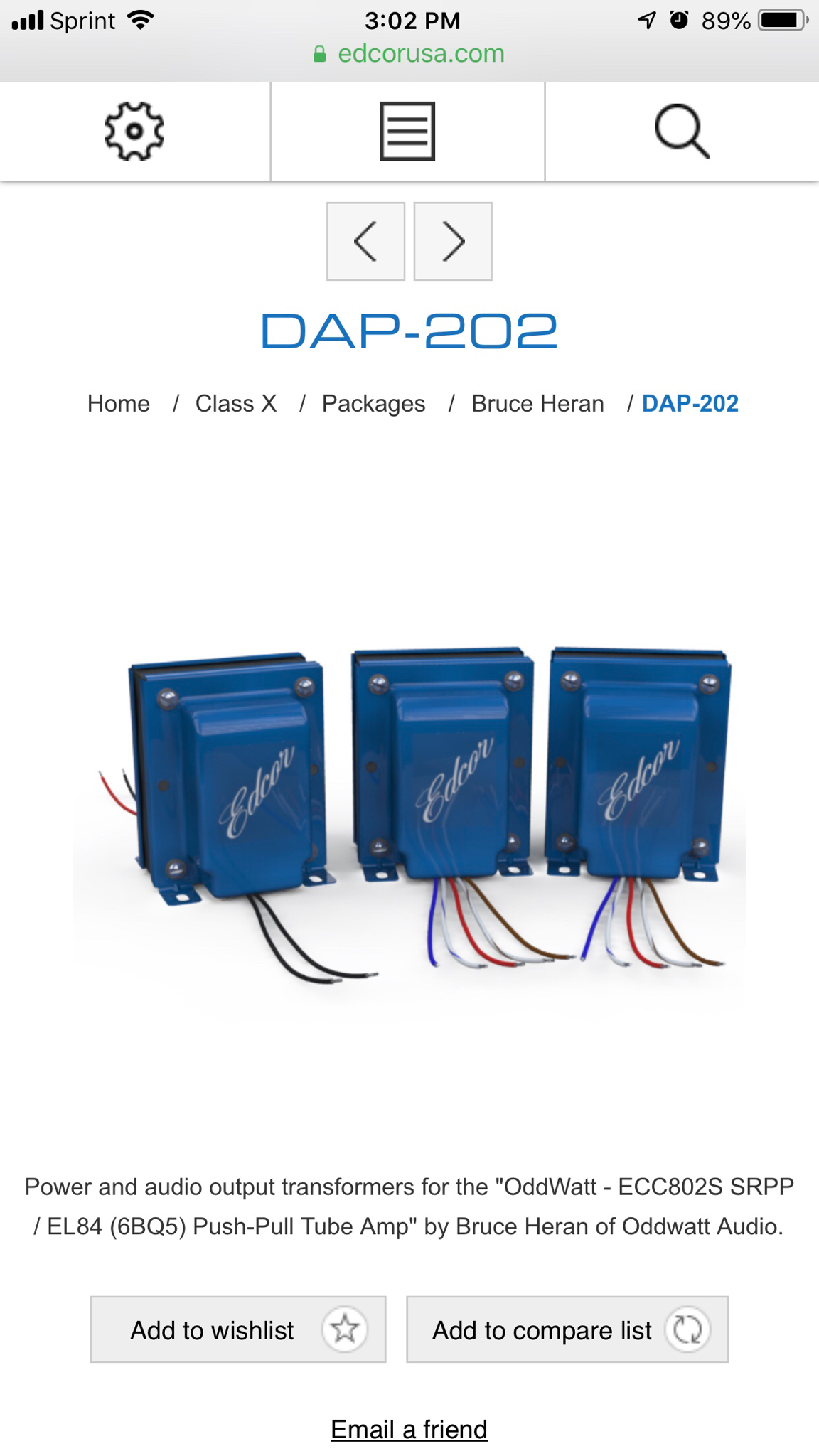

Would these transformers work for the Baby Huey EL84 pcb boards from the group buy in the DIY fourm
EDCOR - DAP-202
EDCOR - DAP-202
The output transformers will work fine, but I have doubts about the power transformer’s ability to heat the tubeset, provide sufficient voltage and lacks a supply for the bias supply.
1. The EL84 Baby Huey heaters require 4x760 ma (EL84), plus 2x300 ma for a total of 3.64 amp at 6.3v. The Edcor spec says 3 A @ 6.3v. However, that is exactly what the OddWatt amp requires and the transformer was specified for it.
2. The EL84 BH will probably work with a 180 VAC transformer, but the better transformer is one that provides around 230 VAC.
3. If you can’t find a power transformer that includes around 50 vac for the bias supply, you could add a separate small transformer.
I suggest your read post #226 and what follows beyond that on the topic of Power transformers. Marc suggested an inexpensive solution using separate transformers. My personal choice for a single transformer will probably be this Edcor power transformer, but observe Marc’s caution about using it. EDCOR - XPWR078
Hope this helps.

Thank you. I will see if they have them with those power specs.

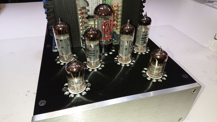

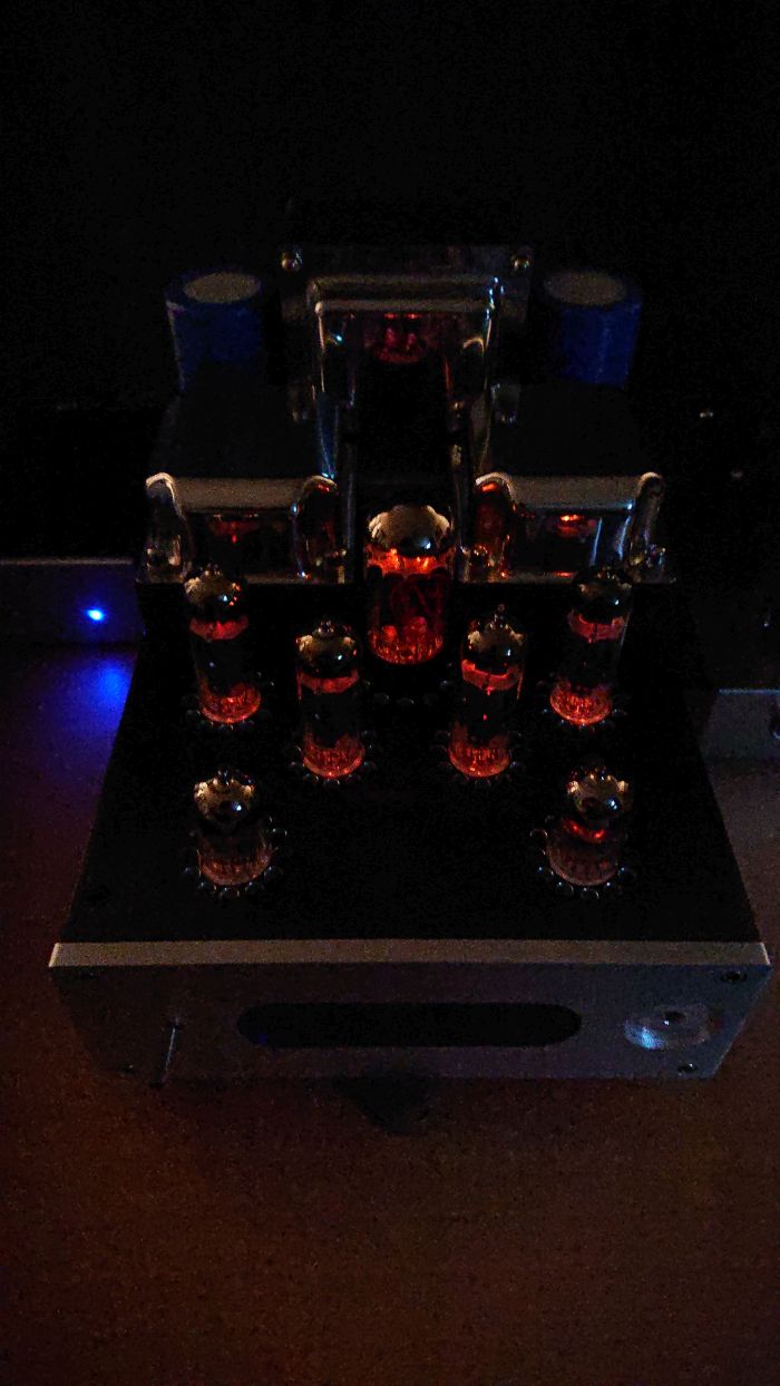

Hi all,
fired my BH up some days ago. No smoke, wonder that 😀. Some building details and pictures here. Gingertube somewhere wrote "never chose a small case". Da**ed, haven't read it in time 🙄. Now I can really feel with him regarding the pain ...
I wanted to realize a tube rectification with 5AR4, as I already had a PT with 2x 250V / 2x 350V. Result: first voltage too low, second too high, even after the 10H choke. Trials with resistors etc. in the B+, giving a RCLC, leaded all in all to the following experience: Sounds like crap.
So I switched back to the lower rails, resulting in roughly 300V B+, 260V plate. I switched R16 (is it 16? Don't have the schematics here at present) at the bottom of the CCS from 560R to a trimmer to get the anode voltage of the ECC83 up to 160 V. 140 V sounded a little bit "tired". Value of the resistor would now roughly be 1,3k. That will be changed back to a fixed resistor afterwards. Current is equal on both sides.
What takes me wonder is the Bias for the EL84: 38mA? Sounds quite high to me? I'm definetely not an expert, but even all calculators or webpages from other guys are talking about 21-30 mA, depending on the B+?! Before having a set of fried tubes lying on the bench, I went somewhat lower.
Measurements done (rounded):
Signals are now looking almost perfect, see Sinus left/right in comparison and as an overlay. Even more important: sounds really good with values like above! Haven't had so much time to listen yet, but even now I'm really impressed.
Any comments / suggestions on this?

Officially, EL84 in a push-pull configuration can take up to 300V on their plates and 40mA per tube (making 80mA for the pair) in bias current.
These are the datasheet values which are safe for the tubes.
Most Hifi & guitar amp makers in the heyday of tubes ran the EL84 in excess of that. They can take some abuse on some parameters if you respect the total power envelope in the long term.
For me, your bias around 20mA is a bit low. I would go to 40mA per tube, as your anode voltage is lower than 300V.
Yves

Thanks a lot for your comments, highly appreciated!

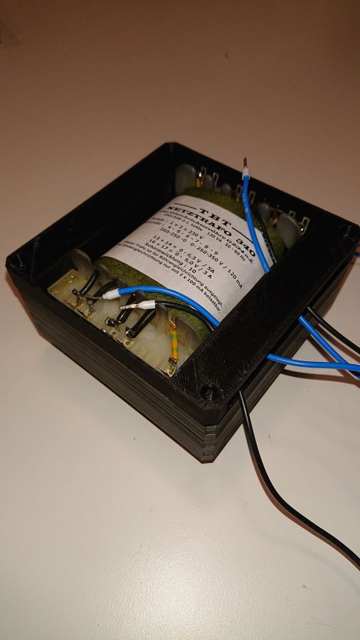

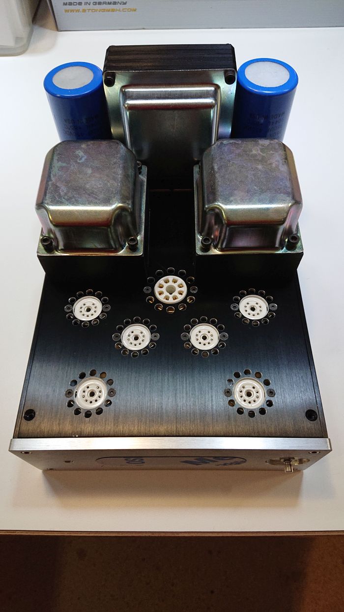

For sure. Here's a short list:
The rest is more or less what is described in this thread, despite the resistors. Whereever possible I use Carbonite resistors. I like them more than MOX or metal film. Only in areas with higher wattage metal-R are used.
Due to the lack of space I had to build in a "second floor". Maybe you can see the base, where the toroid is mounted on? That's a FR4 board, copper on the bottom and connected to earth. Underneath are the connectors for the OPT, the fuses for the 5AR4 (one 250 mA fuse on each primary, followed by a UF4007 to prevent backfire from the carburetor 🙄)
What else? The covers on the trannies as well as the parts like mentioned above have been bought at Frag Jan zuerst --- Ask Jan First. The toolmaker inside could not let the covers look like delivered, so they got polished.
For the PT I had to tweak a little bit to get the cover on the connection side without building an automatic fuse-blower. For that I designed a kind of spacer and printed it on my 3D-Printer. Electrical connection of the isolated part to earth then was done by an extra wire on the bottom.
As I have several things I like to do after work, I prefer to repair or rework the stuff sold on the net (slight traces of usage 😀) as well as DIY. For sure there's more to Baby Huey with f.e. expensive Iron, but for now I'm really satisfied!
Abbendum: A lot of 4 Reflektor 6P19P-EV is on the fly to me / to my BH. Looking forward to it!
Best regards from the basement!
Ingo

- Soft-Start for Torodial
(right upper corner) - 6A Diode, 48V Relais, a few resistors - nothing uncommon.

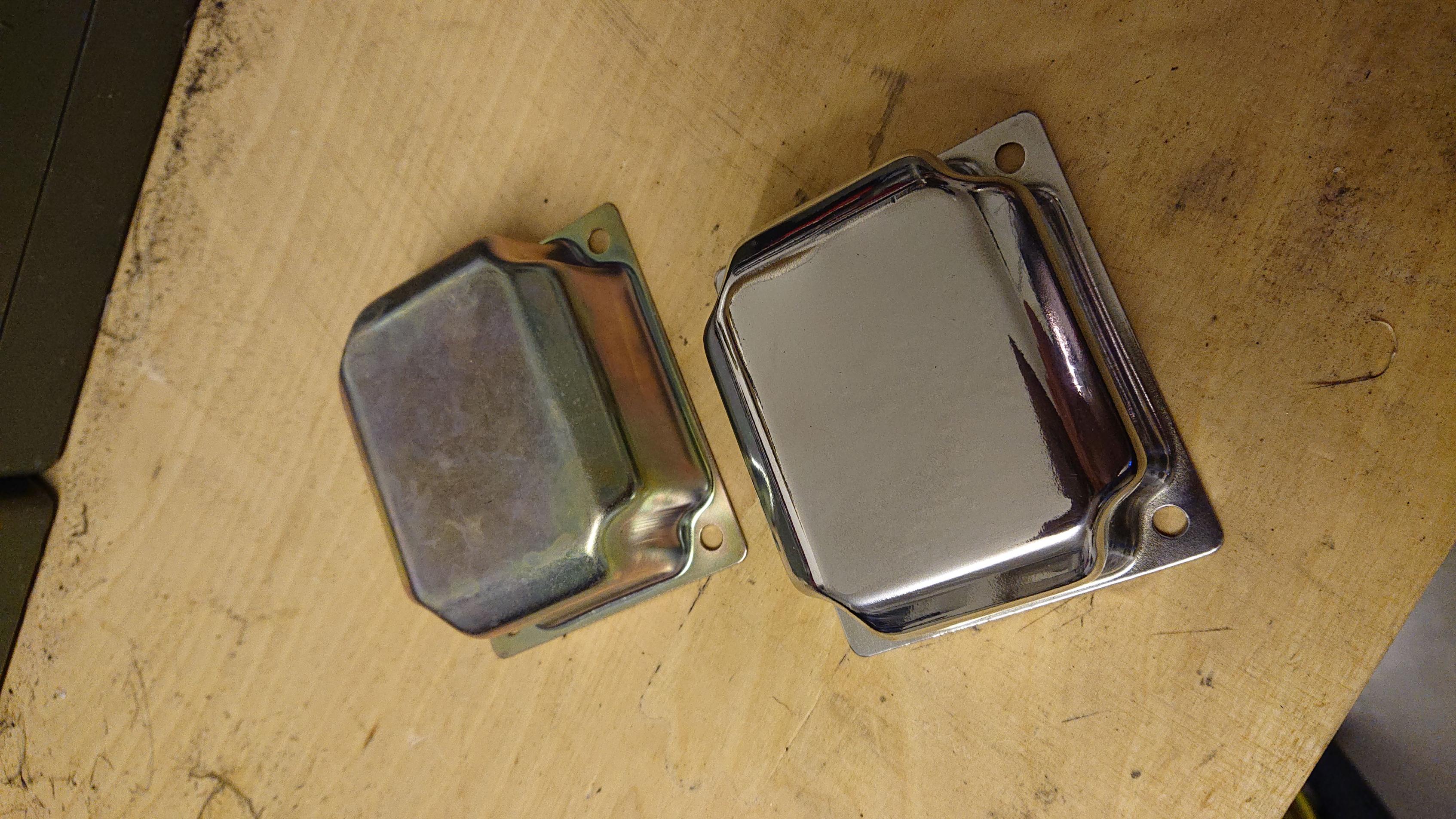

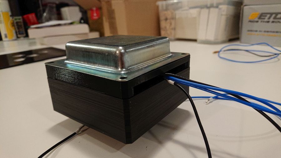

Ingo
