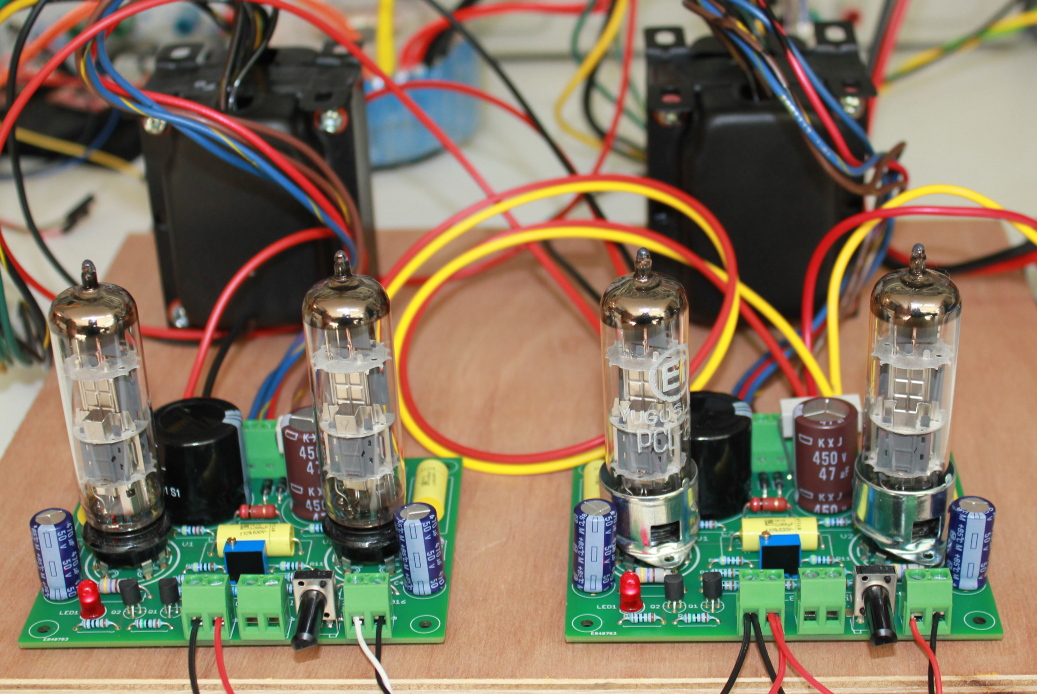

Marc,
I've built one channel of the ECL86/PCL86 version of the baby huey and it's working ok but voices (when anyone says 'S') sound overstated (if that makes sense). I've tried different speakers, triode and pentode modes but it makes no difference. I'm wondering if it's the OPT'S I'm using which are Toroidy 10K push-pull for the ECL86. Any ideas that can help would be great.
Regards

Hi polycell,
Sorry to have missed your post, sent more than one month ago, again :mad:
It is not an excuse but I was also on Holidays and I inform EL34 Baby Huey forum about that, but didn't check EL84 forum...
Your problem should not come from the 10k output transformer, I have used a 10k Hammond 1609 transformer without any problem, see picture :) May be you have some high frequency oscillations, you can check with a scope if you have one. Be sure to have well balanced input stage with about 140 to 160 V on both triodes plates.
In the future, it is better to post your questions on the EL34 Baby Huey which I am using for all subject including EL84, ECL86 and even the preamplifier :D
Best regards,
Marc
