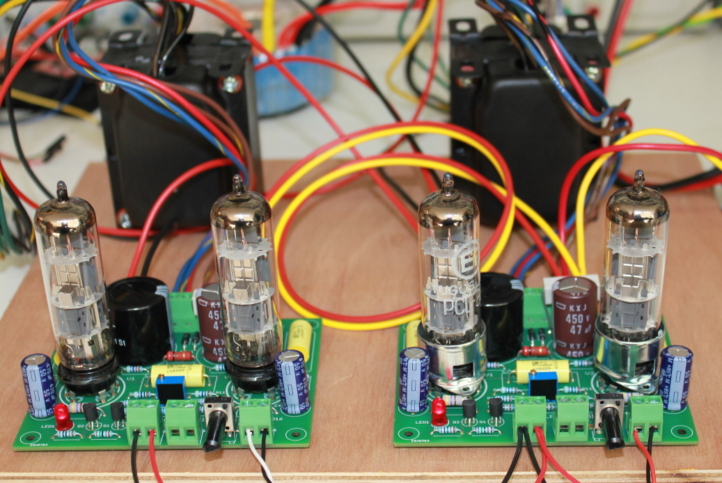

Hello Potepuh:
I have just recently finished the build of my version of this amp. (pictures soon, should we start a bby huey build thread?).
I highly recommend you go with higher voltage capacitors. If you want to try a range of tubes you will need your voltage to go upto 500v or so. The capacitors on the BOM I used are 450v, Upgrade to the 600 or 650v ones. It will give output tube rolling options, which is pretty great. I am using 6P6S(6П6С, 6v6) and am about to try 6l6gc, and if I can get my filament amperage up I would like to try kt66, and EL34/6ca7 as well.
Marc put up a chart a while back that compares the various tubes in the family.
View attachment Comparaison pentodes et tetrodes.pdf
Seems to me 500v gets you into the range pretty good.
I hope this helps

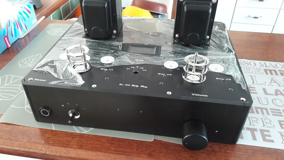

Hi Scott,
I will follow your suggestion and prepare a new thread for building the EL34 Baby Huey soon, since there are already 330 PCB's sold and 20 more in waiting list for a 4th GB 😀
Your suggestion to use 500 V capacitor is very good, but builders should not use higher voltage with this PCB because there could be some isolation problem 😡
In the mean time my EL34 Baby Huey is almost finished (see picture). All this mechanical work is made by Philippe who is much better than me for this task 🙂 I was lucky to meet him and that he is also living near Bandol in the South of France because before in the past most of my electronic design didn't have a case, now they look professional 😎
Best regards,
Marc

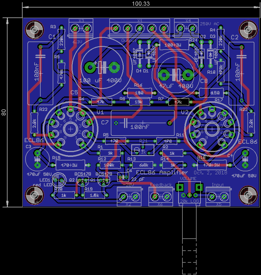

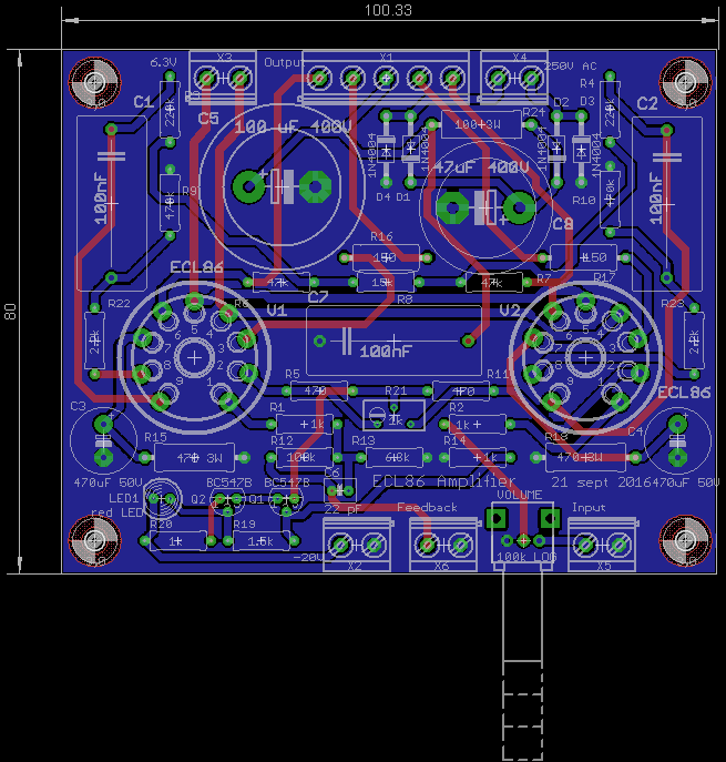

Hi sunil,
No sorry I didn't have any spare, it was my first Baby Huey PCB and I made only 5 pieces, all gone 😡 I know that you want to use your ECL86 tubes, but otherwise you can still buy two of the last 6 EL34 Baby Huey PCB available in the last GB made by prasi...
If you want to make the ECL86 PCB yourself, I can send the Gerber files, give me your email by PM...
Hi polycell,
Any red LED will be OK, the forward voltage should be around 1.7 V and the current will be very low, few mA.
Marc
Marc,
Thanks for the info. I didn't think about asking for the gerber files to get some PCB's made. In the end I used your schematic and layout screenshots to create my own PCB's using Kicad but with the major difference in that the heaters are wired for series (using PCL86). I also made the PCB 100x100mm to allow a bit more space for the components. All that's left is to get them made at one of the ridiculously cheap China PCB manufactures.
Polycell
