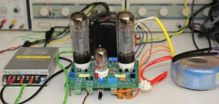

Thanks to Bandol I have a couple of PCBs in hand, and finally getting around to placing a Mouser order.
Couple of questions here as I scan over the BOM and start to order things.
I've noticed many different tubes suggested... is there any kind of agreement on which might be the superior / best all around choice? In other words, what besides having spare parts around would it make sense to go for 6V6, 6L6 or 6550? Figure it best to settle on that one before I splurge on output txs.
Re: C6, C7: I take it you chose the LGL 400V Caps for ease of casework? 25mm height is hard to beat. Which would be the parameters I should be looking at in this location? Ripple Current? I always like to go for longer life electros if possible... 2k hour rating doesn't instill much faith for me... sometimes these days I sneeze and ~2k hours have gone by...
I usually use the E91 Long-Life United Chemicons but I think a bit too big of a diameter for this PCB.
I might just use big screw type caps and tie them down inside the case.... or, I have some gigantic 60uf 600V Poly Film caps I might find a way to tie down inside the chassis. Do you think I could get away with some smaller values in those spots?
On C10, 11: You state the UFW is a tight squeeze. 12.5mm vs 10mm for the chemicon. Do you need all 100V? There seems to be 330uf in 10mm up to 80V in the chemicons.
R22: the BOM Panasonic Log says 50k log but code on BOM brings me to a 20k. I found a 50k log pot in the same series, but it says with bushing while item from bom specifies no bushing. Any material difference?
1uF, 100V: You chose an Epcos B3, 5mm width. I think I might try a Kemet F461 PP Film, 10mm width. Same length and lead spacing, but concerned about brushing up on nearby R's. Any idea if it will fit?
Power TX (115v): Looking at the Hammond 261G6, 45VA, 250V C.T. @ 130 ma, 6.3V @ 2A
Anyone realize benefits having separate B+ and filament Txs ? Has anyone built with DC Filaments?
Any other US transformer options would be appreciated.
Output: Hammond 1650N
Tube Sockets: Have always had good experiences with the Belton sockets despite not being very fancy looking. What is everyone elses favorite pc mount socket? Currently looking at these after having a chat about ceramic / heat.
Once I sort out the kinks I'll post my BOM and notes for easier ordering for others.

Hi John,
Several answers to your questions:
1) the choice of the output tube is dependent of your target and of the output transformer, ie: 6V6 require a 8k OT and will give you about 15W, 6L6 is better with a 6.6k OT for 20-25 W max and 6550 can supply 50 W with a 4k OT
2) C6, C7: bigger capacitors can be used with a wire connection of course, but a better solution is to use a filtered DC power supply with a rectifier bridge and large capacitors to feed the Baby Huey PCB with DC current (you can replace the D1 and D3 diodes with jumpers and remove D2 and D4, but be careful to connect the + and - on the right input 😡), it is still good practice to keep the small capacitors near the tubes...
3) C10, C11: of course you can use 80 V capacitors, but only if your bias power voltage does not exceed 50 V AC !
4) R22: 20k or 50k are both OK for the pot, but it must be log ! Nota: you can also use a dual pot fixed on the front panel and connected by wire if you want to make an integrated amplifier, you can even add an input sélector 🙂
5) C12: if you solder the capacitor under the PCB and the resistor on top there should be no problem...
6) Power TX: this transformer will not be powerful enough 🙁 You will need at least 250 mA for high voltage and 7 A heater current for an EL34 version !!!
7) I have used DC filament with a 10 A 6.3 V switching power supply and was happy with it (see photo)
8) Hammond 370 HX should be a better solution even if 6.3 V is limit at 6 A for EL34 ? TOROIDY TSTA 250/001 is by far a much better solution with 16 A available for 6.3 V, two high voltage output 275 & 330 V AC and a separate 50 V supply for the bias 😀
9) you don't need a shielded socket for the ECC83, it is a power amp diff amplifier and the voltage level at 2 V is high enough to have no noise, it is not like a RIAA amplifier at few mV...

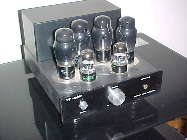

I've built both dual monoblocks and stereo with single power supply.
I can't tell the difference.
What I'm using at the moment, 6V6G and 6SL7, single power supply, Hammond 1608 Output Trannies and this power tranny:
86PP power transfomrer
Chassis was from Mable too.
Ian

Nice looking amp.
For the power transformer, choosing one for a 6V6 PP is very different vs choosing one for a KT88. Current requirement to drive these powerful output tubes and B+ requirements are quite different if you want to optimize.
Choose your favorite output tube and we can then advise more.
For around 30W then any off the octal base EL34, 6CA7, KT77, KT66, 5881, 6L6, 7581 will do your 30'ish watts while operating conservatively.
Of these EL34, KT77 were designed with Ultralinear Operation in mind but any of them can operate in UL mode.
My choice would be KT77 but that is personal opinion only and worth what most personal opinion is.
For guidance the higher gm tubes suit the BH design best (the first 3 listed above).
BUT
The BH amp I'm using at home now (pic posted above) uses 6V6G which have a gm of 1/3 of what KT77, EL34 give. The 6V6Gs also ONLY give 10 Watts out.
If you want the smaller 9 pin base then 7868 will better (power out wise) the EL84 at about 24 watts.
This is a tube from the later American "JukeBox" days. I've some on the shelf but haven't got around to trying them yet.
Ian
