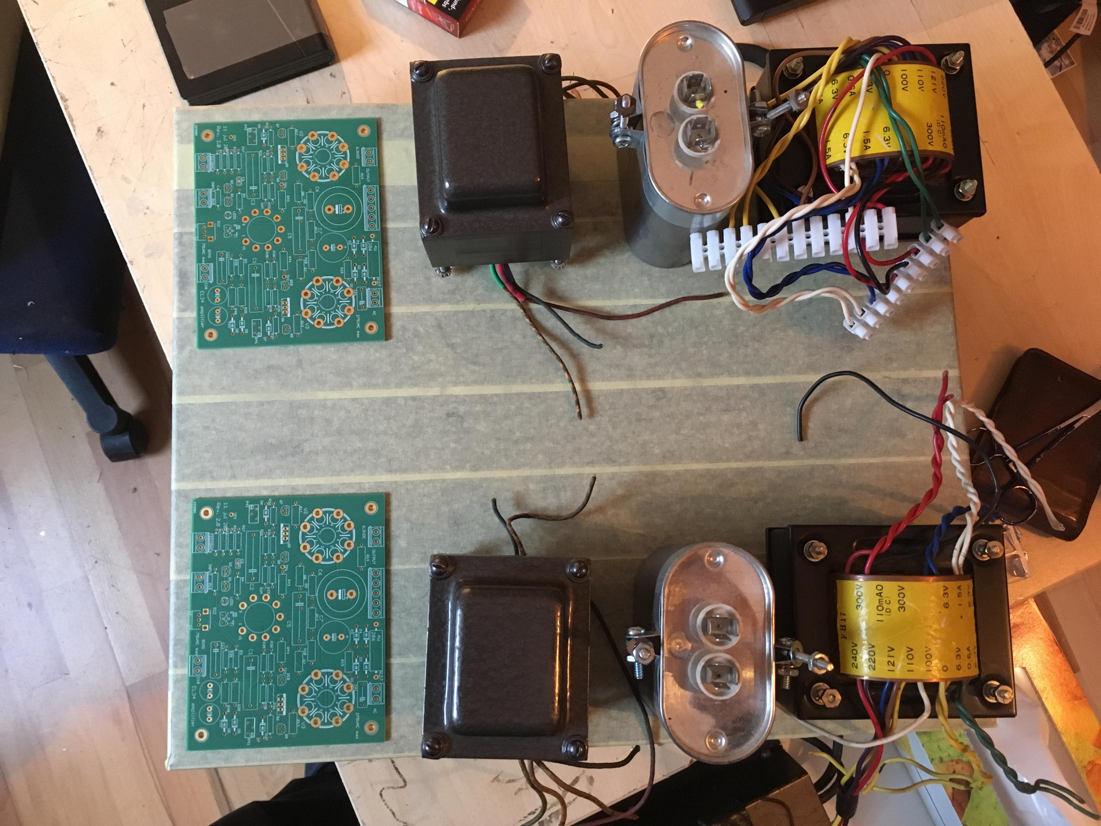

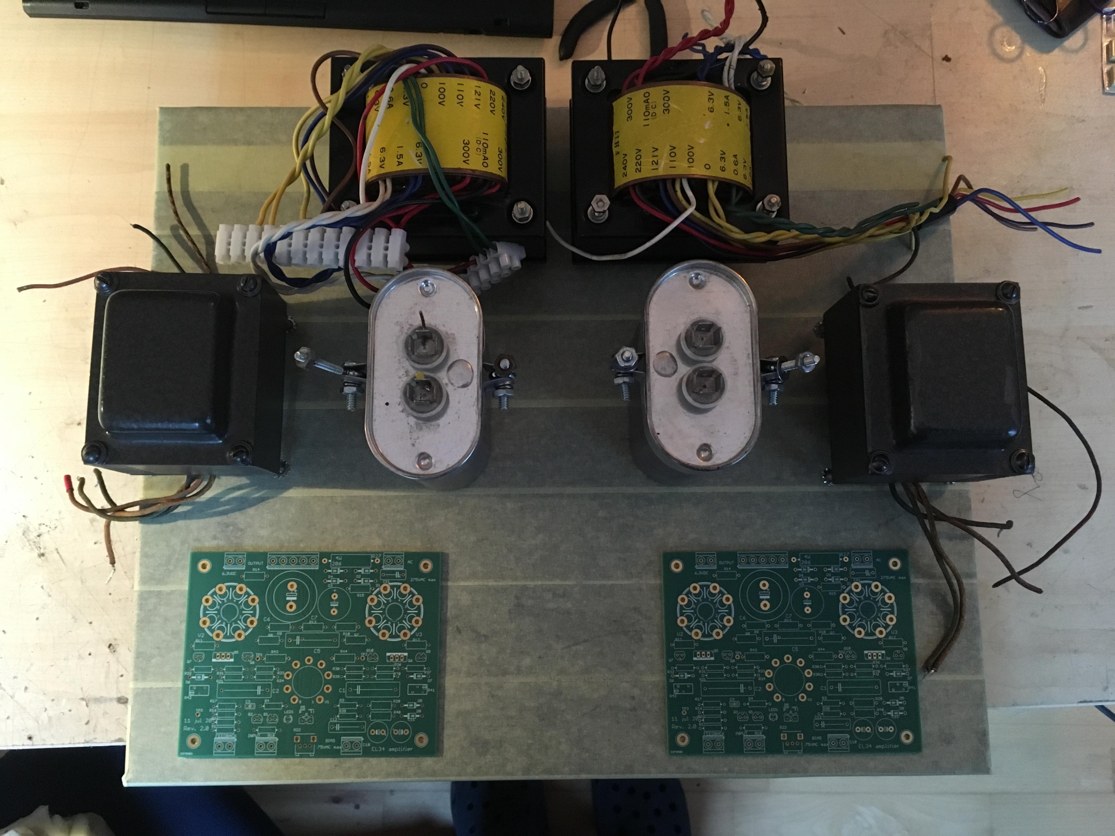

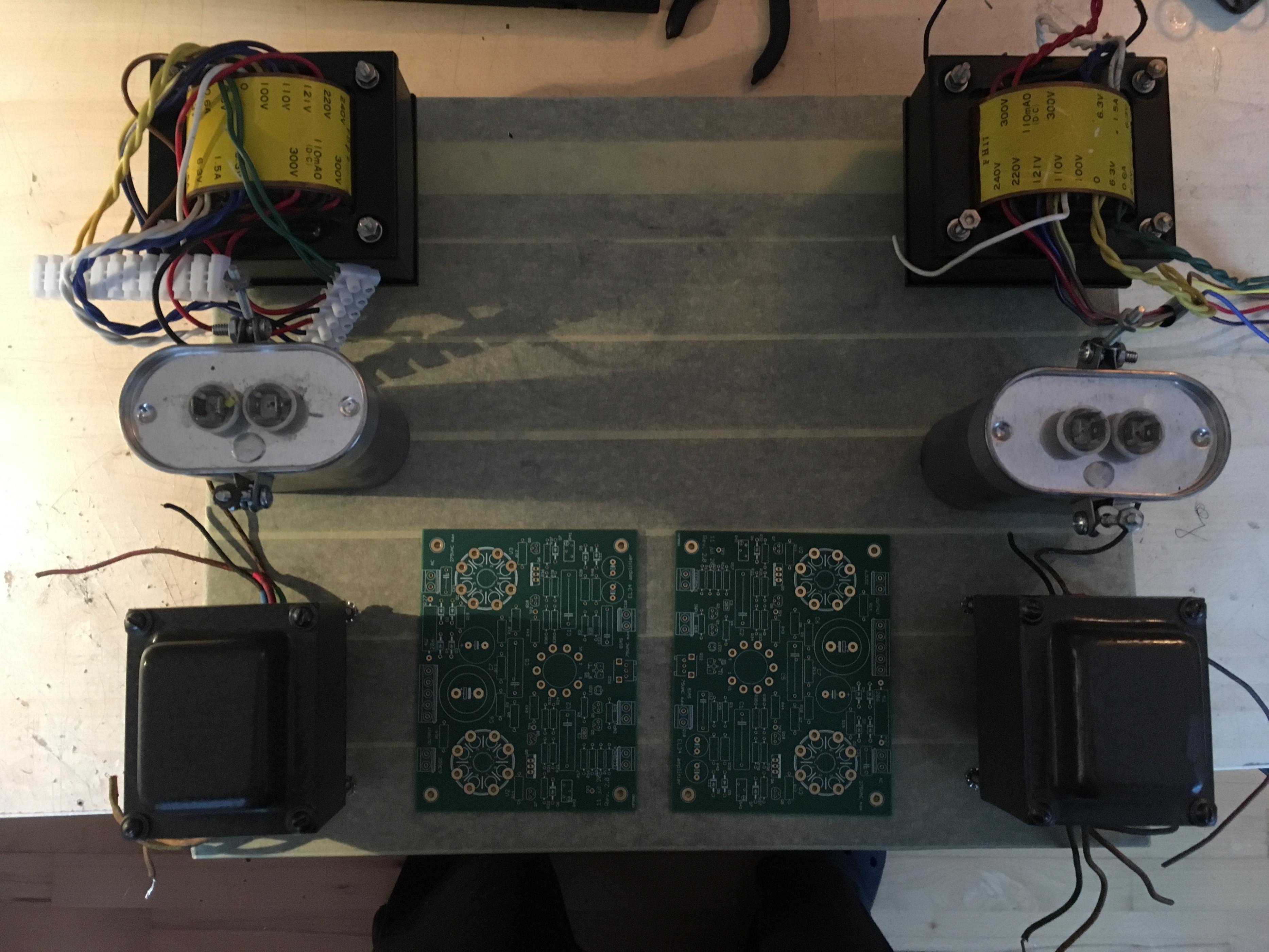

Hello mctavish:
It looks like it is going to be tight squeeze.
I like tubes up front, so #1 or #2.
You might also consider two separate chassis. It is a bit of a pain in the butt with double everything and separate volume controls, but that chassis you have might be a little too tight. Check real close before you start drilling and cutting.
Yup, tight fit. It is 14'' x 17'' though, the biggest I could get...
I will have to sleep on it and have another look tomorrow🙂
Mctavish is way a head of me and looking good. I'm really gonna enjoy watching everyone's build & concept. I bet he dreams about it in his sleep...

I think I am going to go with option 3, it provides the most space between the output transformers and the power transformers and it keeps the connections close.
The chassis is 4'' x 14'' x 17'' so its quite big, the biggest that Hammond offers.....
The whole thing will be Quite heavy when done!!!😱
Today the holes are going in the chassis!!!
