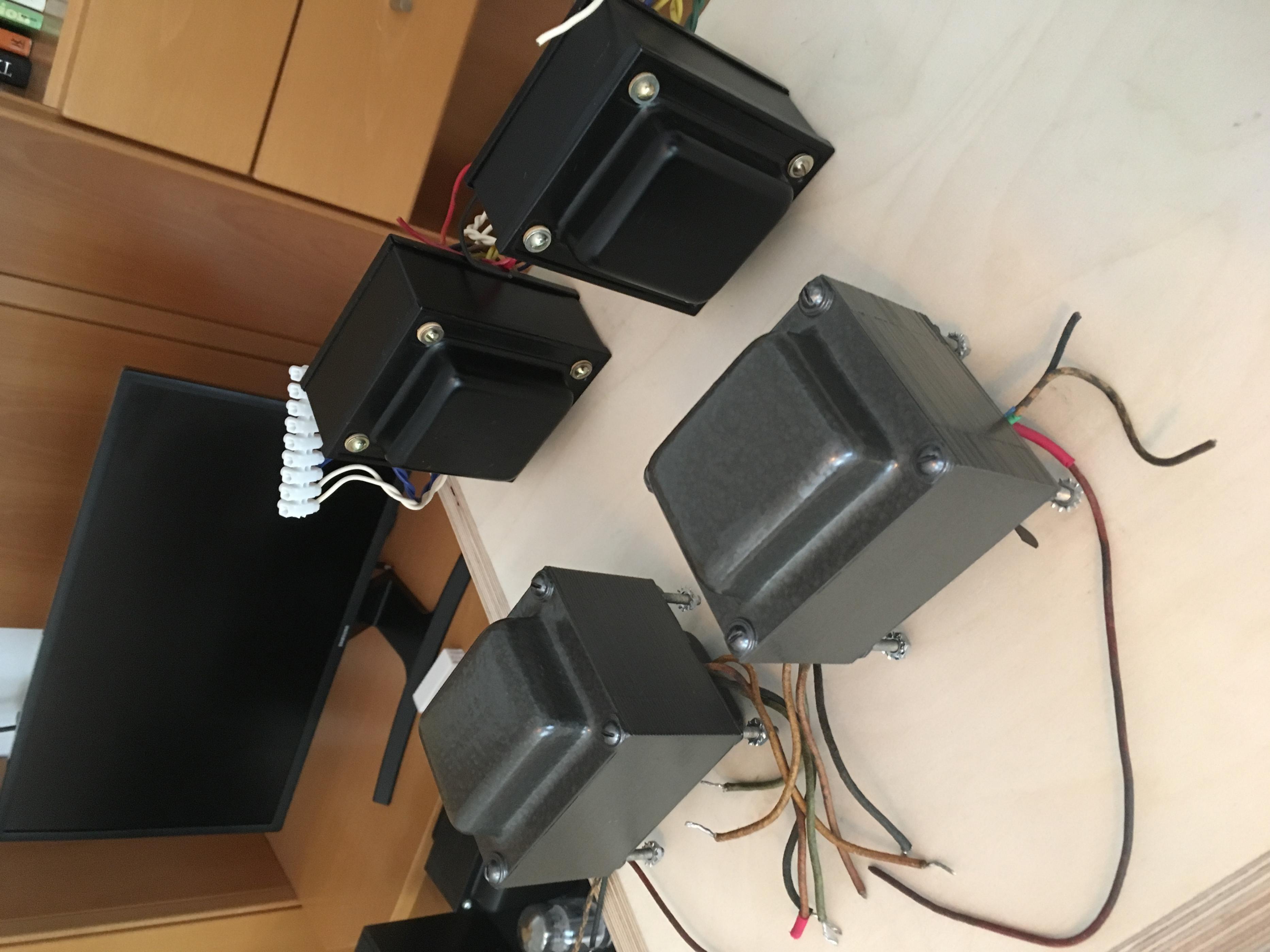

I have a new request on PM 😡 Please use this forum for technical question ! PM are only for confidential private message, I will not respond to technical questions sent by PM anymore and my box is nearly full...
Question from potepuh:
"Hello
I am about to built a baby hue with the 6550 or 6V6 will this transformer be apropriate? FS: Pair of Hammond 1628SEA HIFI Single-Ended Output Transformers In EU. or I should by the toroidy?
Thanks! Sebastjan"
No this transformer is for single ended amplifier as indicated and it is not designed for Push-pull output 🙁 You need the recommended Toroidy or if you prefer Hammond : the 1650N.

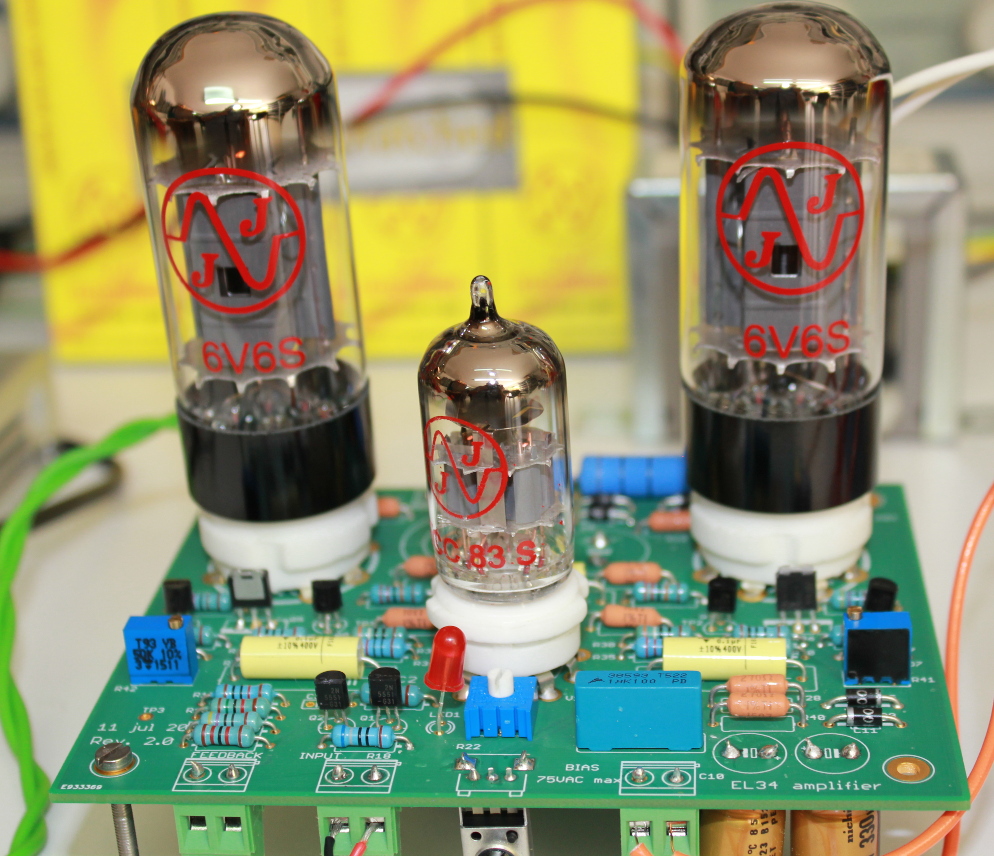

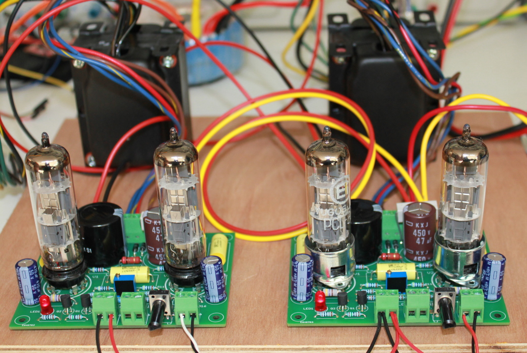

It is not only EL84 🙂
The thread started with EL84 because the original design was based on an ECL86 which was unfortunately no more produced and therefor Ian replaced the two difficult to find ECL86 by an ECC83 and two EL84...
I have designed 3 different PCB for the Baby Huey :
1) A simple version with two cathode biased PCL86 (equivalent to the ECL86 with a different heater voltage and easier to find) see photo...
2) The official EL84 third version with MOSFET source follower and fixed bias...
3) The octal output tube ultimate version with same MOSFET driver and fixed bias for EL34 or equivalent tubes!
There were many different version with the EL34 or 6CA7, the KT88, and even the 6V6 which work very well (see photo) and more than 200 PCB were produced with octal output sockets 😀

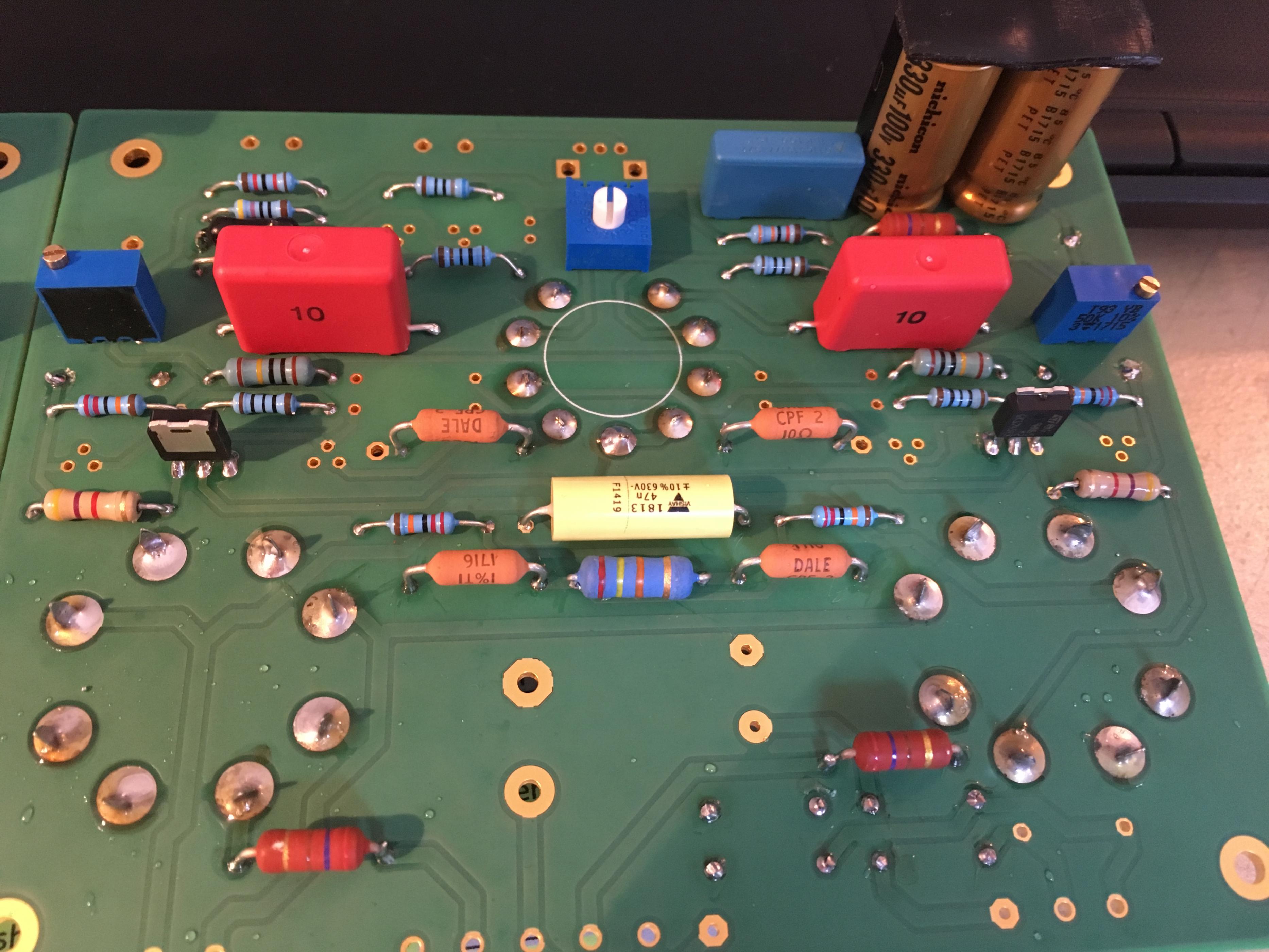

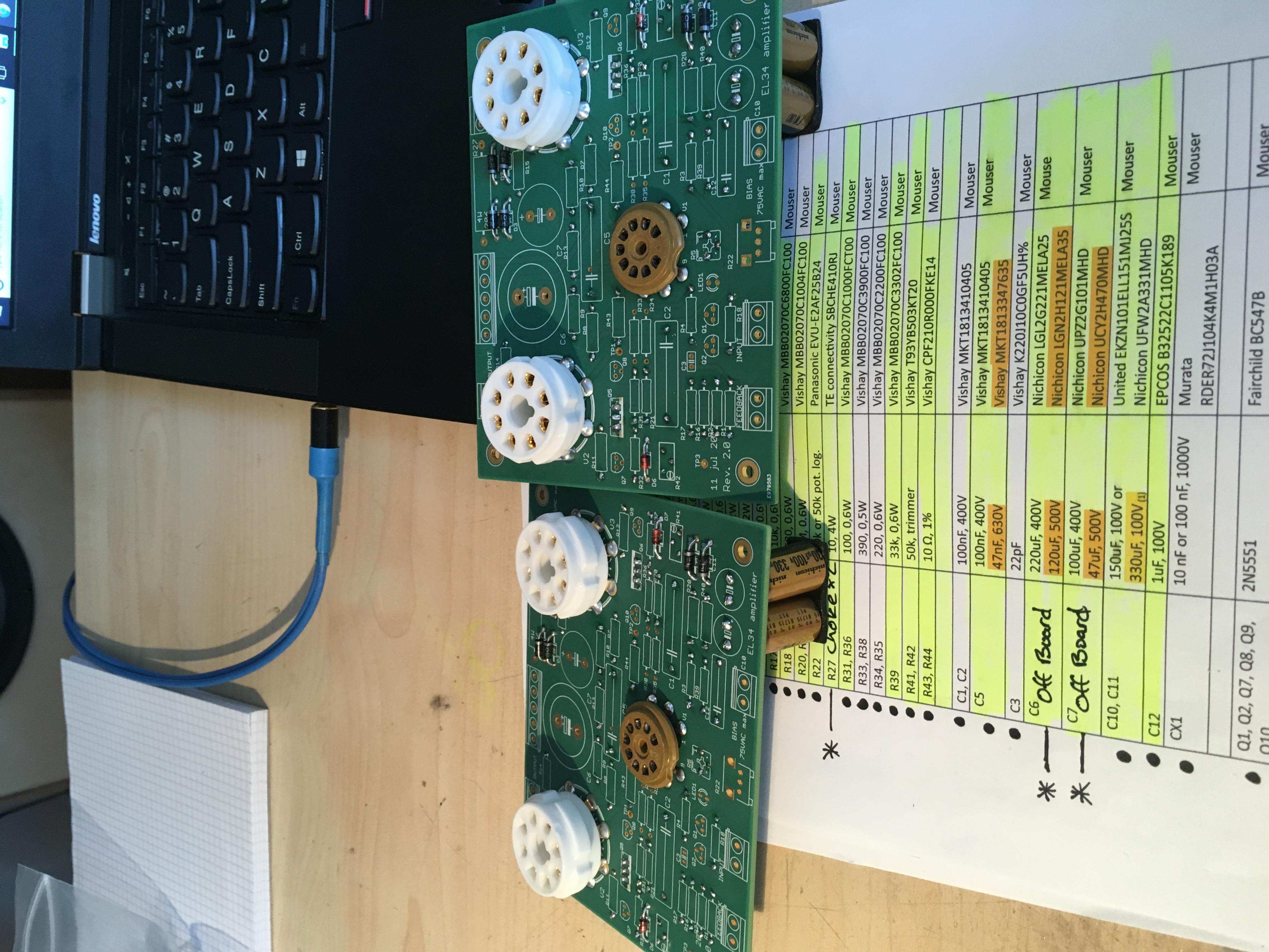

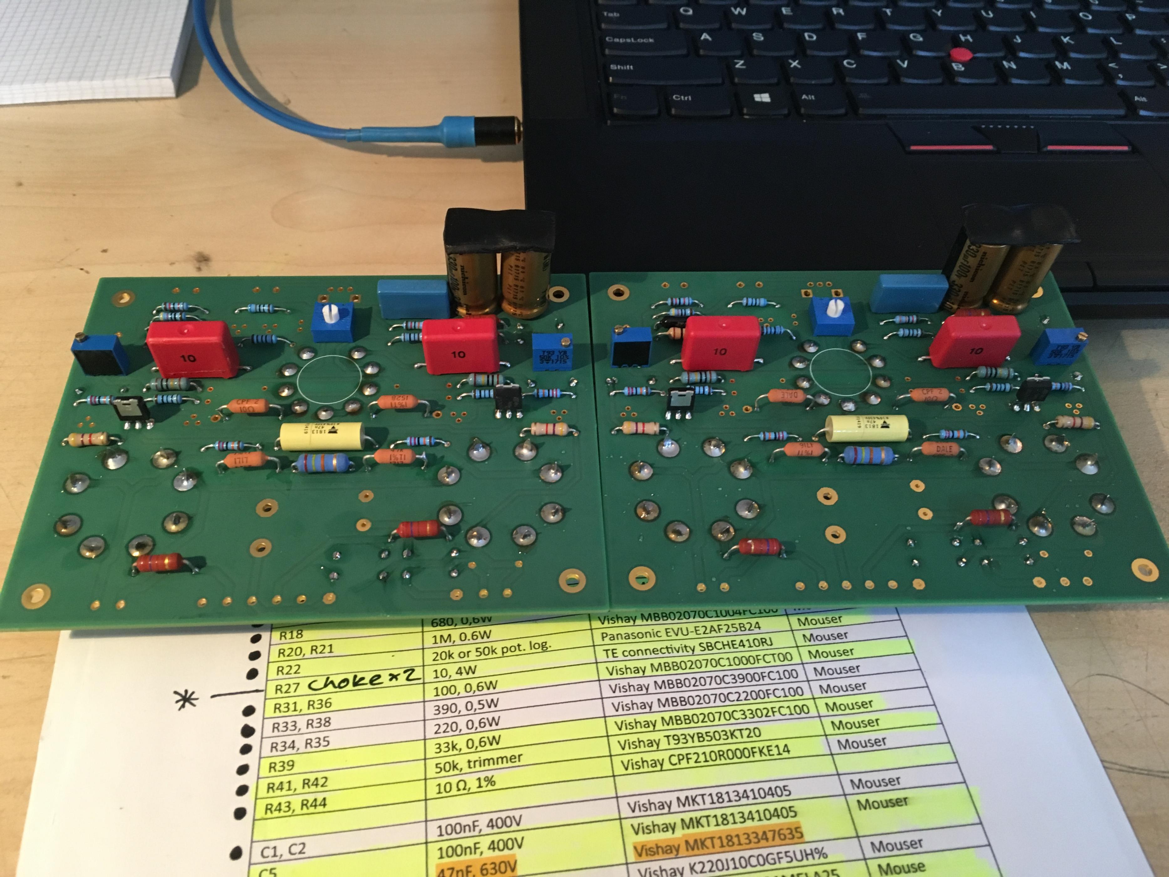

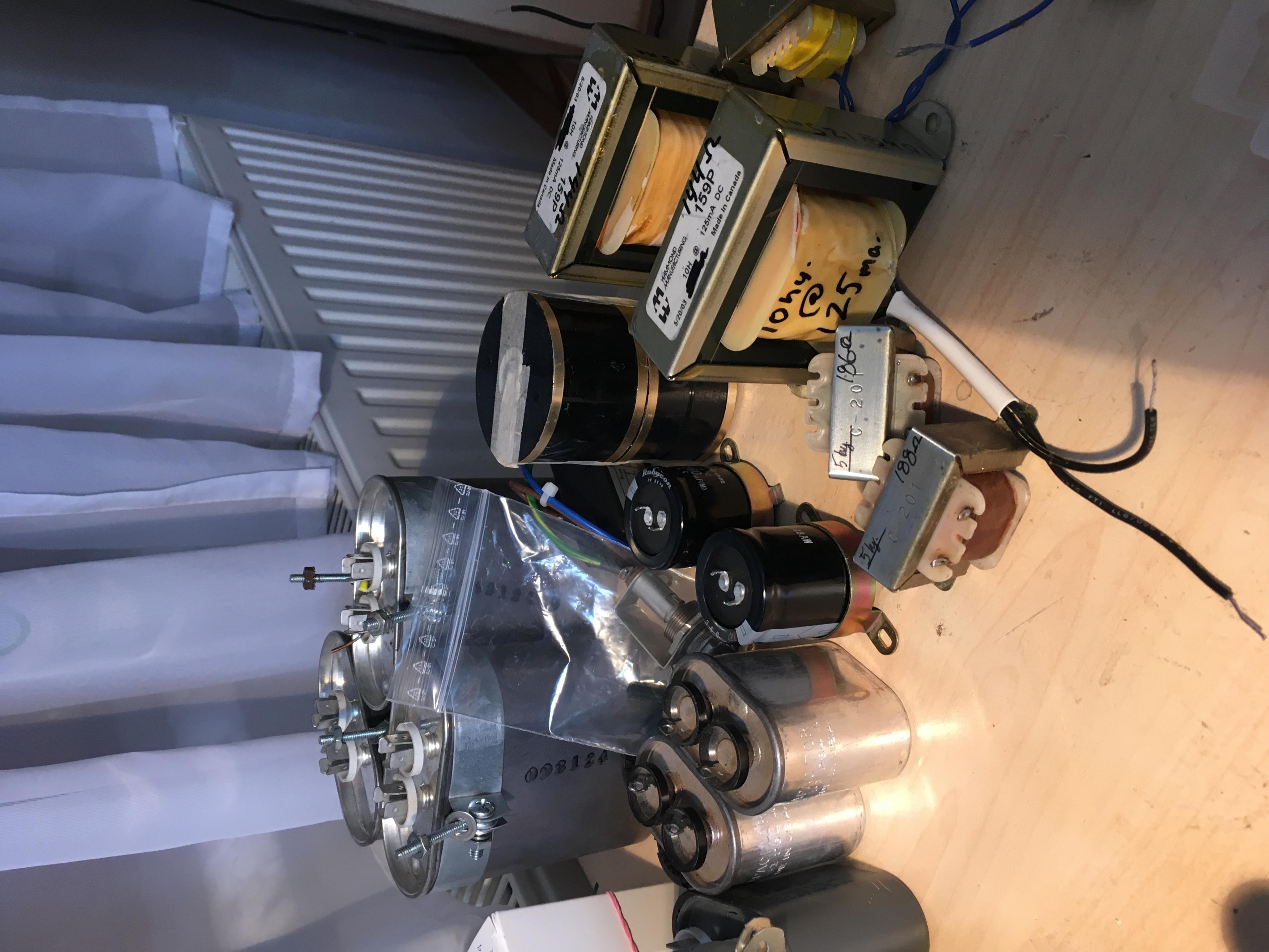

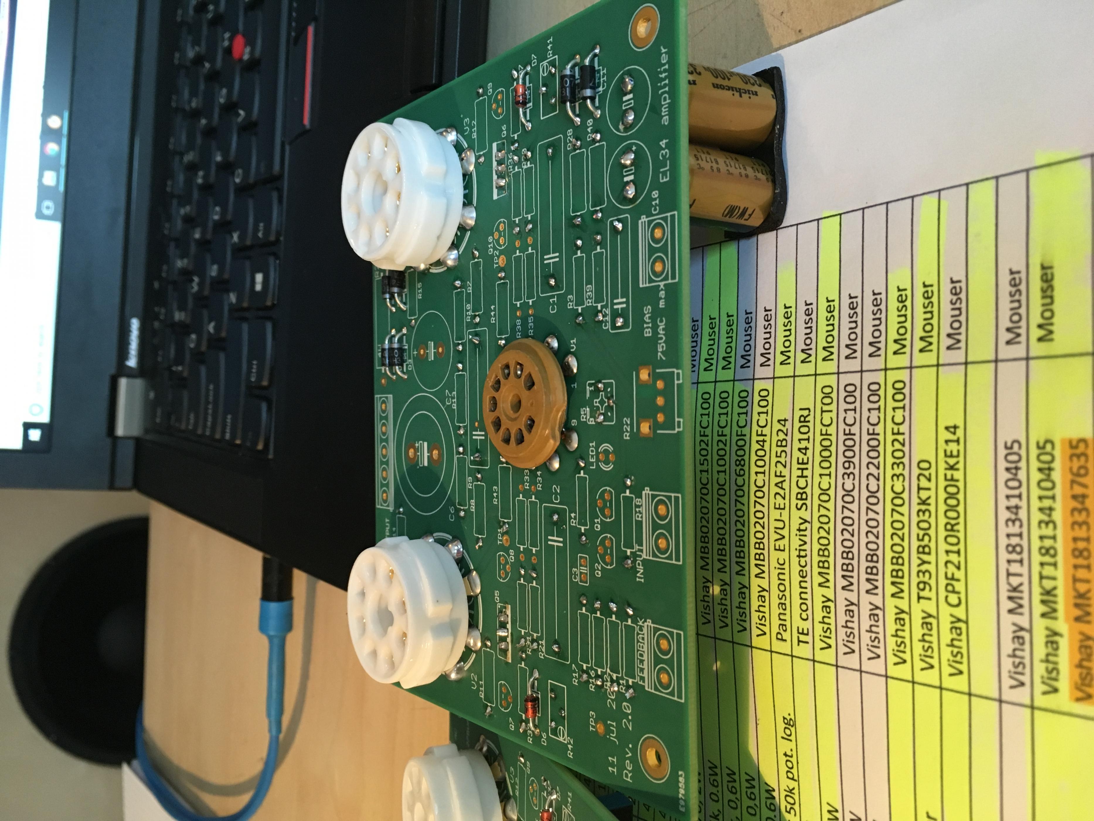

Here we go!!
Boards are almost stuffed and the other parts will follow soon!!
This will all go in a large black Hammond chassis with a dual-mono setup.
There will be some 40uf oil caps helping the electro's and a single ganged stereo Alps blue pot for stereo control.
