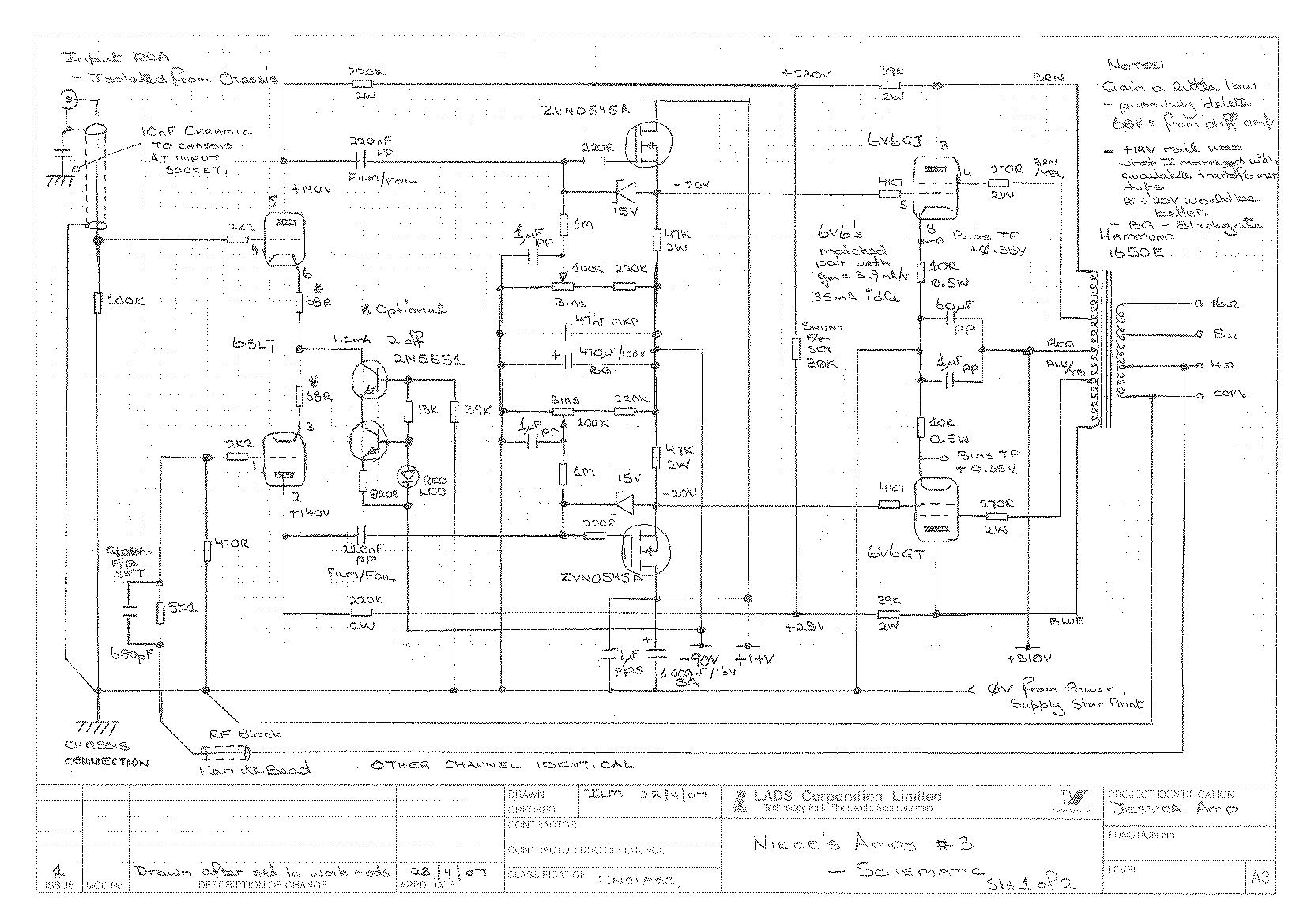

Tube Rectifier - that would be the Jessica Amp.

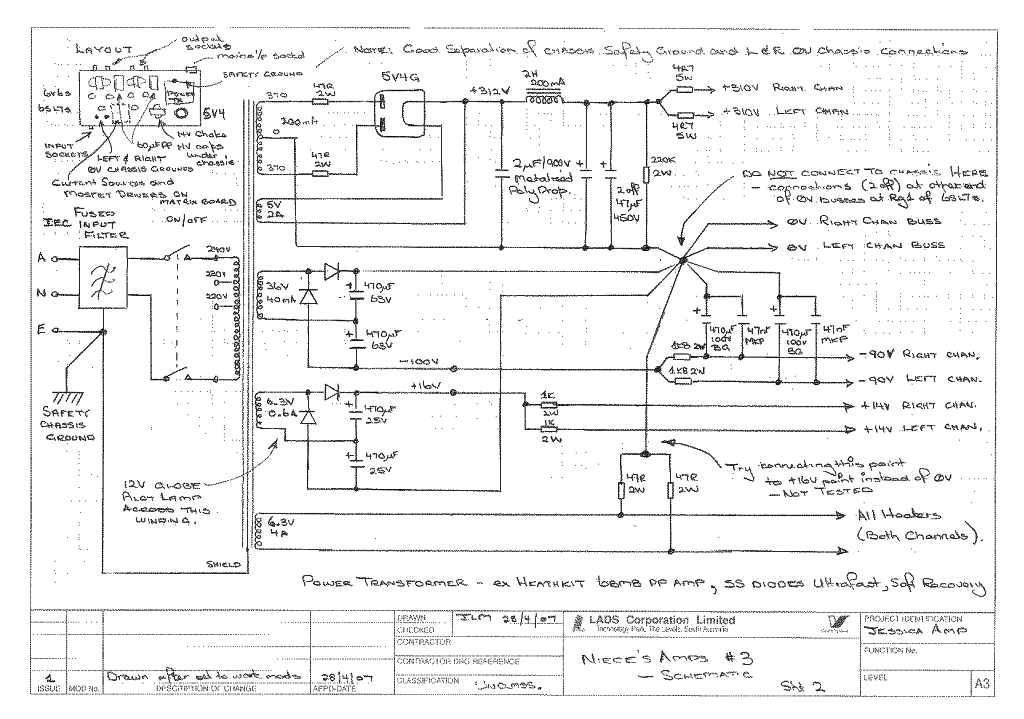

Here is the Power Supply I used for Jessica's BH.

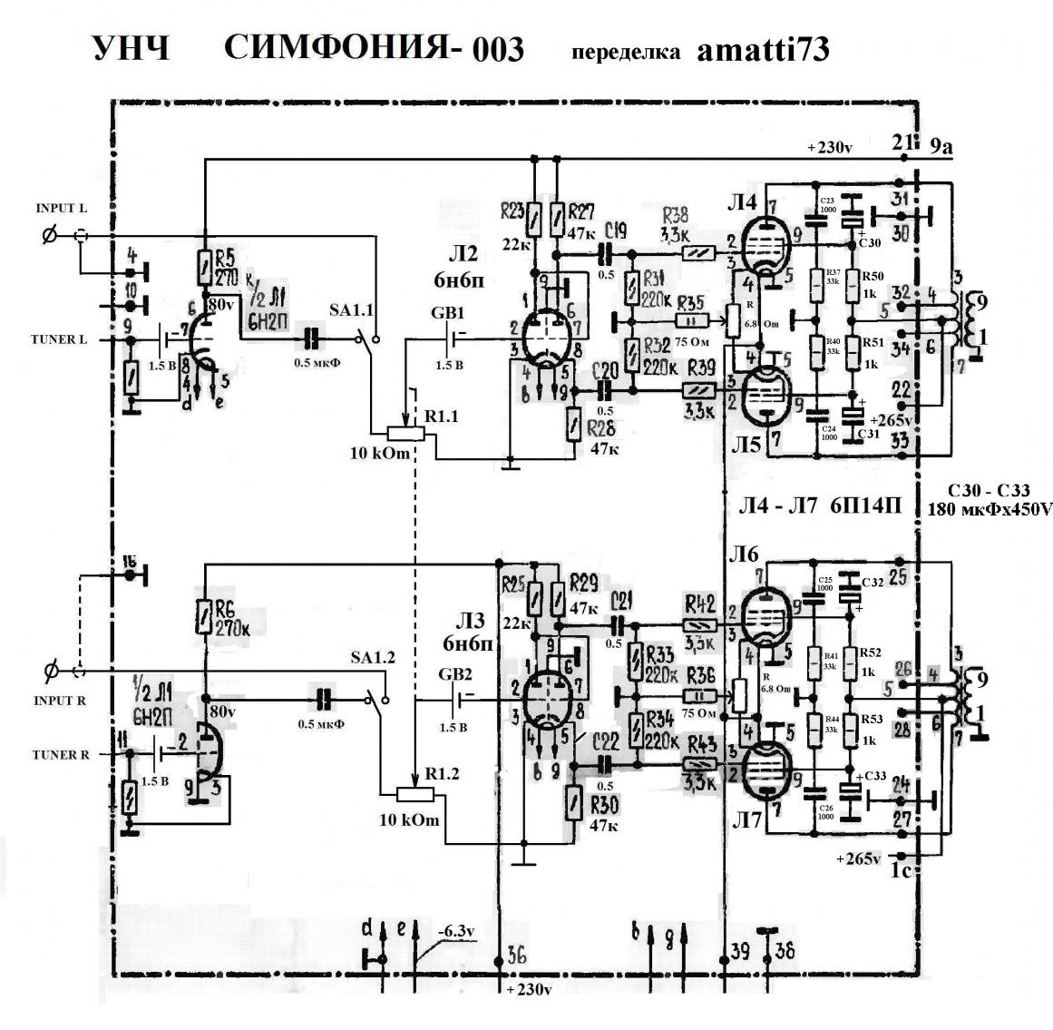

The obvious choice would be an EZ81 rectifier, however I will be using all-Russian (6P14P and 6N2P) tubes for my BH so ideally I want to use a Russian rectifier too. The Russians never seemed to have made a noval rectifier however, so I'm pretty much "stuck" with using a 5C4S, which is supposedly a 5Z4GT. I also have some nice 100uf film caps I want to use as a power supply reservoir cap.

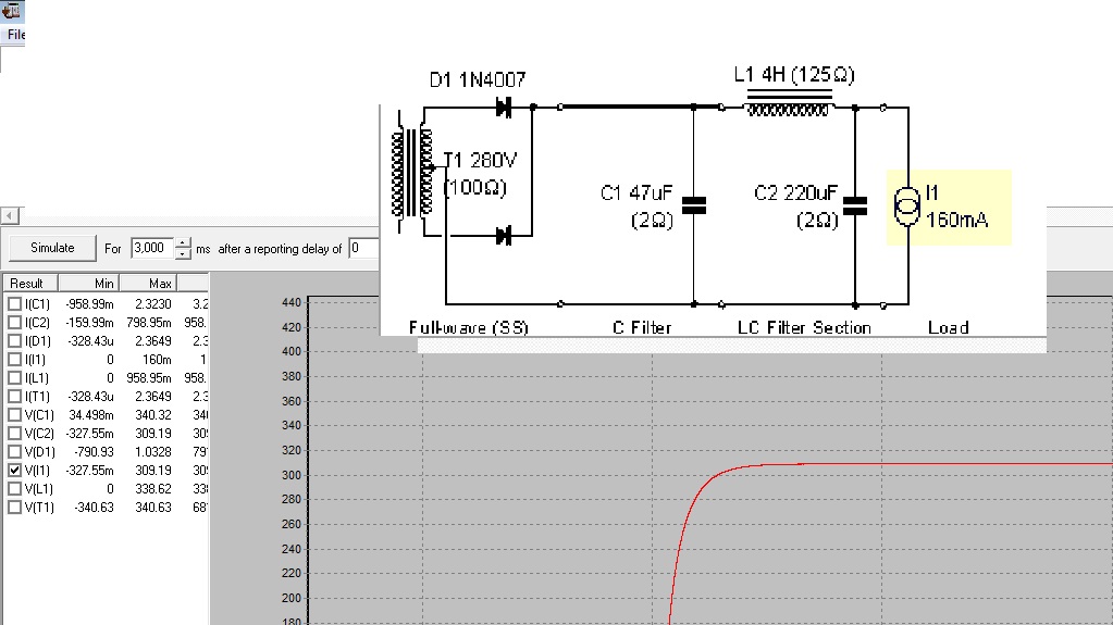

Do you think I can run 4 EL84's and 2 6N2P's on one 5C4S? What would the total current draw be?
I'm using a 300-0-300 trans, 250mA
4,7uF behind the rectifier (this is a downside, because the ez81 can handle 50uF), a 10H choke with 100uF cap, then the EL84's.
I simulated this with PSUD (using 5Y3-GT as rectifier).
This gives me a B+ of about 285 volts. Is this sufficient? I think so?
Any other configuration that works better? Should I just ditch the valve rectification idea? (My trans does not have a 5v winding so I'll need a separate one anyway.)

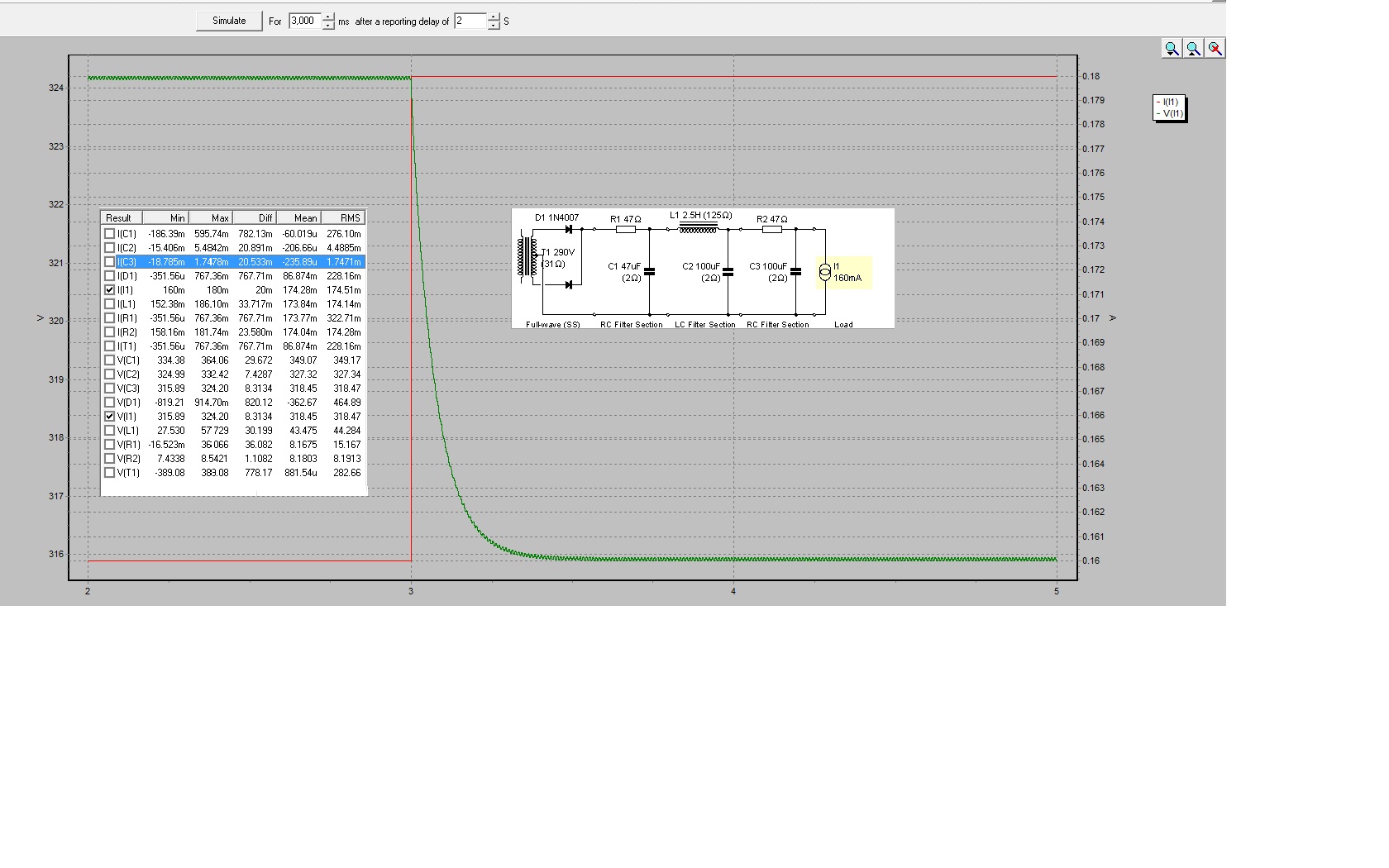

OK, so I have not got an exact value for the choke yet but I have had a bit of a read and experimented with PSUD2. Not sure that it is perfect but I think I have what looks like a fairly smooth arrangement for my power supply.
Is it OK to add resistors before the diodes in order to tweak the final B+?
Also I only know the resistance of the choke without load, I presume this will rise under load.
Can you have a glance at the design and confirm that it is OK.
Cheers Ian.

Hi Sharkey!
The DC resistance will be the same with or without load. The inductance might change with different loads. Some LCR meters measure resistance with an AC signal and will not give the correct DC resistance.
Thorsten
Thorsten
