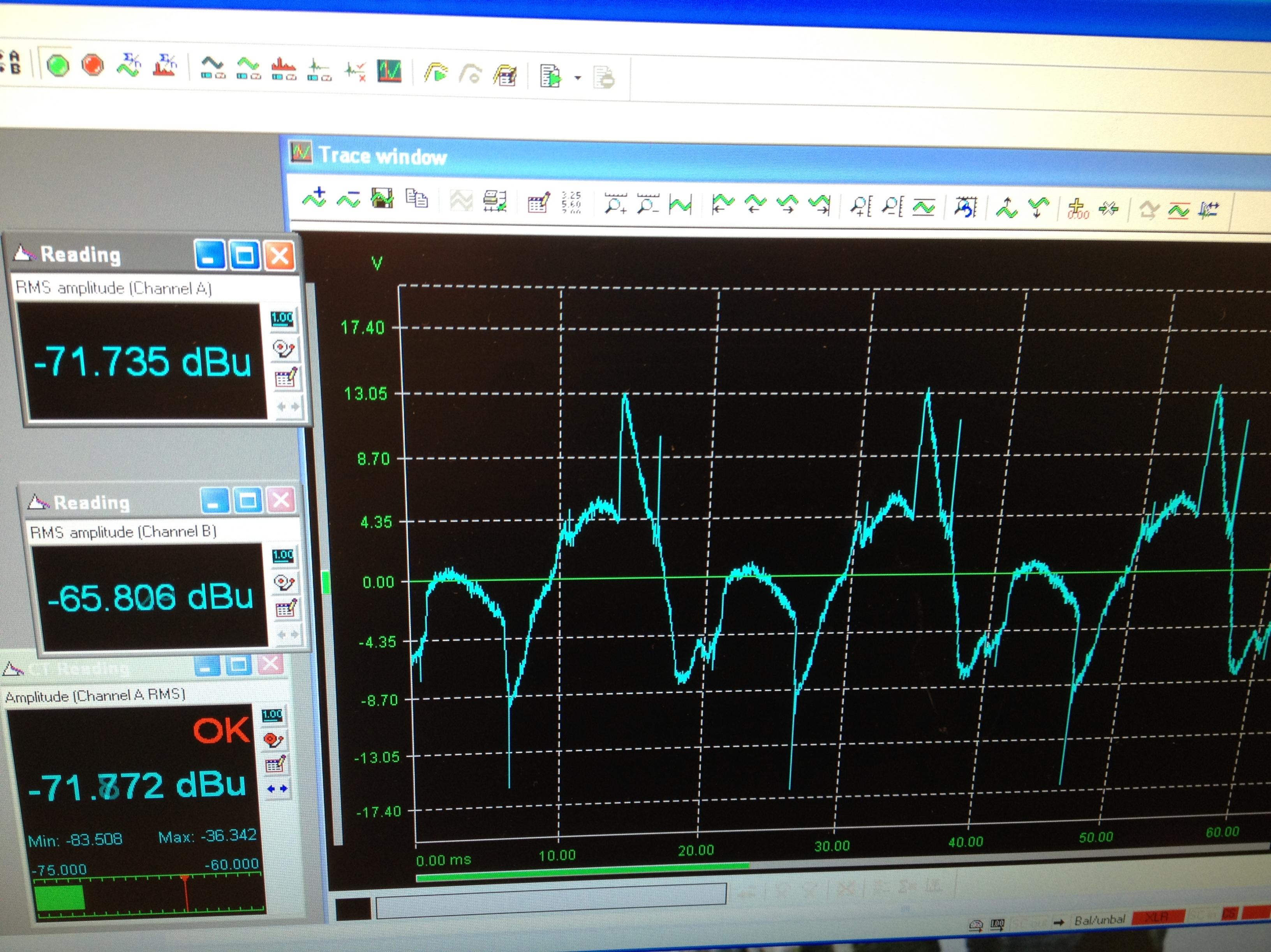

Hello,
I’ve recently finished constructing a Baby Huey style amp for a gift. Essentially the same but RC biased output stage. The amp sounds good, not as good as the original version but good enough for a present!
However, there was quite a large amount of hum with a shorted input, and one side had more hum than the other. So a little testing and one channel was down at about -65dB, and the other -55dB.
My grounding scheme is a bar of tinned copper wire across the amp and grounded at the input sockets. A little playing around with ground wires, and splitting the ground bar into two channels improved the SNR to where I expected - about -75dB. But only on one channel, the other being at about -55dB.
With a sine wave input, the noisy channel was about 1dB higher than the clean channel. So I went through to check everything was the same between channels.
Swapped valves, checked all voltages, checked each input ccs - all OK.
Now I think there may be some interference from the volume pot (the build is in an old radio and isnt ideal) so I grounded the grid of the noisy channel which dropped the noise down to -65dB - better but not good enough.
The last part I haven’t swapped/checked is the output transformer (Hammond 1608) as it will be quite tricky. Do you think this may be an issue?
Attached is a live trace of the noisy channel.
The peaks cycle at 50Hz, which suggests heater hum, but I have tried a few approaches with heater wiring and makes no difference. Is there any tell tale interference with this picture?
I will keep trying different ground approaches for the bad channel tomorrow, but I exhausted all my ideas today. Will need to keep at it!
Cheers
Charlie

If you haven't yet segregated power ground from signal ground until you reach IEC and chassis ground you might want to try that. You can also try lifting the OPT off of the chassis, just to make sure you aren't getting chassis transferred circulating currents into the OPT.
From the looks of the wave form your problem may well be airborne EMF, certainly the trace position of the peak is showing that. This will entail revolving core center leg direction to an out of phase position from the emitter, but do try the other things first.
Bud

One could suspect that the input socket on the faulty channel is not isolated from ground.
Maybe sounds stupid, but check again that you made the ground connections exactly the same way on both channels 🙂
There is one more thing you could try, for general noise - isolate and elevate the heater ground connection.

Thanks for the tips, I will certainly try them out.
The fault can't be input socket related as it shows with a grounded input grid. I do have segregated signal and chassis ground, but it may well still be a grounding issue.
My worry is that because of the different signal size at the output, it may be something else?
Note: The very sharp peaks in the picture are my soldering iron. But the main shape was there in the other channel until grounding was adjusted, so I am hoping it is that.
Heaters have an artificial centre tap with 2x 150R to ground, so I may play around with that too - thanks for the tip.

OK, just got into work and played around with the heaters. I moved the centre tap to another point and it improved the SNR quite a lot. So I will play around with that again when I get the chance.
The noisy channel is actually lower in output than the clean, not the other way round as I said before. About 0.6dB. So need to figure out what is going on there too.
