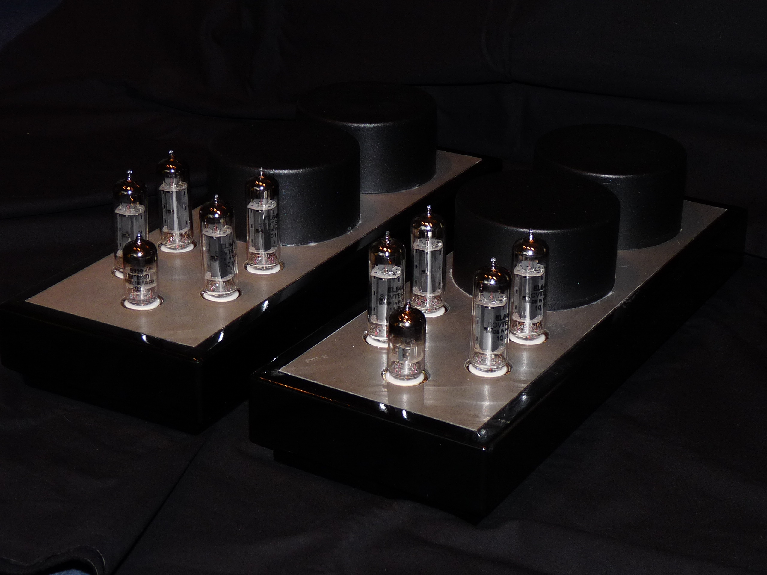

Hi everyone
I like to share with you my creation of the Baby Huey.
This was made as part of the TubeSociety a course for building and designing valve amp's given by Menno vd Veen.
In this design i wanted to have some extra power there fore i put an extra set of EL84 tube's in the amp.
A part of this extra power is used to create some extra local feedback by increasing the resistor in the middle i have used 50K for this one.
http://www.diyaudio.com/forums/attachment.php?attachmentid=320640&stc=1&d=1356974775
And this is how it looks like.
Regards George
