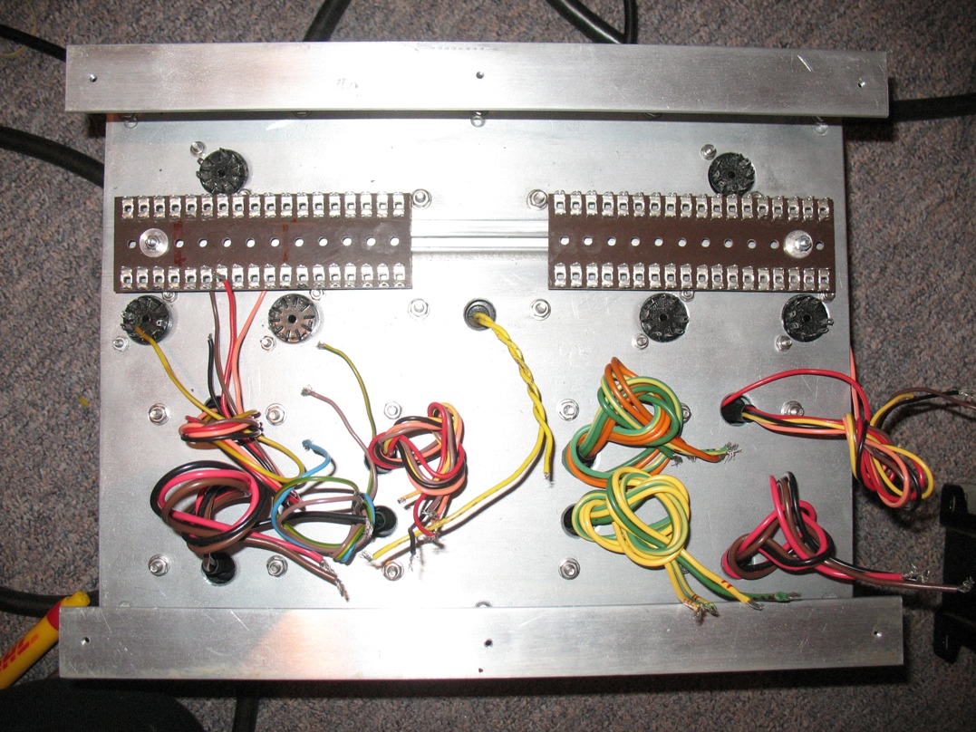

Hi all,
I thought I'd build a Baby Huey as my first power amp scratch project, I have heard such good things about this amp and it seems that there is plenty of advice, expertise and helpful people on this site.
So far the chassis is done and transformers built and in place. That, I think is the easy part !!
I have made the chassis very compact, after-all it is a BABY Huey.
I've no doubt i will be asking for more advice at some point so I thought it only decent to show off my work so far !
Thanks to all those who have tolerated my limited electronics knowledge until now....! Can't wait to hear her first words.....

Nice start...
Thx for the pics. I'll be watching your build. I'm very curious on how the build goes and what it sounds like. But I need to finish one project before starting another..... No hurry but keep it rolling....
Ian (Sharkey22),
Good start, that looks about the ideal size chassis, you would not want to try to build it into anything smaller. Some of my greatest frustrations have come from trying build "stuff" into too small an enclosure.
Ian
Ian

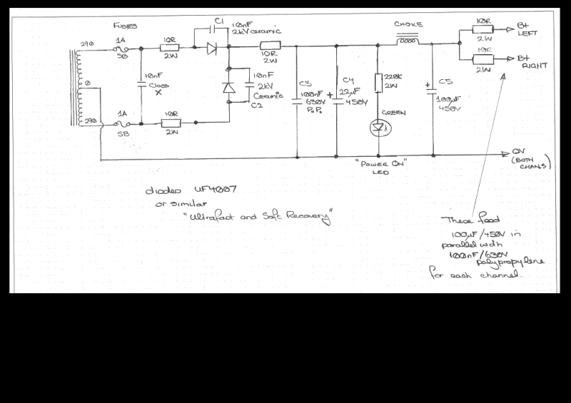

Ian,
Here is a power supply, a bit over the top maybe but adjust to your taste.
Fuses are not absolutely required if you fuse the transformer primary.
The 10nF Class X and 2 x 10R before the rectifier diodes are intended to block any diode switching noise from coupling back through the transformer into other windings (particularly bias supply windings etc.). "Class X" is a safety rating and signifies a capacitor which is suitable for connecting from active to neutral on a mains supply. They will generally be a metalised polypropylene or metalised polyester.
Diodes are anything ultrafast and soft recovery, like UF4007
Diodes have supression caps fitted across them (optional), again to help suppress diode switching noise. Thezse should be 10nF 2kV high voltage ceramics.
C4 can be adjusted to trim the power supply voltage, 10uF will give a little less output voltage, 5uF and lower will give a lot less voltage. This cap has about 250 mA RMS ripple current in it (according to PSUDII). Check the rating of the cap you use (if in doubt use [for example] 2 off 10uF in parallel to give you the 20uF)
The 220K 2W before the choke is a bleed resistor to discharge the capacitors when you turn the power off. Since we are bleeding away current anyway then you might as well put a LED in series with the bleed resistor. Use a front panel mounted Green LED (or BLUE if that rtocks your boat) as a power ON indicator OR use a RED LED under the chassis as a warning that high voltage is ON.
Use a common 100uF/450V after the choke and then use 10R 2W "isolating" resistors in the feed to each channel.
At each channel use a 100uF/450V with a parallel 100nF/630V polypropylene cap connected with their +ve right at the output tranny centre tap feed and their neagtives at the point where the output tube cathode circuits return to 0V.

Hello
I dont want to be a sceptic but I wonder what the purpouse is with all this filtering in a common mode noice cancelling PP configuration? Refered to famous constructions like QII for exemple a simple and small C-R-C for the powertubes is more then enough and gets it completely silence.
The splitter is another thing where "expensive" stuff like chokes etc can do some proper work. In some configurations G2 on the powertubes needs good treatment also but filtering powertube anodes with big chokes etc, where most of the current runs, seems like a bit over the top for me.
What is your opinions?

Staffan,
I did say that the supply was "a bit over the top maybe". Sharkey22 wanted to use the choke so I included it. Having built many amps I find that you may as well put this level of detail in from the start as it is usually messy to try and "shoe horn" extra components in afterwards.
The Baby Huey effectively has only a single power supply rail and so making it as clean as possible is unlikely to be wasted effort, some builders have even used regulated supplies.
Power Supply noise residuals are a source which form intermodulation distortion products with the signal (put a sine wave through the amp, look on a spectrum analyser and see all of the sidebands due to intermodulation with power supply ripple). If the ripple is'nt there or is greatly reduced (or if its harmonic content is greatly reduced) then so will those intermodulation products be reduced.
For Power Supplies I'd rather over design than under design.

I'm like you Ian. I tend to try and stay on the safe side on PSU filtering rather then the opposite.
On the topic of power anodes in PP config me and a friend did a test not so long a go. The build was a design by David Hafler borrowed from a Dynaco commercial paper http://www.the-planet.org/dynaco/Misc/Transformers.pdf (figure 3). The splitter is a floating paraphrase and GNF is different but on the output side it is close to Baby Huey (EL84 PP UL).
Sitting close to 100+ dB speakers we evaluated different B+ filtering to to the EL84s. We started with Haflers 40-100-40 C-R C but we had a clear hum. We also tried with different chokes instead of the R. The hum slightly reduced but so did the "happyness" in the music. It became duller.
We ended up on 40-100-140. It was completely silent with the ear in the cone and the happyness in the music was still there. Good tubematching and a balanced splitter is necessary for that.
So in filtering for PP anodes nowadays I rather tend to discover what is the absolute minimum for complete silence rather then going for the safe full blown filter.
Slightly OT but we also discovered a big difference on different capacitors here. Our final choice was good quality electrolytes on both C. We tested against big PIOs and polyprop and also cheap electrolytes. The favourite was Evox/Rifa PEG124 33 uF 450 V, 1 on first C and 3 on second added with a 40 uF motorrun on second C. With the ear in the cone in full volume and no signal we heared nothing but the slight breeze from the tubes (i dont know the english expression). Like slow landwash waves a summer night by the ocean.
Just my 2 cents. I dont have any claims for being right in all cases. It was a fun long night with the soldering iron and it gave many surprices.

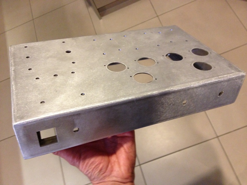

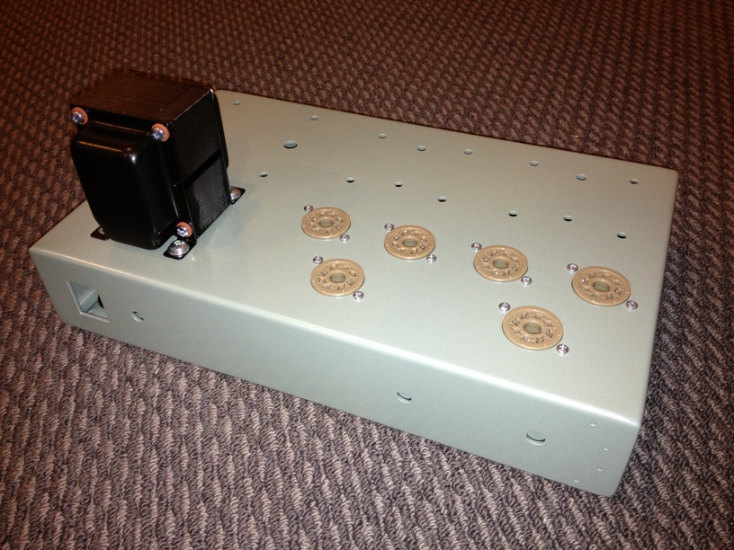

Just a quick report on progress....
I've designed the chassis in solid works and had it laser cut then folded and welded at a local shop. I've just got it back from the paint shop this afternoon and fitted a few parts to see what it's going to look like....
I've never tried to attach files before so I hope they show!

Thanks! The plan is to build the octal version as I've got a box full of 6v6s but I've also got a few 6f6's in the st shape that I'd like to use.
The first problem is that I was told to allow 80 to 100 microns for the paint thickness inside all the holes. The reality is that the paint thickness is mo like 200 microns inside the holes which makes a planned 5.2mm dia hole into a 4.8mm dia hole🙁
Drewaudio, to accomodate for the folds, did you have to add length to each side to allow it to be bent?
Hi Gokite,
The particular version of solid works was from the local metal shop and calibrated for their folding machine and press. All I did was draw the chassis with the finished dimensions (eg external height, length, width) and hole shape/locations based on a sheet of 2mm aluminium and the software 'allowed' for the bends etc.
I've attached a 3D pdf output from the software that you can spin around. You will see that I've also set the bottom cover in by 2mm too.
The solid works file was then sent to a laser cutter before coming back to the shop to be bent in the press and then hand welded.
The cost will be about $160USD for the box which is not too bad considering that freight to New Zealand is a killer for any imported chassis. At least I get exactly what I want in terms of size, shape etc and I get a chassis with a decent wall thickness and all the holes pre-cut. 😎
