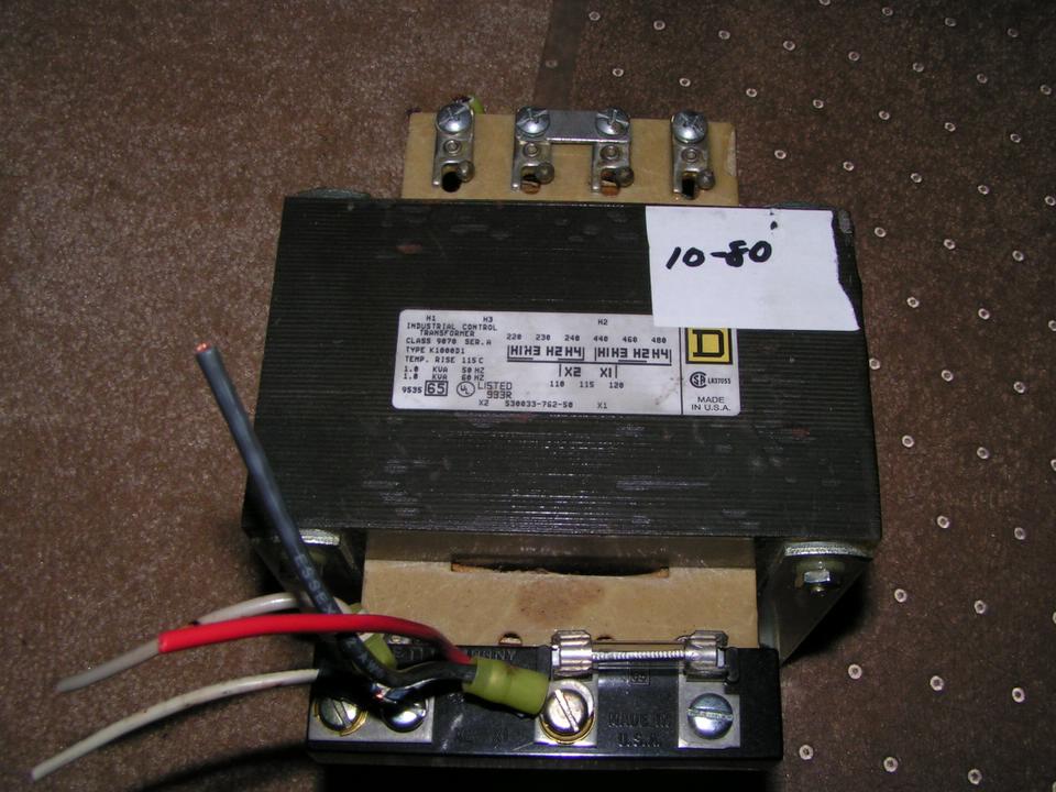

A 500VA 480VAC industrial transformer with 2 240V secondaries would easily meat your needs cheap. Tie the secondaries together for 480VCT. Then use a separate filament transformer.
Power Transformer(s)?
Tweeker - that's not a bad idea. 🙂 Why such a high VA rating though?
I'd better make sure I get this straight though - I tie the secondaries in series, and the point where I tie them together becomes the "0" in the 240-0-240 business?
I went conservative here and assumed stereo. 250VA would be fine for mono. I recommended a high VA rating here for a couple reasons. Transformer VA ratings assume steady AC loads. Capacitor input filters cause higher peak and RMS currents, and a full wave rectifier only uses half of the transformer at a time. Also, industrial transformers can be had dirt cheap. A thermister might be a good idea on the primary.
Yes, be sure to observe polarity or you might get 0VAC.
Pictured 1kVA 480VCT transformer already has the 2 240VAC secondaries tied together for 480VCT. The center tap is 0V. Cost almost as much to ship as to buy, I wish more people would use flat rate Priority Mail. I had a 40lb choke shipped from Pearl Harbor for $12 that way before.
