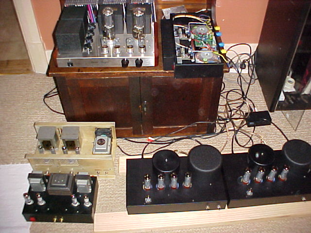

I looked for a picture of the prototype to post but all I could find was this one. The "Baby Huey" is the middle amp on the left.
The one in front of it is the ECL86 version from which it was derived. Others are 845SET (up the top), a pair of Parallel Push Pull EL34 Triode Mode Mono-blocks and a - shock horror - Solid State AKSA 55 Nivarna Plus (which holds it own with this lot reasonably well).
Ian
Ian
