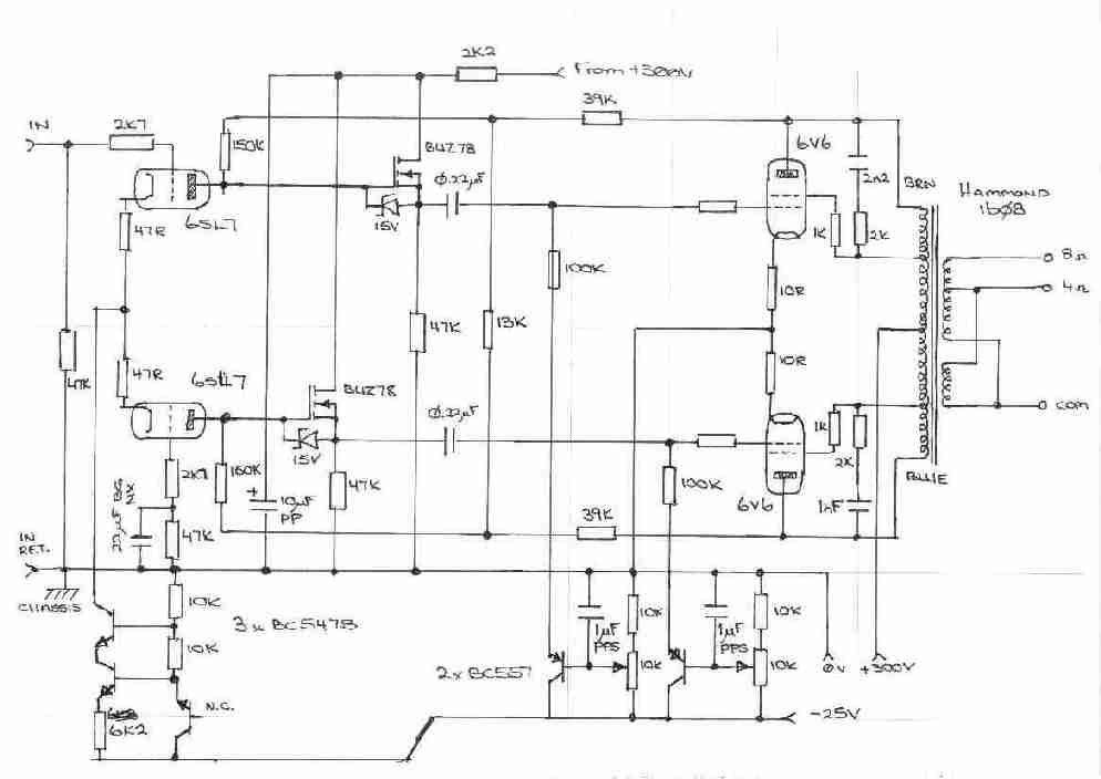

Fixed Bias 6V6 Variant
Here is the schematic.
I'm not 100% happy with the OT Zobels yet (these are just a bit too agressive) but it sounds better with them than without. I'm still struggling to come up with an absolute method for determining them.
Ian
Ian
Hi Ian,
Of course I like that variation !
But I've a doubt :
If an overdrive charges the link caps (likely to occur with the lo Z source followers) they have no way to discharge fast cos the emitter followers in the bias ckt do not allow current to flow that way
Add a NPN 😉
Yves.

Yves,
You are right. On overloaded positive peaks to the EL84 grid, the grid to cathode looks like a diode, so there will be current into the grid which will charge the coupling cap to a higher voltage. This will cause the gridd volts to shift to a larger -ve voltage (when overload removed) reverse biasing the emitter follower in the bias circuit. This will worsen blocking distortion after an overload. RATS!!!
I'll have to have a rethink about this.
Fix Options:
1) Add a resistor emitter to 0V of say 10K - this will increase bias supply current draw by only 2mA each side (4mA total).
2)I have some HP 5082-2385 Schottky Diodes with 310mV Forward voltage. Wire one of these across each emitter follower, diode cathode to the emitter and diode anode to the base. That will bleed the bias back to within 310mV.
3) Simply ditch the emitter follower altogether and wire the bottom of the 100K to the pot wiper. That would require the 1uF cap to be increased to at least 10uF and it becomes more difficult to get a decent sounding cap.
4) Replace the emitter follower withan opamp voltage follower, BUT if I'm going to go to that trouble I might as well make it a full bias servo.
I think I'll go for fix 1) for now.
Ian

I added the 10K from the bias transistor emitters to 0V - definitely improved overload recovery (test CD - Black Eyed Peas).
Anyone have advice on those 1K screen resistors on the 6V6?
Should I delete them, reduce their value, leave then as is????
Ian
