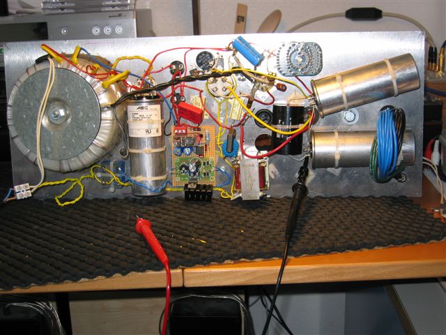

aetosa said:I don'y understand. Is it possible to build a circuit whithout a PCB?
How? With wires?
Forgive me for these naive questions, but I dont know many thing about amps with lamps.
Yeap !
Some do MUCH MORE clean job than me
Yves.
That looks like a nice construction to me. Small and neat; no unnecessary wires. The only comment I would make is that rotating all the transformers through 90 degrees would avoid the mains transformer squirting flux into the audio department.

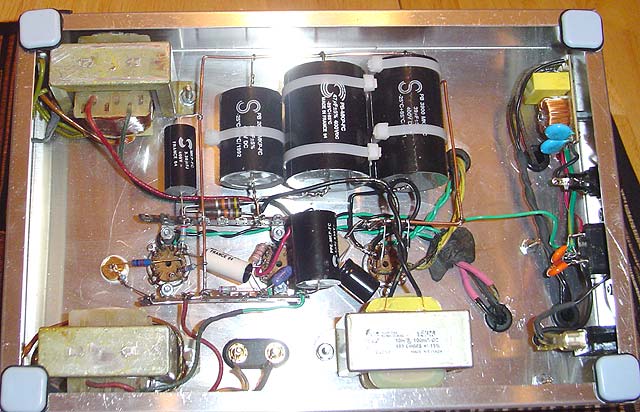

How? With wires?
Called point-to-point. This example is a couple transformers more complex than the simpliest 2 stage you can build... the power supply is more complicated than the audio part....
dave
those wires
come from the amplimo toroid OPT which is on top.
The amp is 2A3se with ecc40 beta follower (with current diode between top and bottom half) as a driver. design Martin Huber
