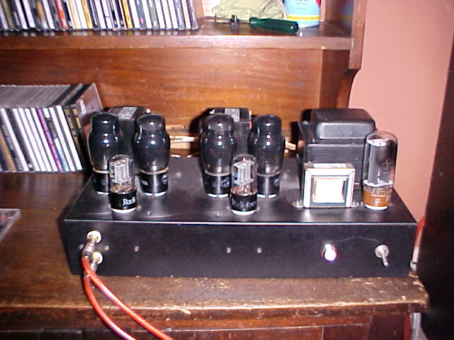

B-H Pix
Hi Chris,
If you email me I can send you some pix of my humble efforts. There's a couple of interior and several exterior that might help you with orientation. I'll try and annotate them.
There are some not-very-good ones on the thread already--Posts#251,263.
Let's know.
Cheers, Ken
Hi Chris,
Let's know.
Cheers, Ken
Ken -
How do you like those green K42's as couplers? I have a box of them that I intended to use for that duty but received a box of K40's shorly after. I ended up using the K40's and was so pleased, I never even tried the K42's. I'm curious if you've used enough varieties of coupling caps to form an opinion on the K42's and if so, would like to hear it.
Adam
Adam
