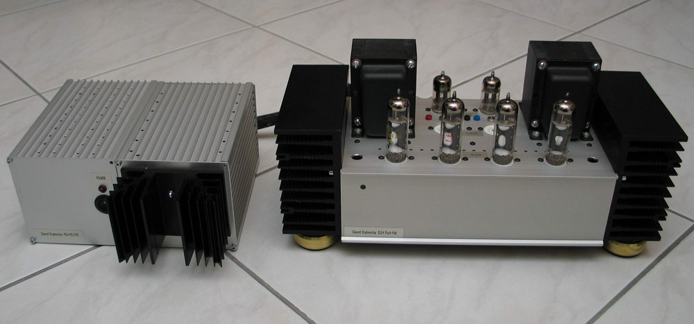

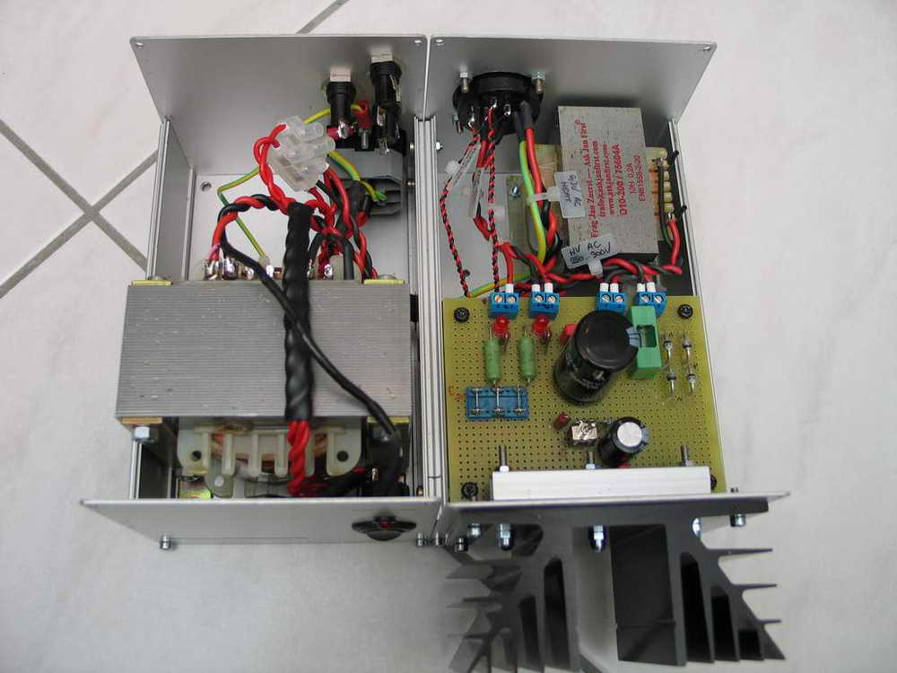

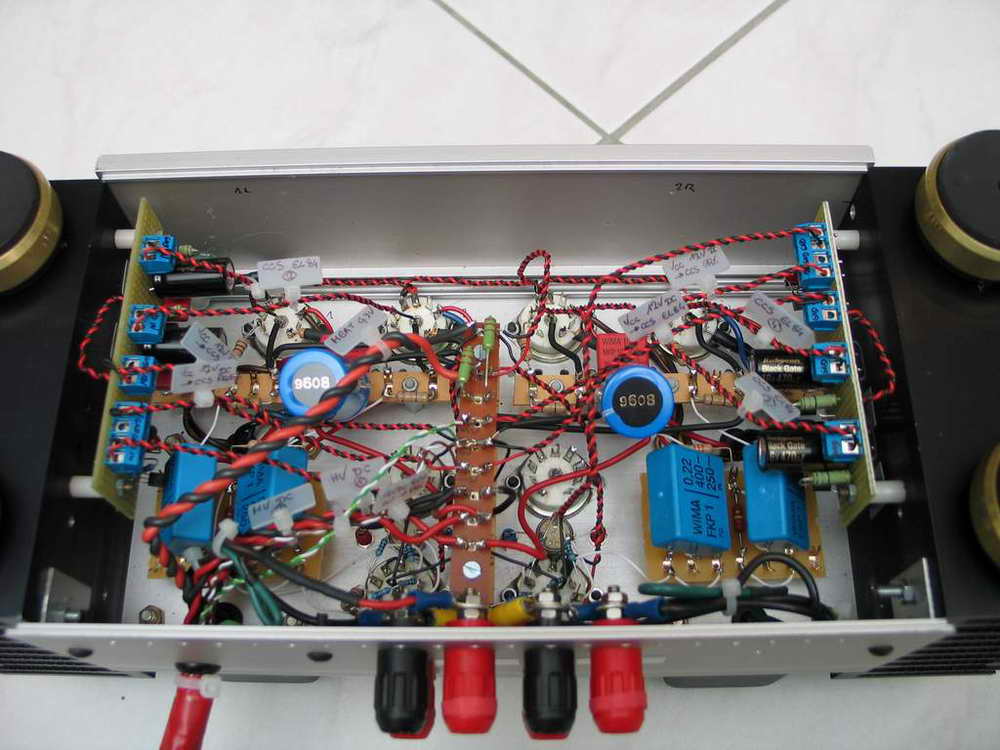

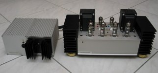

Hi Gingertube,
I'd like to give you a feedback about my build of the Baby Huey amp.
I converted my Eico HF86 clone with Hammond 1650E iron to your topology.
In my build there's no global feedback, the cross-connect resistor value is 16k, the cap on the EL84-CCS is 470uF.
I can confirm several of your remarks you made in this thread:
- It just sounds terrific (read: balanced, subtle, precise, not tubey, very enjoyable to listen to during hours)
- It has no preference for particular music styles, they all sound good on the Baby Huey.
- It's a hard competitor to my other amps(2A3 push-pull with Lundahl OPT and Lundahl interstage costing 4x more)
- It's nearly indifferent to speakers (it mastered very well my 92db 3-way speakers and did an excellent job on my Fostex FE-103s
and Fe-168s speakers, the Fostexes usually are a bit critical on amplifier damping)
- It sounds better than the sum of its parts should.
The Baby Huey amp adds very little coloration on its own. I found out during tube rolling that that it shows very
clearly the sonic signatures of different ECC83 and EL84 brands often described by people on the net. In my case an industrial
Philips 12AX7S and a vintage Tungsram EL84 sounded best. The russian military 6P14P-EB types was a bit harsh in comparison but had
a very tight bass. The old NOS tubes all performed better here than the current production ones I had on hand.
(I didn't test the Mullard EL84 reissue although I'm tempted to do so)
I modified the periphery of the amp a bit (see the attached schematic):
- A dedicated reference voltage was added to the EL84's CCS to eliminate the minimal fluctuations (2..3 mA)
during operation of the amp.
- The ECC83's CCS was modified to a Morgan Jones CCS with improved caracteristics.
- Those reference voltages are generated by two LM317's.
- The B+ high voltage rail is MOSFet regulated to 300V with minimal ripple for each channel.
The B+ MOSfet regulation brought a subtle improvement in the stereo-imaging.
As for my CCS modifications i can't tell, as i never built the original CCS.
One of the biggest improvements in sound was the replacement of the 470uF cathode caps by Blackgates (I hate to say it...).
The Blackgates sounded awful for the first ten hours (so much that I first suspected the B+ Mosfet regulation and disconnected it).
After the burn-in of the Blackgates the sound was back to normal and then went up to excellent.
My distortion measurements with a Hameg HM8027/HM8037 distortion meter indicated:
Distortion: 0.05% at 0.5Vpp Output on 8 Ohms resistor (connected to 8 ohm tap on Hammond 1650E)
0.15% at 4Vpp Output on 8 Ohms
0.46% at 8Vpp Output on 8 Ohms
Clipping came in at around 10Vpp output
The distortion figures were very sensitive to the ECC83 sections being well matched (the balance pot. setting on the ECC83's
cathodes wouldn't change the distortion figures).
The square wave response above 10kHz was not too nice on the Hammond 1650E (well we're without global feedback here), but i've seen
Hammond 1615's doing better on a very similar setup with 5902 subminiature pentodes. The 1650E seems to suffer for it's particular
winding scheme here.
As I think that this amp deserves a better iron, i ordered higher quality 8k-OPT's from my favorite german coil winder. So far they
didn't arrive, so I can't comment if the square wave response improves.
I'll attach some pictures of my amp with it's separate power supply. It's compact but a major PITA to work inside, i would
recommend using a larger chassis than I did. The heatsinks on the amp are much larger than they should be, but I had them on
hand and did like the optics.
To sum up: I was hooked on DHT-triodes, but a pentode amp done right made me rethink my convictions.
