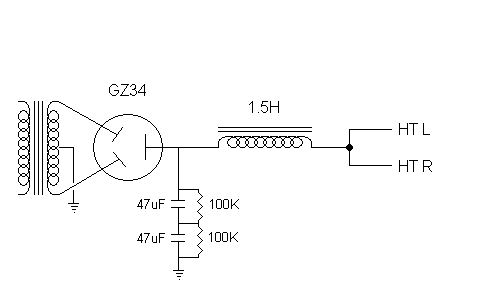

Problem: 450V at GZ34 pin 8.
It is built exactly as the Baby Huey schematitic dictates with the following notable changes/additions:
Hammond 372JX 300-0-300 PT 250mA rated - without resistors in AC leads, should offload about 360-370V at rectifier.
Separate 5V transformer: Hammond 166J5 1A rated
I've wired the transformer's primaries (no center tap) with the PT's primaries at the power switch.
http://www.hammondmfg.com/166.htm
Power supply is shown below.
Power at the wall is a steady 117VAC.
I really don't know how to take this one. It just doesn't seem...possible. I used the 372JX before, with a GZ34 and the shown power supply circuit. All was OK.
I've triple-checked this circuit both while building and after.
Any advice is appreciated.

I did some more testing.
With the GZ34 disconnected from the circuit, I'm reading 295V at pin 8.
I've tested the PT's secondaries and all check out.
No sound comes over either channel. No hum, no hiss.

I am definitely a newb, so don't take my advice as anything special, but shouldn't you be getting 0 volts at pin 8 with the GZ34 removed? If you are getting 295 volts you probably have made a wiring error. If it is 295 volts AC it looks like you have pin 8 connected to the high voltage secondary some how.
You did not mention, but are you using the separate 5 volt transformer for the driver CCS and the 5 volt 4amp tap off the 372JX for the filament of the GZ34?

What I meant is that I was reading 295V with the circuit disconnected from the GZ34.shouldn't you be getting 0 volts at pin 8 with the GZ34 removed?
I figured it out. As usual, I repeatedly overlooked something simple. I had connected all EL84 bias blocks to pin 1, not pin 3.
The amp is up and singing. I'm immediately impressed! I'll post my findings and some photos here later.
