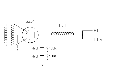

I'm starting to work with PSUD at the moment.
In my previous setup with the 372JX, I was getting 350V at pin 8 of the 5AR4 with only a 110mA load, so that figure should be manageably closer to the 320 mark under a 200mA load.
The "resistors on each phase of the AC" idea is an interesting one. Will that not affect AC integrity (not contradicting you here, I'm just curious).
"Derive the -ve rail from a SS diode from the 50V Tap on the HV Winding rather than using the 5V winding."
I appreciate your help and hate to be the dunce, but I'm not completely following you here. I'll look into it before I riddle you with more questions. There's also the option of buying a dedicated 5V@1A PT for around $10 if I wimp out.
Hi Adam,
Try to add a capacitor after the choke. 47uF should do it. Your 23 uF ish input capacitance is good. You won't damage the rectifier tube. You would be safe up to around 30 uF without looking at a data sheet. Possibly up to 40 uF as a design maximum. The tube data would give you the maximum capacitance allowed.
-Chris
-Chris
Thanks for chiming in, Anatech.
You recommended adding a cap after the choke. Would this be in addition to the 100uf cap that's already in line before the output stage?
Hi Adam,
-Chris
No, not if there is one there already. Normally, any filter caps are shown in the supply section and I forgot about the earlier posts and diagrams. I was going on your PS diagram alone when I made my comment.You recommended adding a cap after the choke. Would this be in addition to the 100uf cap that's already in line before the output stage?
