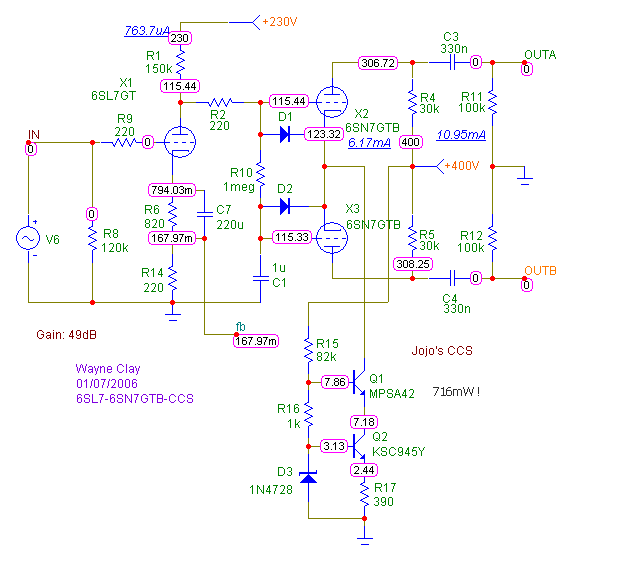

OK, now let's get anal. Here's JojoD818's CCS in the TAIL of the 6SN7 LTP I posted earlier. I did it quick and dirty using a MPSA42 HV transistor. As a safety margin we need one that can dissipate at least several watts, as we are statically dissipating 716mW.
This CCS can be built on a little PC board or perf board.
Wayne 🙂
Edit: I used a 3.3V zener because I didn't have a good red LED model, yet.

SY said:Agreed 100% on the balancing stuff. That's why I've given up, gone to the Dark Side, and use a solid state CCS in the cathode.
I will also "confess my sins" and mention that in a recent 2 x 100W tube amplifier (high-end), I used 28 transistors and 3 ICs, albeit all in power control and safety sensing circuitry. The 2 amplifiers themselves use only 13 tubes! There was no way I could have done this with all-tubes. I have perhaps my "dedication" to nostalgia more than many others younger than me, having been brought up in that era, but I am also a humble EE, and I will be hanged before I sacrifice integrity and be un-optimal as an engineer. We use modern metal-film resistors, polyester and poly-carbonate capacitors, ceramic trimpots, have our chasses cut with computer-aided laser tech etc, so. (Just a pity those NOS tubes are drying up ....)

cogsncogs said:OK, now let's get anal. Here's JojoD818's CCS in the TAIL of the 6SN7 LTP I posted earlier. I did it quick and dirty using a MPSA42 HV transistor. As a safety margin we need one that can dissipate at least several watts, as we are statically dissipating 716mW.
Wayne 🙂
hi,
i would be more confident with a tip50, mje13005, mje13007, etc to-220 types in there as they can dissipate more.

this makes a lot of sense to me! techniques learned with solid state amps can be apllied beneficially to tubes.
i am also looking at a diffferential amp to make biasing the output tubes easy just looking at led displays.
I like the idea of using LED's . They are much quieter than zeners and plus they will give you a visual indication that the circuit is 'fired up'. You can also use a series string of diodes in place of the LED's. I'm leaning towards using a CCS in my own driver stage mod/upgrade of my VAL VAA-70Mk II PP UL amp. By the time I get done it will not be the same amp! I have boxes of bagged up Bi-polar and JFET/MOSFET transistors I have collected over the years, so I might as well use them.
The pros, almost perfect AC balance and a much improved common mode rejection ratio. Plus you won't have to use tons of NFB to

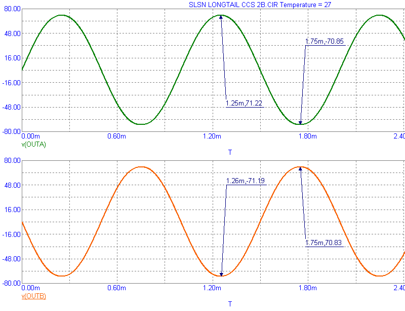

Transient Anylasis at the onset of clipping, more than enough drive for an EL34 PP pair:
Cheers
Wayne

btw, may i know the max output of the differential stage in pk 2 pk values prior to clipping?
Cheers
Wayne

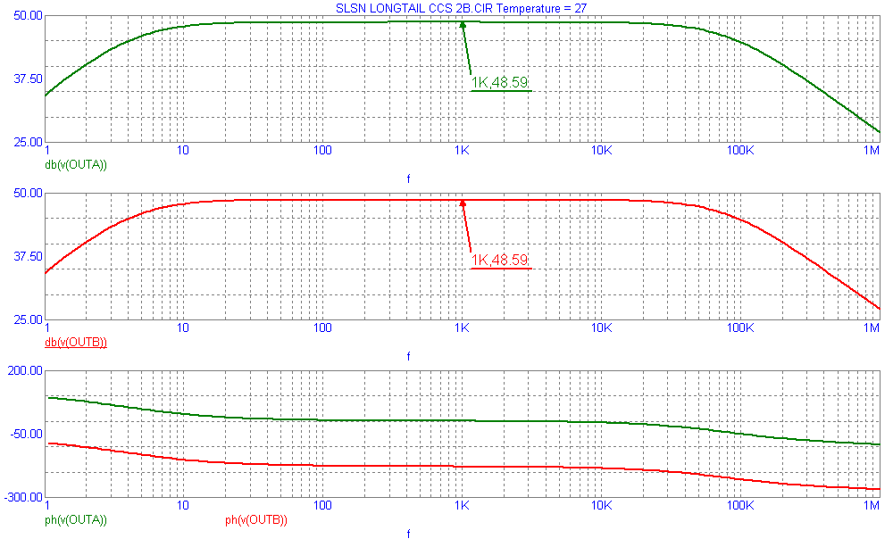

And here the AC analysis from 1Hz to 1MHz:
Wayne
Edit: using a lower value 6SL7 anode resistor will give a wider bandwidth. But remember to keep to anode voltage around 110-115V or so, which means either adjusting the cathode resistor or the supply voltage for the 6SL7.
