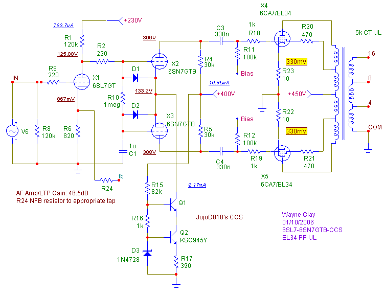

My measurements say that the AC balance between both halves of the 6SN7 is identical with the CCS. The band width is also a little wider. I'm I on the same page? Also are there any advantages using a negetive supply on the tail with a CCS?
My measurements indicate this also. And the bandwidth also. It's the 6SL7 that's throwing things off. A little 2nd harmonic. 😉

I don't understand why this designer took the trouble and complication to turn the first stage into an SRPP (a plain-vanilla grounded cathode stage works fine here)
And by going to triode, the stability is possibly compromised because of the new, nasty poles from the output stage's Miller effect.
Not to mention the extra toob. I never did like the sound of an SRPP, IMO of course. And absolutely not necessary. And by going with triode operation you need a driver feeding it with a low output impedance. Though ray_moth's circuit is a very good one, I would try to get rid of the extra stage if possible.

i noticed that gain is quoted as 48db, assuming a closed loop gain of 20db, so feedback is 28db.
are these values costumary for tube amps? i know ss amps have more open loop gain than 48db, so what if we lower that to say 36db, what are the consequenses if we do this?
About 39 - 40dB would be ideal. Less NFB would be needed to get around a 775mV input sensitivity (my preference) as you may run into stability problems and a compressed, lifeless sounding amplifier with high amounts of NFB. :dead:

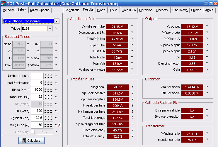

navin, here's an EL34 PP triode operation with 390V B+ I did in Tube Cad Journals PP Calculator. About 9 watts class A w/6000 ohm P-P load. I wouldn't go with much higher Iq=55mA, 21.5W plate diss per tube. With a 6600 ohm primary you could go with a little higher Iq but a little less total PW but a little more class A output.

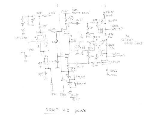

the extra stage in ray moth's ckt? I thought you cant get rid of ti thanks for feedback? Ray moth's ckt uses 1 6SL7 per channel your version uses 1/2. I am a bit confused as tto which ckt to use esp since I dont have any 6SL7 yet. I aim to get them though.
9W class A. That would mean 15-18W Class AB right. I was looking at a Iq of 40-50mA.
what about UL? How much power would I expect then? 30W Class AB at 5K?

If you noticed ray_moths circuit, NFB is taken from the plates of the EL34 and the OPT is out of the FB loop. This has some very clear advantages. Here's where good iron is needed and you don't need NFB to whip :whip: not so good iron :wchair: into shape! Ringing, what ringing?!! :Popworm: :wave: :worship: 😀

In ray_moth's circuit the extra stage is needed because of where the NFB is taken from. The pic/chart I posted is for PP-Triode operation. In PP-UL (pentode with plate signal i.e. 43%, injected into the screen grids) mode you will get around 30-40W depending on B+ and the OPT primary load. You could go as low as a 4.3k primary, about 30mA Iq per tube, 450V B+. But with a 4.3k primary/load the output power will be higher but the distortion will be a wee bit higher also.
With a 5k OPT, around 33mA Iq, 450V B+, fixed bias you should get 40W easy. A good quality EL34 will handle this (450V) in UL mode.

that would be R11,R12, increasing this to 270k will give somewhat higher gain, as for me, i would go with 100k first.
the 1/2 6sl7 is needed to achieve the 48db gain wayne feels is needed for an input sensitivity of 775mV after feedback.

I guess I did was not clear about the 6SL7....
Wayne's ckt uses 1/2 6SL7 while the schematic JoJoD818 posted uses 1 6SL7. What does JojoD818's ckt gain by this extra triode (1/2 6SL7)?
