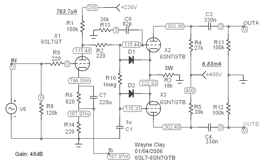

OK navin, as promised here's a 6SL7 going into a 6SN7 LTP. Now this model for the 6SL7 doesn't model grid current. I would keep the 150k or 120k anode resistor and adjust the cathode bias resistor(s) and/or the plate supply voltage to get around 110-115V on the plate of the 6SL7. R13 (36k) and C6 (82p) form a RC phase lag HF compensation network. This may or may not be needed in your amplifier. This network can also be placed in // with the 150k plate resistor. Also the values of the grid stoppers are not set in stone and may not be needed at all. This will be determined by your OPT and layout. So when you begin to build your amp(s) you will have to tweek these values and not to mention your NFB loop. This is how it's done.
Now if we had the same OPT's (if we were building the same amp) and other components I could give you the values and all would be well. And plus you are having your iron custom wound/made. I hope you have a scope, you may very well need one. Also hopefully when you recieve your OPT's they are closely matched
I don't find this tweeking or fudging a problem, it adds to the fun of building your own amplifier!! 😀
R4 (27k) and R5 (30k) should be 2W types. All others 1 watt except the 18k tail resistor which is a 3 watt. I wouldn't use an inductive WW 18k tail resistor. I've found the metal oxide resistors work great. You could use 1% metal films for the 6SL7 and the 100k grid leaks. This is important for the grid leaks for the output stage as you want them well matched. You may already know this but I'm also writing this for others who kmay be watching this thread and are hiding in the shadows

cogsncogs said:oopps forgot the diagram, here it is!
Geez. Wayne. I am soooo obliged. If I were in your boat I dont think I would have been able to conjure this. Spend time with your mom. Tube amps can wait.
Just a brief practical observation re Wayne's circuit (post #206) - not trying to be judgmental:
This is (almost) the same circuit I became fond of over the years, but I sadly found myself beleaguered by tube tolerances. Even halves of the same double triode were sometimes so different that I had to install a small trimpot between the anode loads of 27K and 30K to get balance in the output stage. About 5K, and I am sure it could just be added without making too much of shift in anode voltages (or just a 5K + 27K in the lower limb). Or if the amplifier will remain your own, perhaps more elegant to check each time you replace a 6SN7 and adjust the load resistors. But be sensitive to the possible unbalance.

Johan Potgieter said:..Even halves of the same double triode were sometimes so different that I had to install a small trimpot between the anode loads of 27K and 30K to get balance in the output stage. About 5K, and I am sure it could just be added without making too much of shift in anode voltages (or just a 5K + 27K in the lower limb).
can this be done without use a pot in the signal path?
Sure, make both plate resistors the higher value, then use a large parallel resistor to trim the gridfed side. The fiddling will be tedious if you want to adjust things (this is at high voltage, so patience or creativity will be needed to change trim resistors safely), but it can be done.
Again, a cathode current source is simple, cheap, works well, and automatically balances that stage...
SY said:Again, a cathode current source is simple, cheap, works well, and automatically balances that stage...
"simple and works well" magic words. How does one implement this on the ckt in post 206. does one have to have some sort of SS curent mirror ckt where R3 18k is?
yes a ccs with 6.83mA, a tip50 transistor can be used here.
What happens to R4 and R5 then. Are they both 27K or are they 27 and 30K.
yes, same value. which value, your pick.

we already have a solution for that, don't you remember? the ckt came from SY and I posted a redrawn version already. 😉
with the ccs, we use the same 33k resistor for the upper and lower limbs of the phase inverter.
