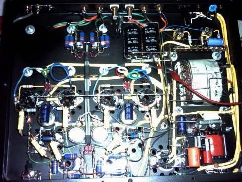

navin look,
ricken resistors, vishay (hiding underneath) illinois caps, solen caps, sprague orange drops, bournes switches and pots, made to order 2mm aluminuim chassis.
all bought locally navin.
JojoD818 said:navin look,
beautiful. now you got me jealous. is that the EL34 amp?
thanks!
this isn't the one we are talking about here but it sure is a new one. 😀 when I finish my work on this amp then my next project will be the EICO hf87 in fixed bias and CCS. 😎
JojoD818 said:...when I finish my work on this amp then my next project will be the EICO hf87 in fixed bias and CCS.
And while you do that I will collect parts as per your schematic. Only difference is that you are using teh 7025 and I am using the 6SL7.
BTW how many EL34 amps are you building? The one in the photo + the HIF87 (modfied) + ???

I'm already in the process of collecting parts too for the amp. 😀 Just got some old caps from a friend's amp (he upgraded) that I can reuse (saves me money).
The one in the photo is in the works, planning to build next is the modded HF87, and maybe midyear a ul pp 6bq5 for my wife.
