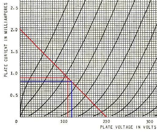

cogsncogs said:may need to alter the cathode or anode resistors to get somewhere around 110-120V on the plate of the 6SL7.
maybe i can use a 1K, 100K pots on the cathode and anode respectively and adjut till i get 110V on the plate of the 6SL7 right?
jane said:With Ra=100k and B+=200V, you will have 110V on the plate with a 1.38k cathode resistor (red curve) and 120V on the plate with a 1.74k cathode resistor (blue curve).
The resistors should of course be:
Plate 110V: R=Ug/Ia = 1.1V/0.9mA = 1.2k
Plate 120V: R=Ug/Ia = 1.25V/0.8mA = 1.6k
Sorry for my miscalculations in the first place
I see jane whipped out the plate curves! Sorry I was too lazy to do it myself.
Sorry for my miscalculations in the first place![]()
Thanks Jane. I think 1.5K is a standard resistor and given the 5% tolerance we can find 1.6K. BTW should I use metal film or carbon? Any advantage to using metal film?
