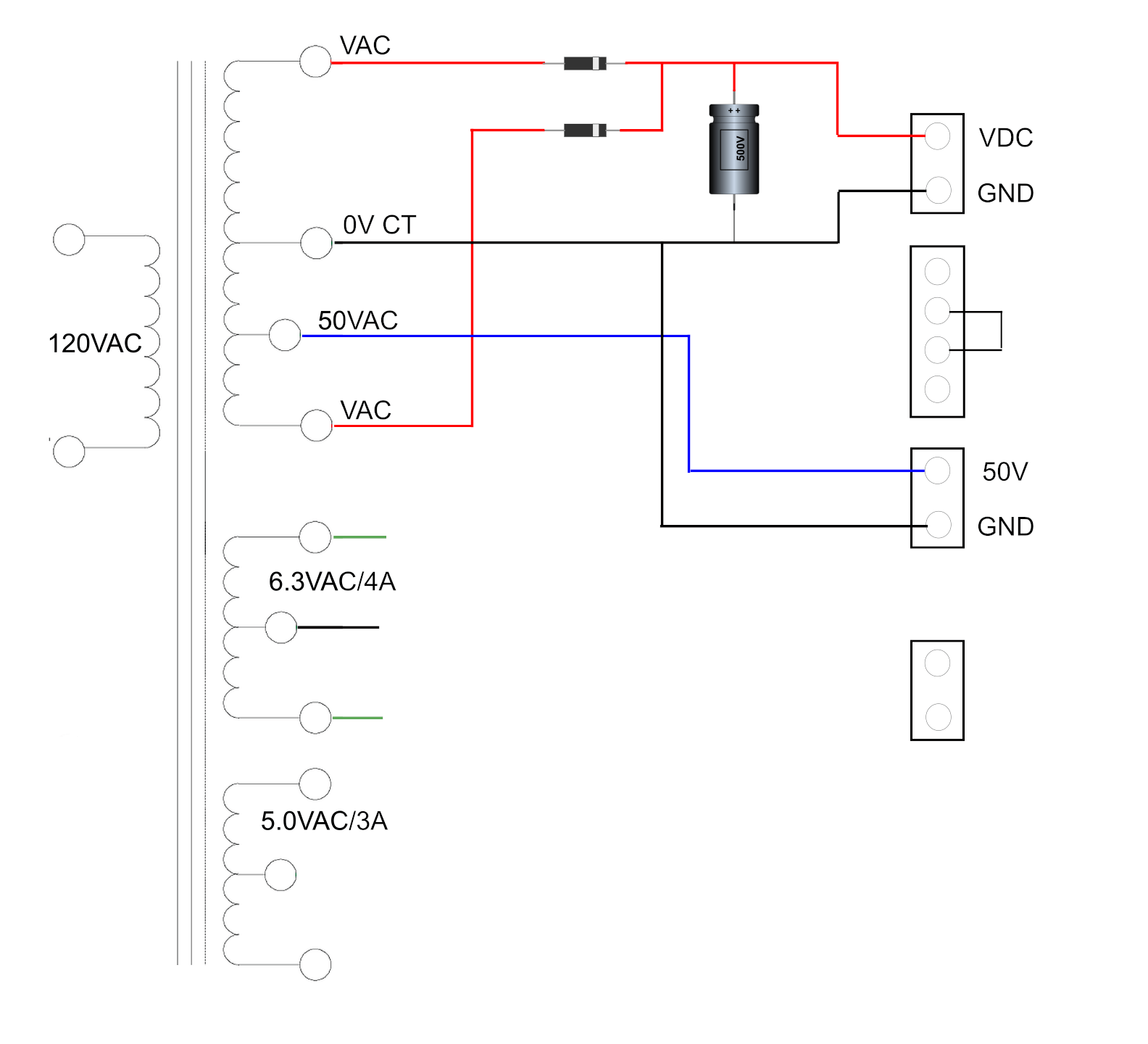

As I make up my mind, can someone help with using a CT EI transformer instead of the toroidy. I'm assuming a fullwave offboard rectifier for the HV. Not usre on the cap value, but a 600VCT transformer should be oK for a monoblock I'd think. I'm thinking that will put out about 400V into the PS PCB. What I'm not sure about are the 6.3V connections.

It depends on what you want to do and what CT EI transformers you are considering. Are you thinking of using the PS PCBs from Prasi’s GB?As I make up my mind, can someone help with using a CT EI transformer instead of the toroidy.
If so, the requirements for the BHEL34 PCB (Mk2) are shown in the wiring diagram. It will complicate things a bit if you don’t use the specified Toroidy power transformer although alternatives could be worked out with additional transformers, etc.
B+ from a 600 VCT EI transformer should be OK, but BH requires -100Vdc AND +15 Vdc for bias. The PS board also needs 12vdc for the delay relay. As shown, Marc anticipated the use of a DC/DC converter to take the 15Vdc ( rectified 6.3-0-6.3 (at 7 amps) of the Toroidy PT) to the required 6.3 Vdc for heating. Several builders reported that they experienced no issues or hum with AC heaters.
Bottom line is that IMHO you will pay more for CT EI power transformers to meet all the requirement than to buy the Toroidy’s. But perhaps you have those EIs waiting in you parts box.
So essentially you could use a 600VCT@200mA with a 50V tap and 6.3V/2-3A. You'd have to add another transformer for the the other 6.3 V? Something like the Antek AS-1206 (6V@8.3A x 2) or any other 100VA dual 6.3V secondary transformer?

That should do it with the PS PCB, and DC/DC converter if you want to do DC heaters.
Thanks. I'm sure I'll go with the Toroidy transformers, but it's nice to have options and a plan to implement them. I really appreciate all your help with everything!That should do it with the PS PCB, and DC/DC converter if you want to do DC heaters.
